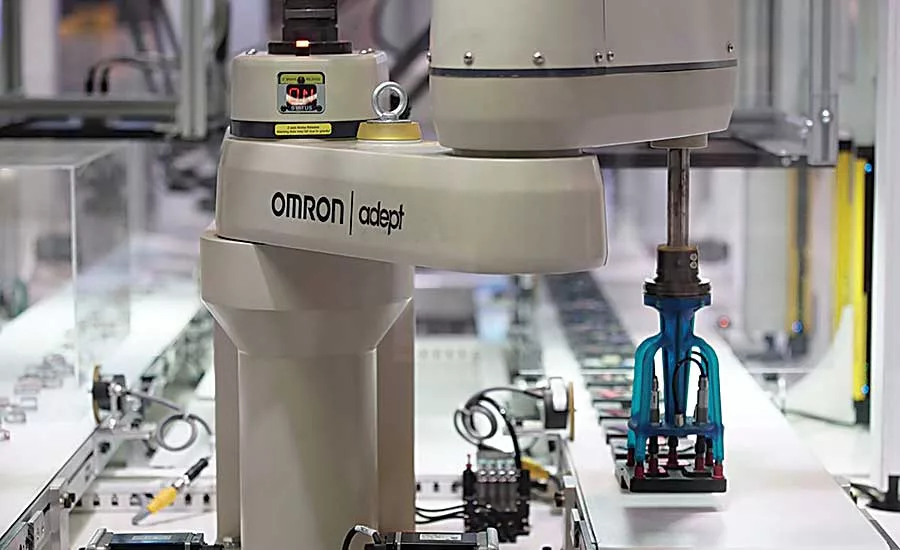

Robots are great tools for automating manual processes. However, engineers may not always have the knowledge or the time to deploy them successfully. Photo courtesy Omron Corp.

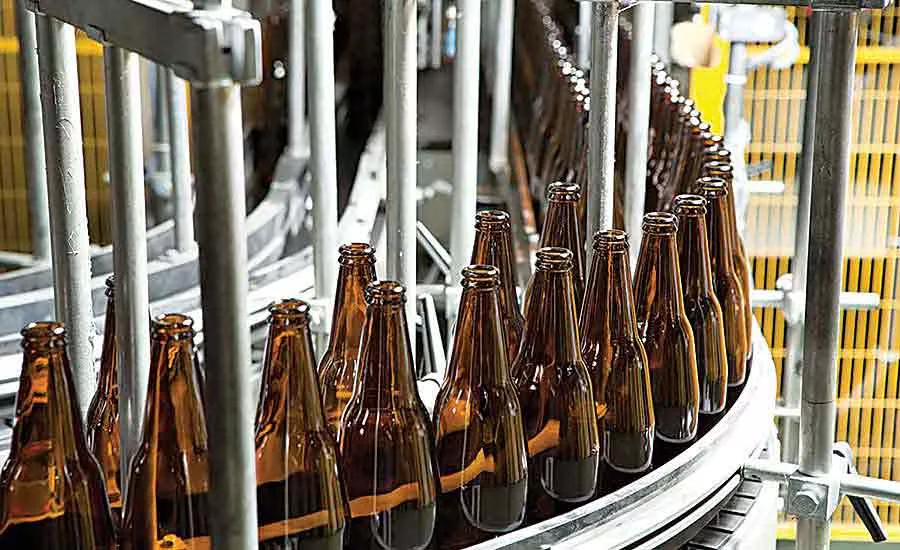

Some manual processes, such as filling and handling bottles, have been automated for years and are relatively simple to automate. Other processes, such as pushing surgical tubing onto a barbed fitting, are much more difficult to automate. Photo courtesy Valin Corp.

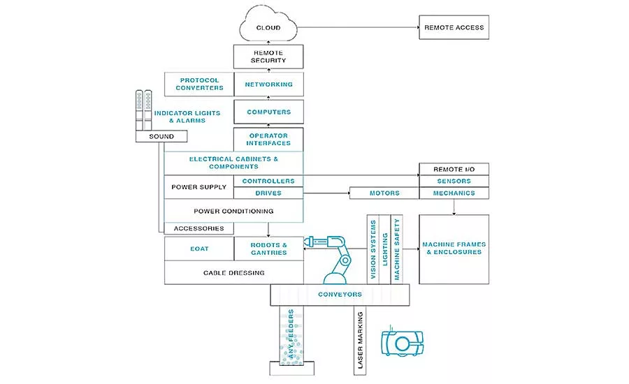

A variety of components are needed to automate a manual process. Illustration courtesy Valin Corp.

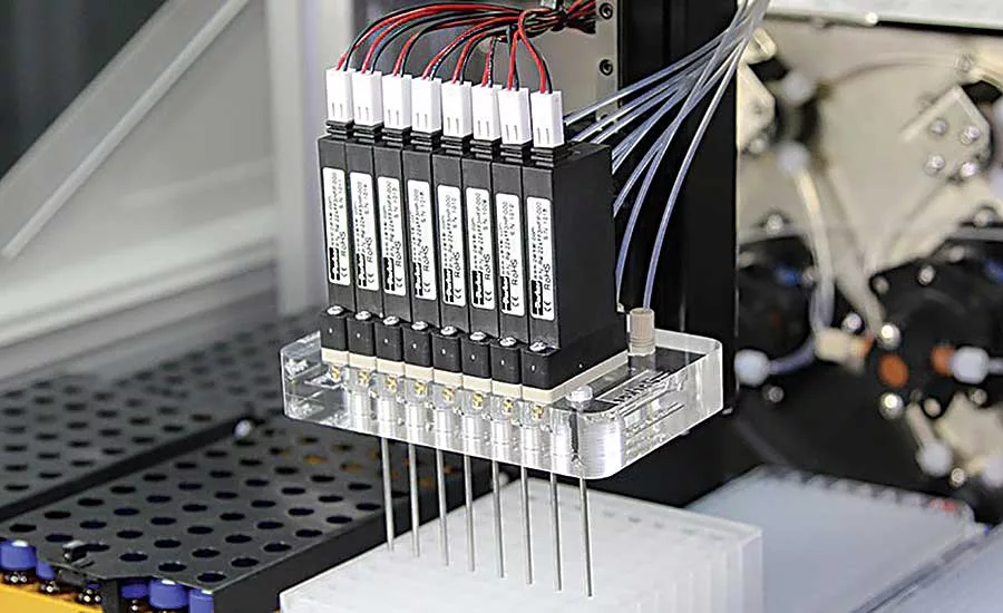

Even simple assembly processes, such as dispensing, can be more complex to automate than at first glance. Photo courtesy Parker- Hannifin Corp.

As a result, we begin the automation process by trying to understand the needs of the customer. Sometimes, this can be accomplished with standalone components that the manufacturing engineers can implement themselves. In complicated processes, outsourcing to automation suppliers to design and build a turnkey system may be more realistic. In still other cases, there could be some middle ground between these two paths.

Automating manual processes can be extremely difficult. Processes such as putting bottles in a box or screwing bolts into two parts have been automated for years, and these are relatively simple.

When a company is looking to internally automate a process, a good recommendation is to acquire automation components that allow them to experiment with the process. This can lead to a deeper understanding of the application and some greater knowledge of the variables involved.
The most common components for automating manual applications will be motion control products, such as actuators, sensors and robots. “Fail fast” is a mantra to focus on. Test the biggest variables with the most risk and fail at those processes first. Failure is much less of an issue if the error happens earlier in the process than later on down the road.
