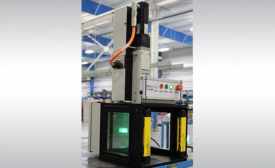

“Low force is such a subjective term in pressing,” notes Glenn Nausley, president of Promess Inc., which has made presses since 1984. “For example, a low-force pneumatic press can be one that produces at least 3 kilonewtons (about 675 pounds) of force, whereas a low-force arbor press may produce as little as 0.4 kilonewton (about 100 pounds) of force. Servo presses can go even lower.”
As an example, Nausley points to the Promess FlexIQ series, which consists of three models having a force range of 0.2 kilonewton (45 pounds), 1 kilonewton (225) and 3 kilonewtons, respectively. Introduced only this past June, the compact presses offer high precision and can be equipped with safety features and built-in monitoring. Their simple software allows quick setup so manufacturers can press parts within an hour of unboxing any of the machines.
“We developed the presses to better serve the needs of our electronics, medical-device and consumer-goods customers that perform high-mix, low-volume manufacturing,” says Nausley. “They are specifically designed to not damage any part, even tiny ones.”

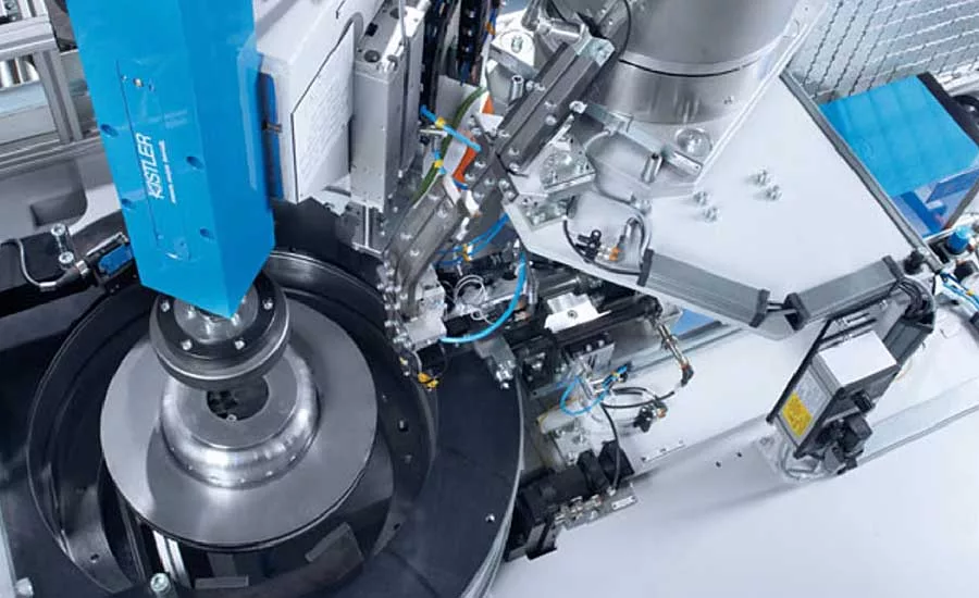

Low-force presses from Kistler Instrument Corp. are regularly used by companies in the medical, consumer electronics and automotive industries, as well as those that make jewelry and electric power tools. The latter use low-force pressing to assemble small motors.
Medical applications include injector pins and inhaler components. As for automotive, both Tier 1s and OEMs rely on low-force pressing to build radar systems and door-handle computer chips, and to spring-test buttons used inside a vehicle.
Kistler is headquartered in Switzerland, so it’s not surprising that multiple watchmaking companies there have used the Kistler NCFT joining module Type 2157B for several years. Kyle Fischer, sales engineer for joining systems business and advanced manufacturing at Kistler, says watchmakers use the press to precisely install various tiny components.
The 2157B features an integrated piezoelectric sensor for high-precision measurement within two predefined ranges: 0.05 to 0.5 kilonewton, and 0.25 to 1.5 kilonewtons. Fischer says the sensor is located in the head of the ram to ensure the most accurate force measurement. This data is then wirelessly transmitted to an amplifier on the press housing.
The press is capable of high-velocity operation with short cycle times. It is also ISO certified for Class 7 and 8 clean room work.

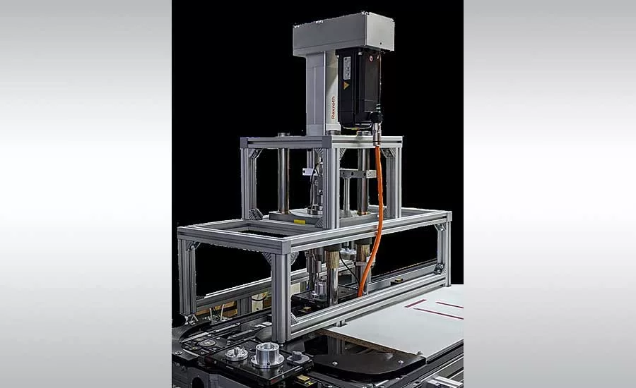

Last March, Bosch Rexroth introduced its Smart Function Kit to help manufacturers and system integrators implement servo presses for low- (2 to 5 kilonewtons), medium- (6 to 17) and high-force (18 to 30) applications. LinSelect linear motion software helps engineers select and size the correct kit for an application.
“This kit improves productivity for a wide range of applications,” explains Vaughn. “These include press-fitting bearings in housings, crimping cables and hoses, bending and embossing plastic parts, and performing various measurement and test procedures.”
After the end-user selects the correct-size components, he downloads CAD files for each component and designs the system with an online configurator. This desired configuration is then ordered via the Bosch e-shop, with all components being delivered as one complete package.
“The kit’s intuitive configuration capability eliminates the need for any end-user to have programming knowledge,” notes Vaughn. “Preinstalled operating software enables automatic parameterization of the servo drive and fast commissioning. This cuts engineering time by up to 95 percent and can significantly reduce time to market.”
By using the Smart Function Kit, sensor and electronic-controls manufacturer Sensata Technologies Inc. is able to produce small batches of various types of sensors on one assembly line, rather than several. The kit also lets the company record process data and autonomously configure production modules for quick commissioning.
Vaughn says the kit’s visual programming eliminates the need for engineers to do line-by-line coding. Instead, they select predefined software blocks and create a sequential workflow via drag and drop. When defining individual joining processes, the engineers simply enter the associate parameters.
“For monitoring purposes, status information and process results, including a force displacement curve, are shown and recorded live,” says Marc Hubsch, engineering manager in the encoders division at Sensata. “All data is transferred straight to our IT system, where it is stored and analyzed for quality assurance purposes. This means much greater transparency during production.”
