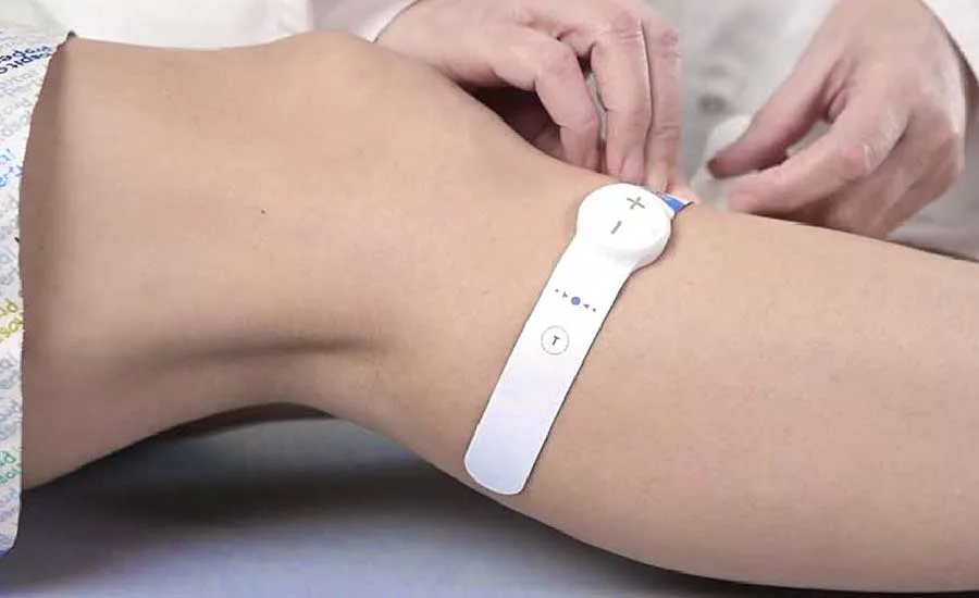

A wearable device, the geko features embedded technology that stimulates muscles and nerves to help improve flexibility, strength and movement. Photo courtesy Firstkind Ltd.

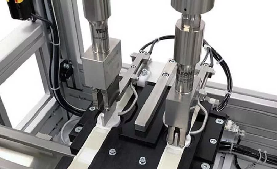

On the assembly line, Firstkind uses a dual-head ultrasonic welding station made by Telsonic UK to manufacture the geko devices. Photo courtesy Telsonic UK

Geko features an embedded neuromuscular electrical stimulation On-Pulse technology platform that stimulates muscles and nerves to help improve flexibility, strength and movement. The device is noninvasive, battery powered, disposable and similar in size to a small wristwatch. Once attached to a patient’s leg, it sends out electrical impluses that reduce the risk of venous thromoembolism, a dangerous blood clot condition suffered by almost one third of seriously ill COVID-19 patients.
On the assembly line, Firstkind uses a dual-head ultrasonic welding station made by Telsonic UK to manufacture the geko devices. The station is fully integrated with pallet automation equipment that is built in-house.
Each head assembly consists of a MAG3512S generator; a precision-adjustable SE3512VF converter module; and a titanium booster mounted to a Telsonic AC450 pneumatic actuator with a titanium single-body sonotrode. The module is also air cooled and spring loaded.
Geko components are made of polypropylene and presented on twin cavity pallets to the twin welding heads. Once activated, the heads simultaneously deliver a controlled staking action so four hollow pins flow into molded recesses at a low force. Weld and hold time are precisely determined by the station’s main PLC.
The welding process joins the front and back of each device, thereby enclosing the internal assembly and sealing the battery in place. To effectively perform this type of welding, Firstkind engineers designed a special pin-and-recess part mold that exactly matches the sonotrode tool face. Little force is needed to stake the assembly.
The manufacturer likes that the ultrasonic welding station produces aesthetically pleasing parts with a tight closure gap. In addition, to ensure patient comfort, the welds are constrained sub-flush within the part recesses. The welds are also strong enough to keep the device tamperproof, while allowing for battery removal via disassembly prior to device recycling.
