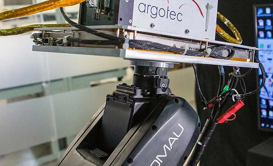

In the ATENA system, a nanosatellite is fastened to the wrist of a Racer7 1.4 Comau robot and moved to mimic the satellite in orbit. Photo courtesy Comau

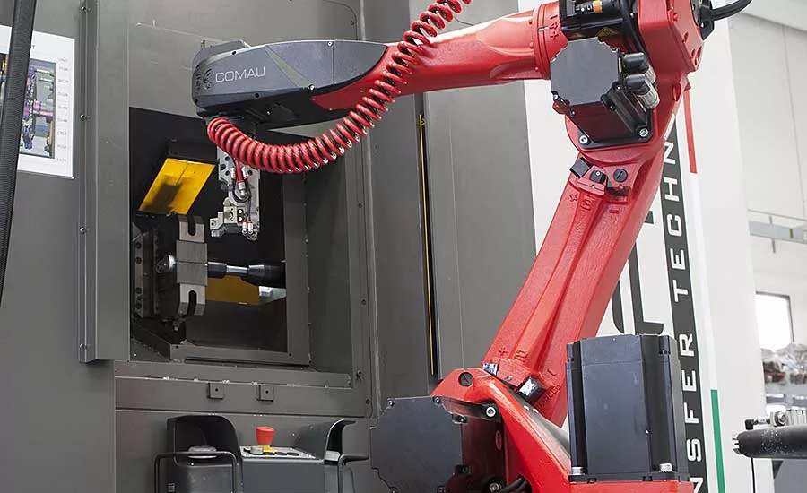

The six-axis Racer7 1.4 robot is often used in assembly and machine tending applications. Photo courtesy Comau

A closed-loop system, ATENA consists of a nanosatellite (or part of it), an electronic control unit and a six-axis Racer7 1.4 Comau robot, according to David Avino, managing director at Argotec. After an engineer mounts the nanosatellite to the wrist of the robot, it recreates the movement of the satellite in orbit throughout a mission.
During this movement, all communication system protocols on the satellite are tested, along with the interaction between the system components. The system provides simple visualization and quicker test results, as well as the capability to perform mission-related demos. For example, two or more robots can reproduce in-orbit satellite docking of the nanosatellite.
Avino likes that ATENA allows engineers to monitor the satellite’s functionality and directly observe its behavior. He notes that the system’s realism and versatility enable it to be used at any stage of nanosatellite design and testing.

Quick and precise, the Racer 7-1.4 robot has a 7-kilogram payload and a 1,436-millimeter reach. Repeatability is 0.05 millimeter, and the robot weighs 180 kilograms. It has a compact footprint and can be floor, ceiling or slope (45 degrees maximum) mounted. Besides testing, the robot is used in assembly, machine tending, packaging, polishing, deburring and arc welding applications.
