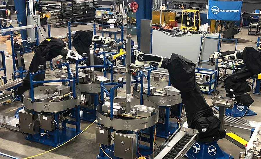

A robot carefully slides a warhead into a canister. A second robot (left) waits to install a lid. Photo courtesy CRG Automation

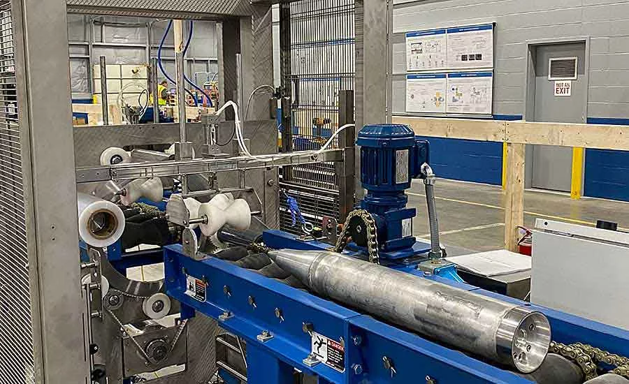

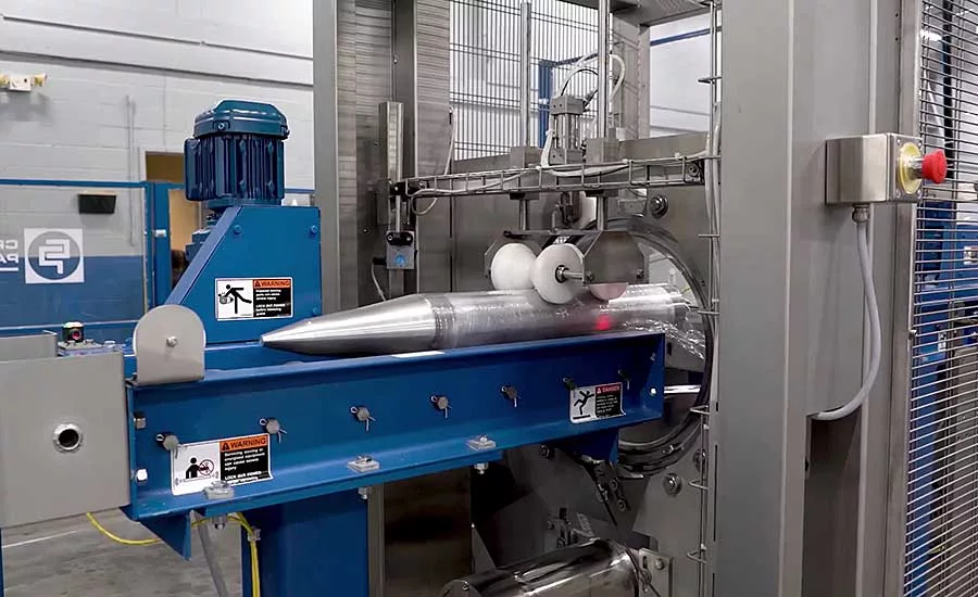

CRG engineers devised a process to scan each rocket—while it is moving—to detect leaks. Photo courtesy CRG Automation

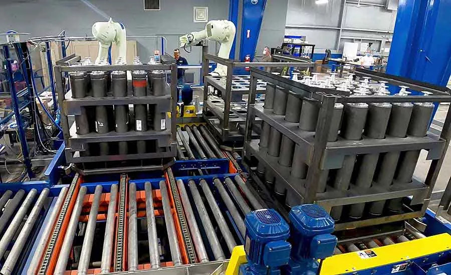

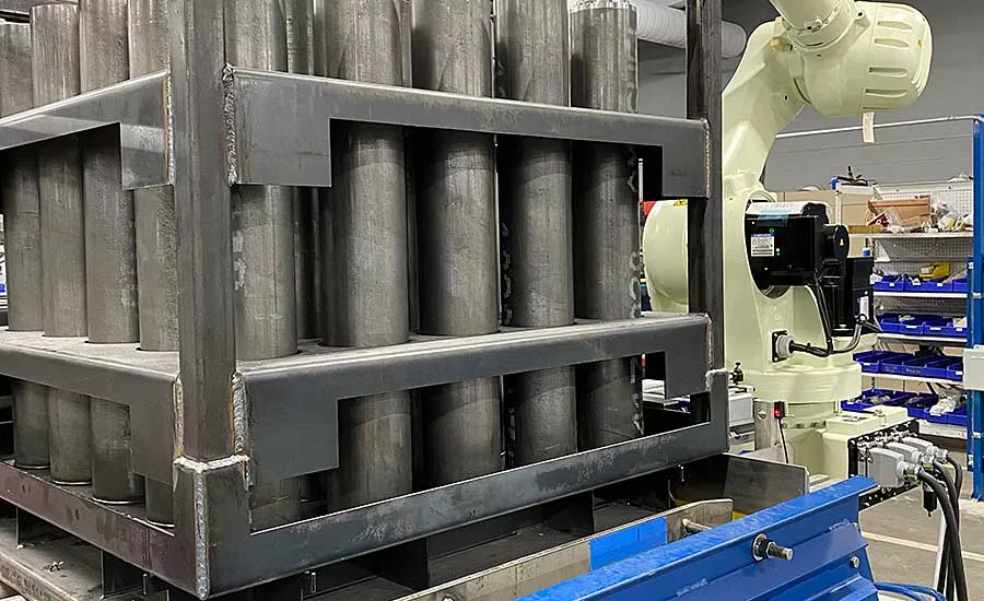

Once the lid has been crimped into place, a robot places the container onto a skid. Each skid can hold 25 containers. Photo courtesy CRG Automation

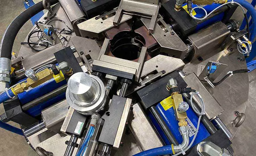

Four hydropneumatic cylinders are used to crimp a lid onto a steel container holding the warhead. Photo courtesy CRG Automation

Loaded skids are monitored in an airlock to ensure that there is no surface contamination. Then, the skid is transferred to a static detonation chamber, in which intense heat greater than 1,000 F destroys the warheads and the containers holding them. Photo courtesy CRG Automation

CRG’s automated warhead containerization system takes over the disposal process after the warhead has been separated from the rocket motor and the nerve agent has been drained off. A heavy-duty six-axis robot places the empty warhead into a steel canister that was custom-designed and manufactured by CRG. A second six-axis robot then places a lid onto the canister. Next, a custom-built crimping system, equipped with four 30-ton hydropneumatic presses, crimp the lid in place, creating a tight seal.
Next, a label is attached to the canister, and a robot loads it onto a custom-built crate that can hold 25 canisters. Each crate is then monitored in an airlock to ensure that there is no nerve agent outside of the canisters. Finally, the canisters are moved to the next step in the process—a static detonation chamber in which intense heat greater than 1,000 F destroys the warhead and the canister.

In designing the system, CRG Automation’s engineers use eight six-axis robots, as well as six autonomous mobile robots. The system can process more than 25 warheads per hour, improving speed and efficiency and reducing downtime.
The group continuously focused on how to improve each aspect of the process. Initial tests found that the system needed even higher temperatures to create enough heat inside the warhead’s fuse to activate the deflagration process.
A series of weekend text messages between DeSmet and Bobby Phillips, a chemist and engineer for PEO ACWA, resulted in a solution they affectionately dubbed “the witch’s hat.” The pair figured out a way to modify the plug and nose end of the munitions to allow for more efficient heat transfer to the fuse area of the warhead.
“That led to a significant increase in how fast it worked,” says Phillips, noting the activation time dropped significantly to just 15 minutes. “That’s right where we wanted it to be.”

The team devised a process to scan each rocket while it was moving and focus on the areas where there’s most likely to be leakage. The system also allows technicians to gain a closer look at those rockets that suggest they may have leaks but do not offer complete certainty. CRG Automation’s engineers crafted the ability to tilt each rocket up to 10 degrees for a better look.
