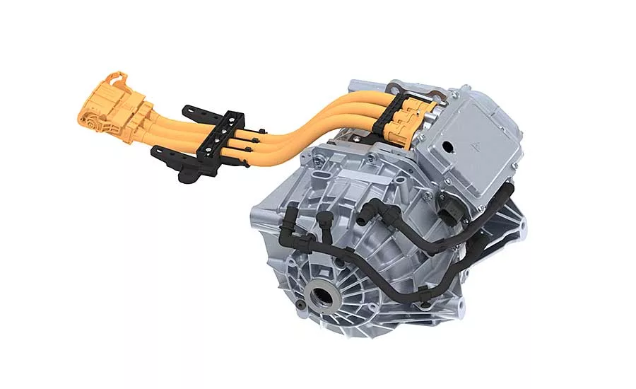

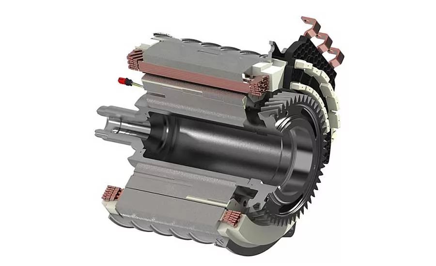

This two-in-one electric axle combines the reduction gear and electric motor in a single compact unit. Photo courtesy Schaeffler Group

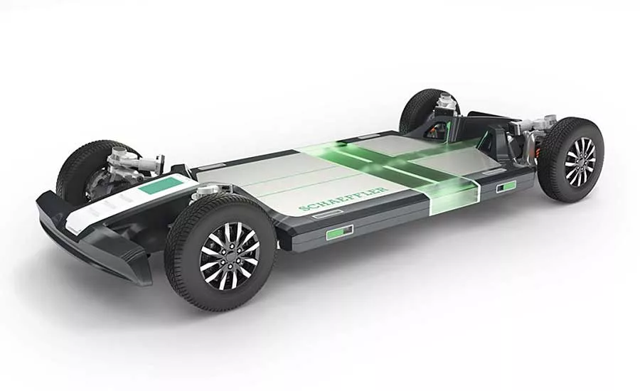

This modular rolling chassis serves as a flexible platform for self-driving shuttles and other autonomous vehicle applications. Photo courtesy Schaeffler Group

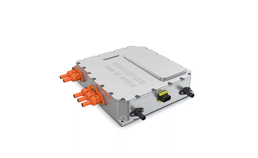

This 800-volt power electronics system increases the range of electric vehicles. Photo courtesy Schaeffler Group

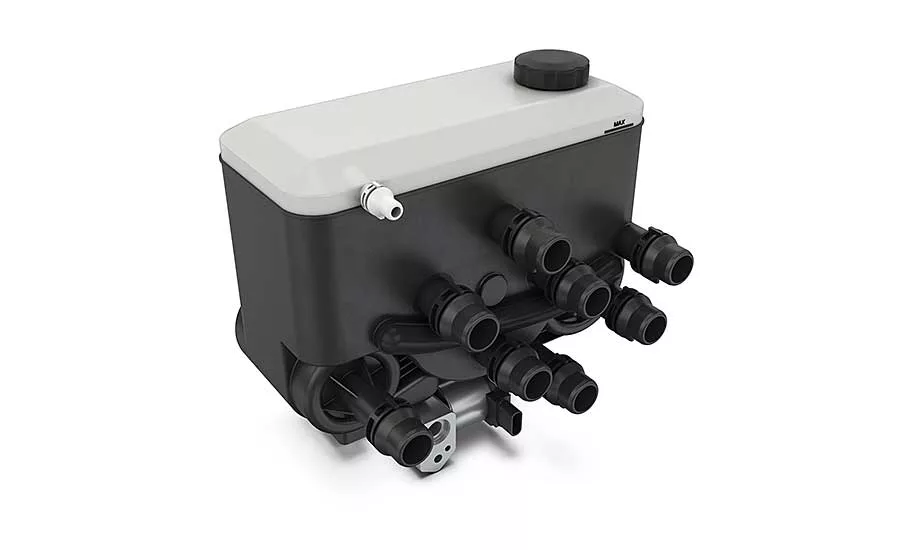

This integrated thermal management system reduces required installation space by 60 percent. Photo courtesy Schaeffler Group

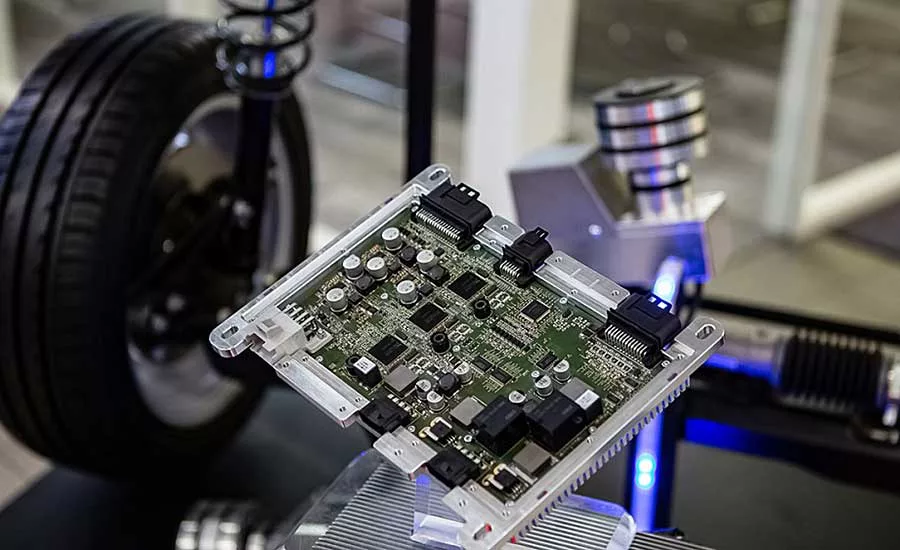

The Space Drive steer-by-wire system enables autonomous driving. Photo courtesy Schaeffler Group

Schaeffler recently received some prestigious recognition for its EV prowess. In Germany, it garnered the Golden Steering Wheel award for a two-in-one electric axle system. It features a reduction gear and an electric motor in a single compact unit that offers extremely high power density and exceptional acoustic performance.

In addition, the company has developed a modular rolling chassis designed to serve as a flexible platform for self-driving shuttles and other autonomous vehicles. A wide variety of options can be implemented, depending on customer requirements. For instance, corner modules, which each allow a steering angle of up to 90 degrees, include wheel hub motors, wheel suspension, actuators for electromechanical steering and a brake.

AEM: Schaeffler recently unveiled an 800-volt power electronics system at the IAA Mobility show in Munich. What makes this unique and how will it increase the range of future electric vehicles?
Shamie: By increasing battery voltage and on-board voltage, the system has two main advantages. First, the charging time for the vehicle is cut in half relative to a 400-volt system. Second, the silicon carbide switches that are used in the 800-volt power electronics system reduce losses, which improves vehicle range. Our engineers have integrated a unique cooling structure into the silicon carbide modules that improves efficiency and lifetime. We’ve also implemented a scalable microcontroller architecture that is designed to meet current and future requirements for cybersecurity and functional safety.
AEM: Can you also tell us more about your new thermal management system? How does it continuously regulate the temperature of batteries and other EV components?
Shamie: For years, we have worked with OEM customers to develop thermal management systems that send heat where it is needed for components to operate at their most efficient operating points. For EVs, there is still a lot of low hanging fruit that we can take advantage of. Perhaps the biggest opportunity is to scavenge power train waste heat and use it for HVAC systems, which will really help in terms of vehicle range. We see a huge opportunity in the way that we get batteries to their ideal operating temperatures.
Many of the current EVs on the market use positive temperature coefficient (PTC) heaters to bring batteries up to operating temperature. Replacing the PTC heater with a heat pump can achieve the same function, while using a fraction of the input energy, which in turn increases battery range. We are integrating the heat pump into our thermal management module to provide automakers with a more turnkey way to quickly increase the distance their customers can drive. Additionally, the heat pump can be used for battery cooling during fast charging.
AEM: Schaeffler recently unveiled the Space Drive 3 Add-ON drive-by-wire system at the IAA Mobility show in Munich. What makes this unique and how does it enable autonomous driving?
Shamie: To answer this question, let’s start with something we know: power steering in a traditional automobile. Today, a driver steers the vehicle through a mechanical connection between the steering wheel and the road. The power steering system provides an assist torque to ease the effort of the driver. If the power steering system fails, the driver can still steer the car through the mechanical connection, albeit with more effort. But, what happens if your steering system fails in your level 5 autonomous vehicle when there is no driver or mechanical back-up? The vehicle still has to be able to safely navigate the road, so additional layers of redundancies within the steering system are needed to ensure that steering can still be achieved after a fault.
In an AV, sensors replace the eyes of the driver, a computer replaces the decision of the driver and a steer-by-wire system replaces the action of the driver. Our Space Drive technology is a steer-by-wire system that has already been used for years and logged billions of miles as a solution for handicapped drivers. Now, it can be paired with newly developed sensors and AI controllers to provide an autonomous driving system with built-in fail-safes.
