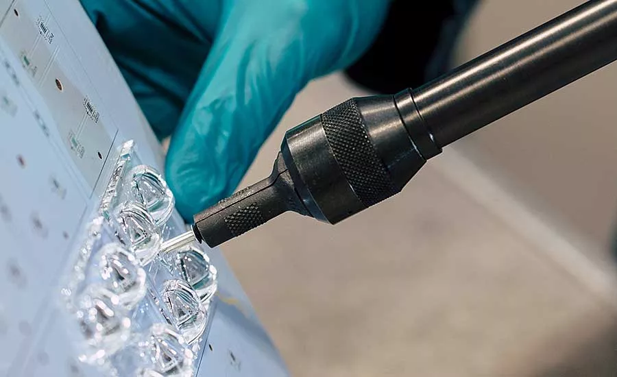

To help customers, Stanley Engineered Fastening often replicates a blind rivet’s grip range in a lab setting on a test plate. The test helps ensure that a specific rivet will work in a real-world application. Photo courtesy Stanley Engineered Fastening

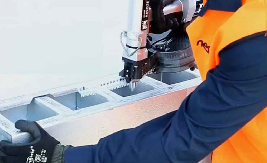

The Kingset tool automatically feeds standard rivets that are loaded on a plastic strip. Photo courtesy Industrial Rivet & Fastener Co.

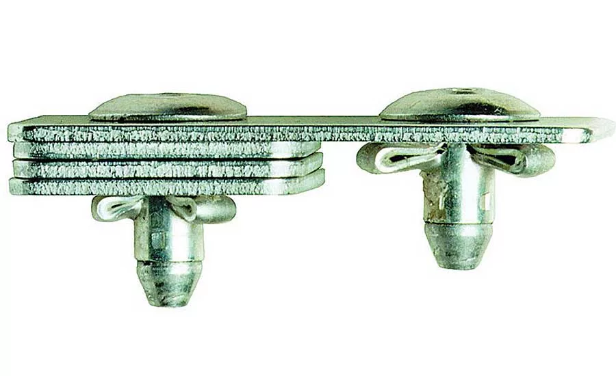

When installed, the Bulb-Tite rivet has a trifurcate expansion (like opening flower petals) on the back side of the material, so the clamping force is spread out. Photo courtesy GESIPA

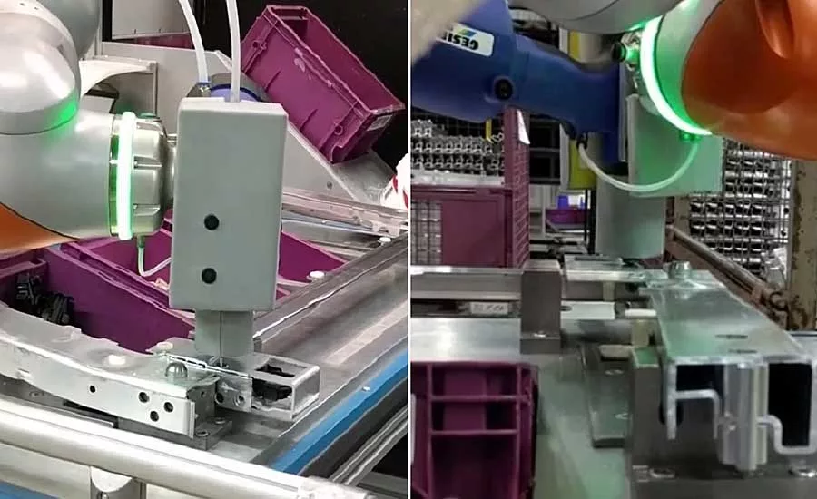

These side-by-side images, from different angles, show a cobot-mounted Taurus 2 tool (blue) install blind rivets in aluminum framing. Photos courtesy GESIPA

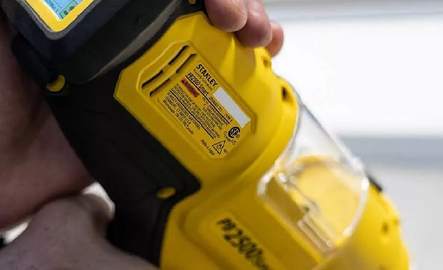

A battery-powered tool, the PB2500 SMART rivet gun features an on-board process monitoring system with built-in touch screen. Photo courtesy Stanley Engineered Fastening

GESIPA makes several assembly installation tools, including the electric GAV 8000 handheld model. The basic eco version comes without process monitoring, whereas the electronic version offers this capability.
Bonnville says both versions come with easy-to-use menu and function buttons on an HMI display. The tools handle rivets with body lengths greater than 30 millimeters and a flange diameter up to 11.4 millimeters. All spent mandrels are evacuated through a hose connected to a collection container.

Each blind rivet has a specified grip range that indicates the thickest and thinnest combination of materials it can properly hold together. The wider the range, the greater variation of thicknesses where a single rivet can be used.

To fasten assemblies made of composite materials, such as plastic, fiberglass and plywood, rivets with different upset styles are used. These rivets produce a trifurcate expansion (like opening flower petals) on the back side of the material, so the clamping force is spread out.
The Bulb-Tite made by GESIPA is one such rivet. It features a large-diameter closing head that gently distributes pressure on sensitive and porous materials. Common automotive applications include joining composite materials when mounting loudspeakers, door modules, body and instrument panels, and seating.
The closing head protects the rivet from being pulled out of the application, and the locked mandrel keeps the joint safely together even when exposed to high loads. End-users also like that the closing head is aesthetically pleasing, with a low profile. The rivet has a wide grip range and produces a tight joint that remains rattle-free when exposed to vibration.

Also battery powered is the PB2500 SMART rivet gun from Stanley. Its smartness, so to speak, stems from an on-board process monitoring system with built-in touch screen. After obtaining force-distance data for each rivet installation, the system immediately compares it against a ‘good’ force-distance curve. The operator is then notified whether the installed rivet is OK or not OK. Up to 500,000 setting results can be stored in the tool for later analysis.
The tool is also Wi-Fi and Bluetooth enabled, and designed for blind riveting either on an assembly line or at a remote location. Custovic says it offers the quality and robustness of the original PB2500 tool, as well as being cordless to further improve worker accessibility, mobility and productivity.
IRFC’s autofeed-type blind rivet installation tool is called Kingset, which feeds standard rivets (0.1875-inch diameter) from a plastic strip that is loaded into the tool. It weighs 5.5 pounds, and has a two-second cycle time and eight- to 10-second reload time. All spent mandrels are collected to prevent them from cluttering the work area.
One electronic-component manufacturer has been using the Kingset for three years to assemble sheet-metal chassis. Sherman says the company likes that the tool streamlines the process and reduces operator motion. The operator simultaneously inserts the rivet while aligning the predrilled holes in the metal, thereby reducing the cycle time for each assembly by about 2 minutes. Shorter cycles enable the company to produce an estimated 600,000 units each year.
