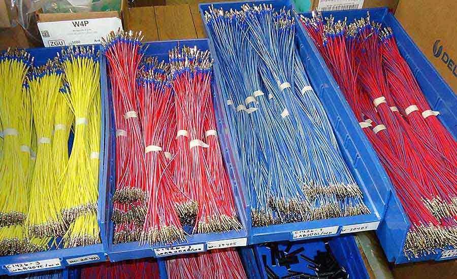

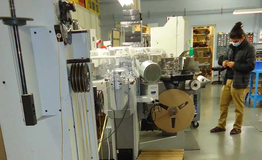

CEL uses an Alpha 455 machine made by Komax to automatically measure, cut, strip and crimp wire. Photo by Jim Camillo

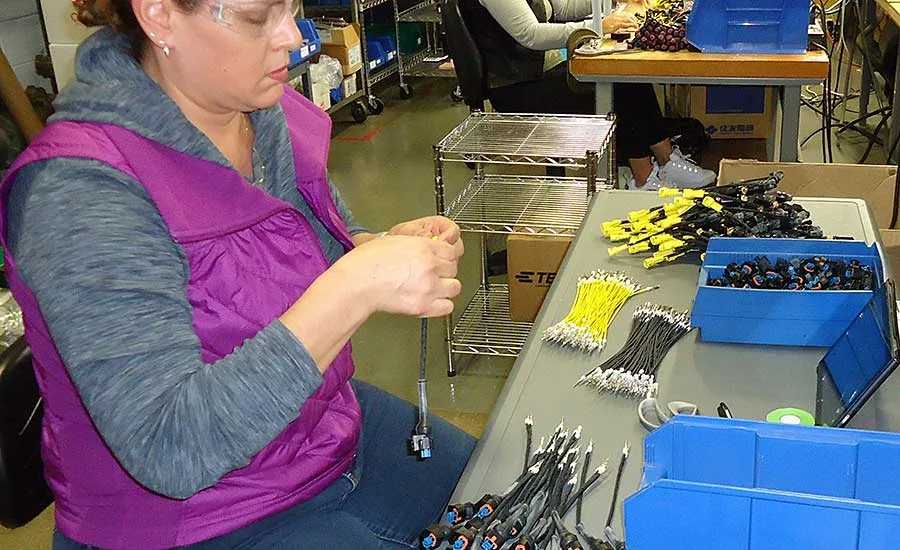

Some harnesses CEL assembles are complex in terms of process engineering or sorting characteristics, such as the use of color-coded wire. Photo by Jim Camillo

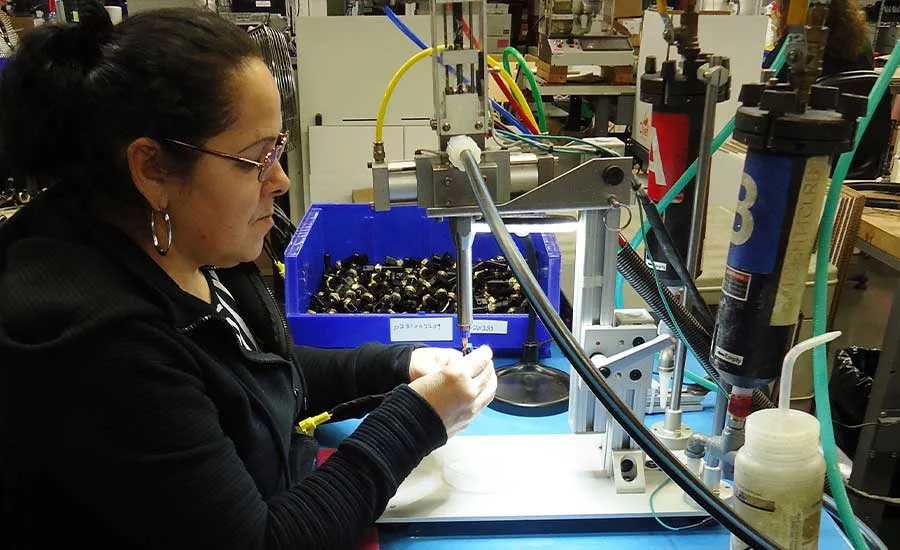

For harnesses used by Bosch and other customers, CEL applies a small amount of adhesive (shown here) at the wire-connector interface to improve its endurance against vibration and extreme temperatures. Photo by Jim Camillo

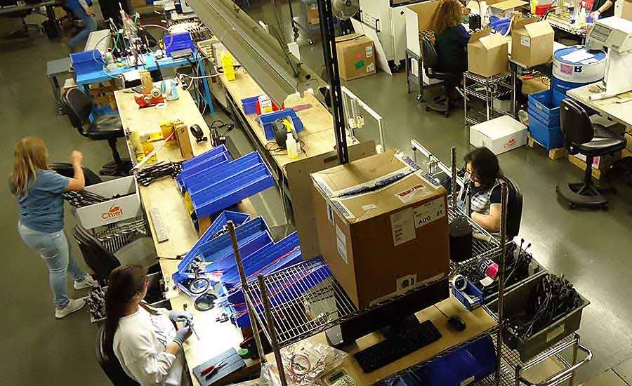

Fifty-six people work at CEL’s Elmhurst, IL, facility, with half in assembly and production. Photo by Jim Camillo

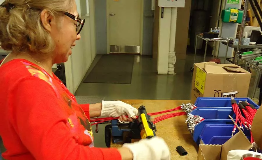

Here, an assembler uses a hand-operated hydraulic press to crimp a one-hole lug compression connector over a section of ultrasonically welded copper. Photo by Jim Camillo

“We learned quickly that the effects of vibration and harsh weather on harnesses are a big deal for manufacturers,” explains Hultquist. “Most of their harnesses feature connectors similar to those used in automobiles, and traditionally, the harness makers have simply snapped each wire into the connector. Also traditionally, though, the snowmobile and equipment owners got used to just replacing the harness when there was any problem related to the attached component, like a fuel injector. Our design team looked for a better alternative to this short-use-and-toss approach.”
According to Hultquist, CEL engineers worked closely with those at Bosch to investigate the use of an adhesive to improve the stability and endurance of the wire-connector interface. The engineers were also able to collaborate with an undisclosed adhesive supplier to develop a proprietary two-component formulation to use at the interface.
“It took about a year of work to test and validate the right adhesive for this purpose,” says Hultquist. “Now, many customers spec this simple process in the harnesses we build for them. After a 0.5-gram dot of adhesive is automatically dispensed into the connector opening, it settles deeply into the joint. The worker manually presses the wire inside until it clicks into place. Curing takes just a few seconds without the need for heat or UV light.”

Next, the harness is brought to a third station where a worker uses a hand-operated hydraulic press to crimp a one-hole lug compression connector over the welded copper section. She also places a small black band over the center of the wires to keep them together during shipping. After receiving the harness, the OEM installs it by plugging the ferrules into terminal cavities in the module base and bolting the connector to a bus bar or other electricity element.

Fifty six people work here, with half doing management and office work, and half in assembly and production. The assemblers work in either of two shifts: 7 a.m. to 3 p.m., or 1 p.m. to 9 p.m.

At the Elmhurst facility, a large amount of wire is measured, cut, stripped and crimped by an automated Alpha 455 machine made by Komax. A sealing module is attached to the machine and used as needed to seal wire.
CEL assemblers here also use two other Komax machines. The Komax BT 752 performs stripping, seal loading and crimping; and the Komax 332 unit lets workers measure the pull-off force of any processed wire.
Two additional machines are available to optimize wire processing. One is a semiautomatic AMP series stripper crimper made by TE Connectivity. When a worker positions the wire against the wire stop, the machine automatically strips and crimps the wire in one cycle. Also utilized is a Kingsley Modprint machine for hot stamp marking of wire.
