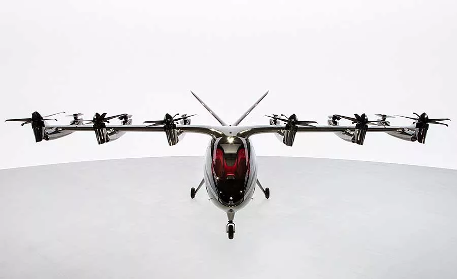

After a three-year R&D effort, a French start-up company called Ascendance Flight Technologies recently unveiled the Atea. The five-seat VTOL boasts a range of nearly 250 miles.
Equipped with modular hybrid engines developed by Ascendance, the Atea features eight rotors integrated into two fixed wings and two horizontal propellers. Two separate propulsion systems are used for vertical and horizontal flight.
A battery is used for takeoff and landing, while a turbine is used for the cruise portion of the flight. The turbine generates electricity to feed an electric distribution system for propulsion.
“The hybrid propulsion system uses a mix of kerosene and batteries for optimized fuel consumption, which results in carbon emissions reduction of up to 80 percent,” claims Jean-Christophe Lambert, CEO of Ascendance. “However, this is only the first step. Future hydrogen-powered aircraft or those using sustainable aviation fuel will be able to eliminate all emissions in flight.”
Lambert sees two paths of product evolution, including a switch to get even greener, through either hydrogen or sustainable fuels to reach net zero emissions, as well as larger aircraft equipped with more passenger seats.
“Our conviction is hybrid is necessary and the best way to quickly decarbonize aviation,” says Lambert. “As we are addressing a market for longer range flights, which a battery cannot reach, we’ll stay hybrid.”
Ascendance is also developing a more autonomous aircraft as part of a longer-term strategy. “We are developing the R&D, but we don’t plan to commercialize it until after 2030,” adds Lambert.

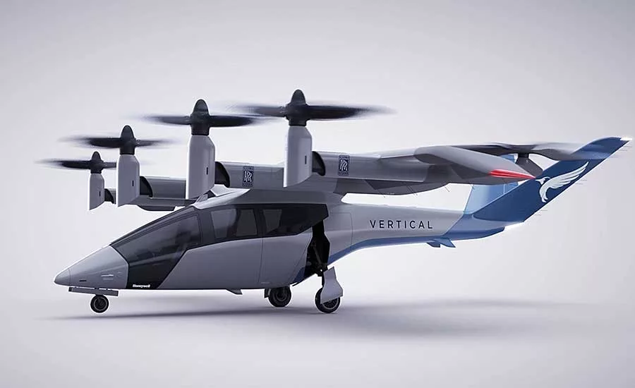

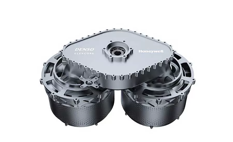

Honeywell is providing the avionics and fly-by-wire system for Vertical Aerospace’s VX4 aircraft, which is due to begin mass-production in 2024. It’s also supplying the flight deck and fly-by-wire system for the Lilium Jet, in addition to navigation and automatic landing systems for Eviation’s Alice aircraft.
The compact fly-by-wire system fits in a package the size of a paperback book and offers the redundancy needed to meet the safety and certification requirements for eVTOL aircraft. Its controls are augmented by electronics vs. purely manual controls. The system also reduces turbulence and enables engineers to push the limits of aerodynamics, eliminating the need for heavy hydraulics, control cables or pushrods.
The computer packs the brains of the plane’s flight controls into one system. A flight control computer adds stability by driving electric actuators and dynamically adjusting flight surfaces and motors, resulting in smoothly followed flight paths.
Honeywell’s system features a triplex flight control computer architecture, which provides multiple backup options and eliminates the risk of relying on one system failure. In addition, each computer uses lockstep processing, meaning it has two processing channels that constantly check each other’s work.
“A device in the past may have been only capable of doing one task, but now with multiple core systems, you can partition software, and now one box can serve as three boxes,” explains Barker. “We can reduce our weight not by necessarily shaving ounces and grams off our heatsinks, where you can’t really do a whole lot, but by doing more with less boxes. That’s where we really get our big weight savings.”

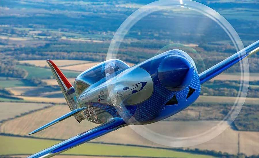

Rolls-Royce Sets Electric-Powered Aircraft Record
The “Spirit of Innovation” recently set several world records for electric-powered aircraft, reaching a top speed of 387 mph. Photo courtesy Rolls-Royce
Rolls-Royce recently set three world speed records with its all-electric “Spirit of Innovation” aircraft. The state-of-the-art plane reached a top speed of 387.4 mph during runs conducted at the UK Ministry of Defense’s Boscombe Down experimental aircraft testing site, located in southern England near Stonehenge.
The aircraft reached a top speed of 345.4 mph over a 3-kilometer course, smashing the existing record (set by the Siemens eAircraft powered Extra 330 LE Aerobatic aircraft in 2017) by 132mph. In further runs, the Rolls-Royce plane achieved 330 mph over 15 kilometers (182mph faster than the previous record) and broke the fastest time to climb 3,000 meters by 60 seconds, with a time of 202 seconds.
“The advanced battery and propulsion technology developed for this program has exciting applications for the Advanced Air Mobility market,” says Warren East, CEO of Rolls-Royce. “Never in the history of FAI record attempts has there been such a significant increase in speed over such a short time, highlighting the rapid pace at which electrification of aerospace is advancing.”
The “Spirit of Innovation” was propelled on its record breaking runs by a 400 kilowatt (more than 500 hp) electric power train and the most power-dense propulsion battery pack ever assembled in aerospace. Rolls-Royce worked in partnership with aviation energy storage specialist Electroflight and automotive power train supplier YASA. Aside from being a stunning technical achievement, the project and world record runs provided important data for future electric power and propulsion systems for all-electric urban air mobility and hybrid-electric commuter aircraft. The characteristics that air taxis require from batteries, for instance, are very similar to what was developed for the "Spirit of Innovation."
“Electric flight is set to be as transformative for mobility as the jet engine was 70 years ago,” claims Tim Woolmer, Ph.D., chief technology officer at YASA. “It’s thrilling to see our ultra-high performance, super-low weight electric motors powering the ‘Spirit of Innovation’ to these great speeds, and to know that [this project] takes us one step closer to emissions-free electric flight becoming a commercial reality for all.”
