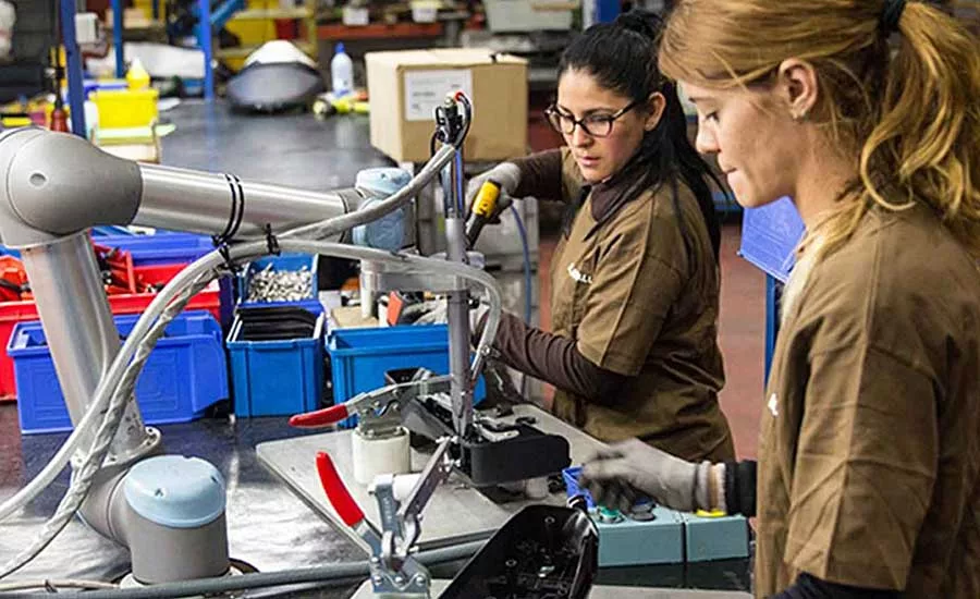

Collaborative robots enable humans and machines to work in close proximity. Photo courtesy Universal Robots A/S

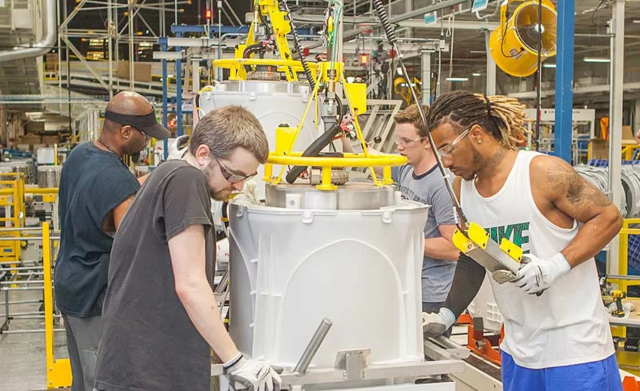

Man vs. Machine
People still play an important role on appliance assembly lines. Photo courtesy GE Appliances

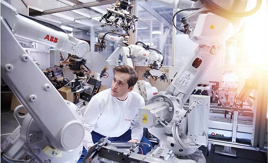

Man vs. Machine

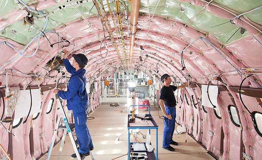

Humans are hard to replace with machines for complex tasks, such as aircraft assembly. Photo courtesy Airbus

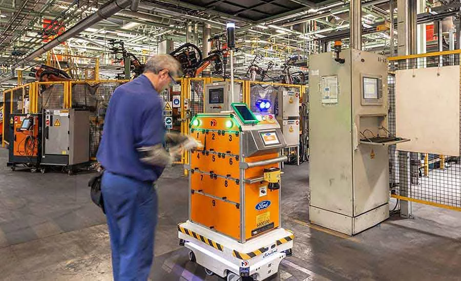

Man vs. Machine
Machines are better at dangerous, dirty, mundane and repetitive tasks. Photo courtesy Ford Motor Co.

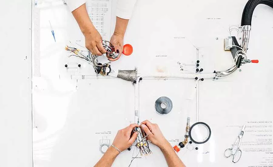

Man vs. Machine

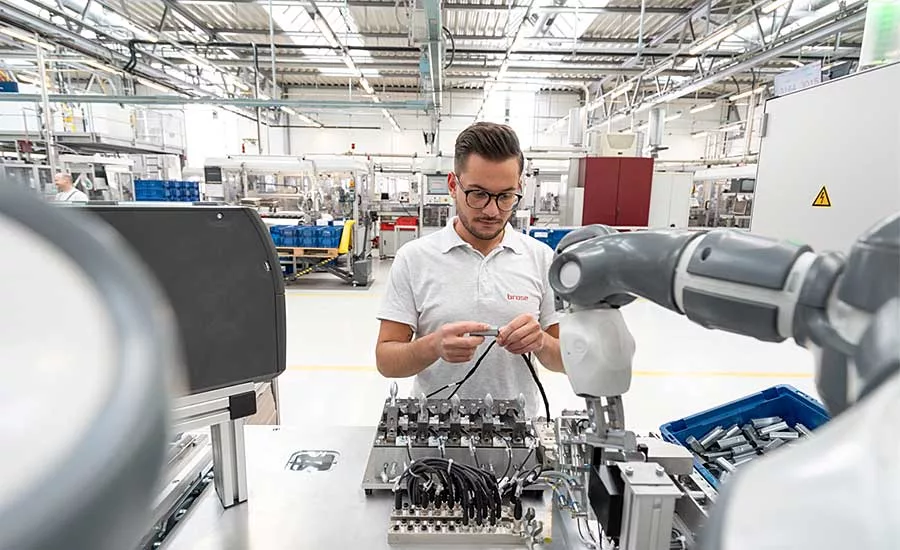

Some applications, such as wire harness assembly, are difficult to automate. Photo courtesy Safran SA

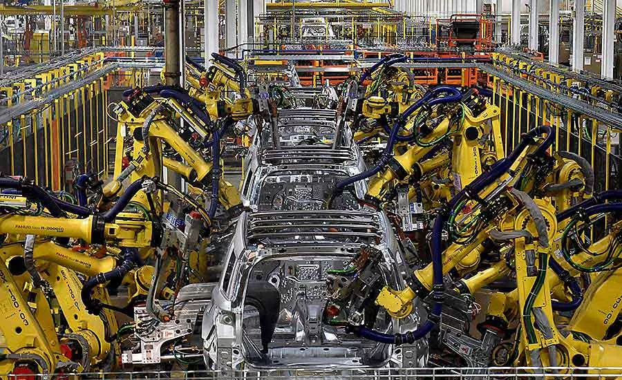

Man vs. Machine

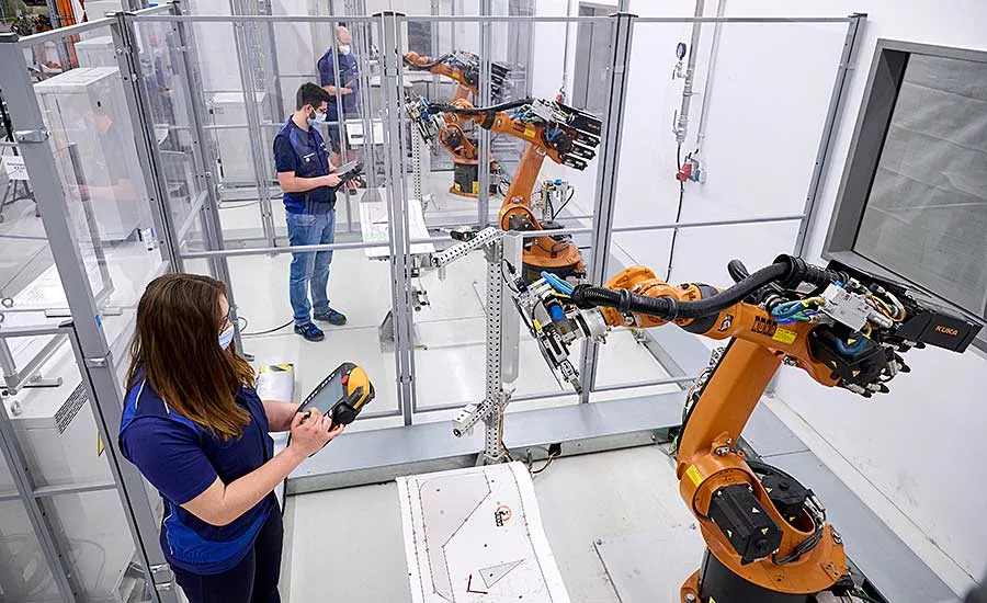

Most robots are only as good as the humans who program them. Photo courtesy Volkswagen AG

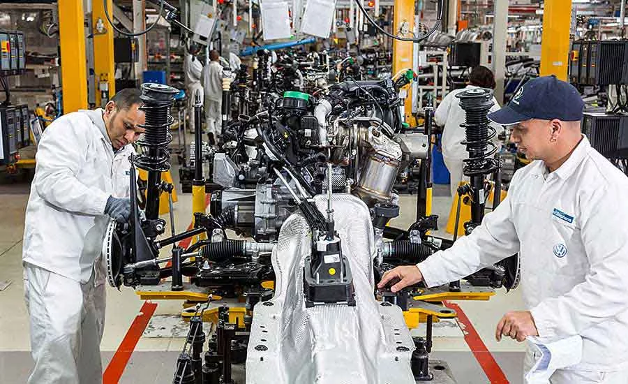

Man vs. Machine
Humans will continue to be part of automotive assembly lines for decades. Photo courtesy BMW AG
