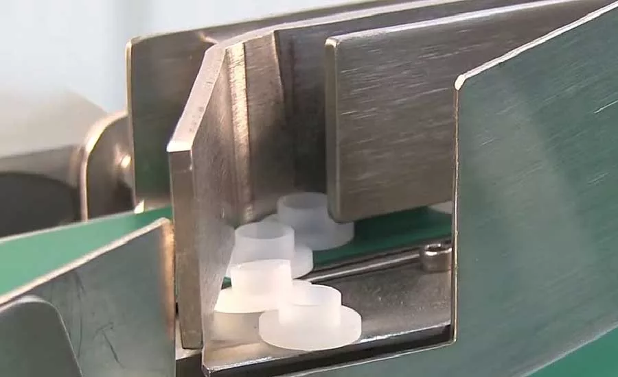

Circular parts are quite challenging to feed, with round caps being a little easier to feed due to their thickness. Photo courtesy Performance Feeders Inc.

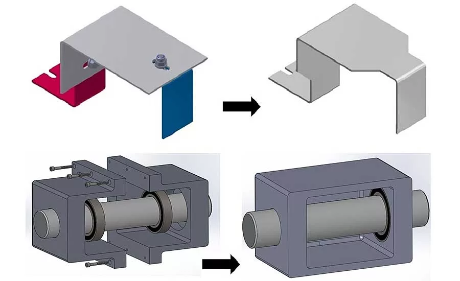

This graphic illustrates how parts change when designed according to DFMA principles. The revised parts are on the right. Graphics courtesy Medntechnology.co.uk and Steiner Technologies

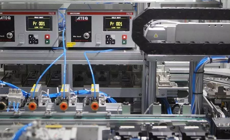

Since 2019, Fresh Consulting has implemented the use of automation and robots to help its clients with their product assembly and testing (shown here). Photo courtesy Fresh Consulting

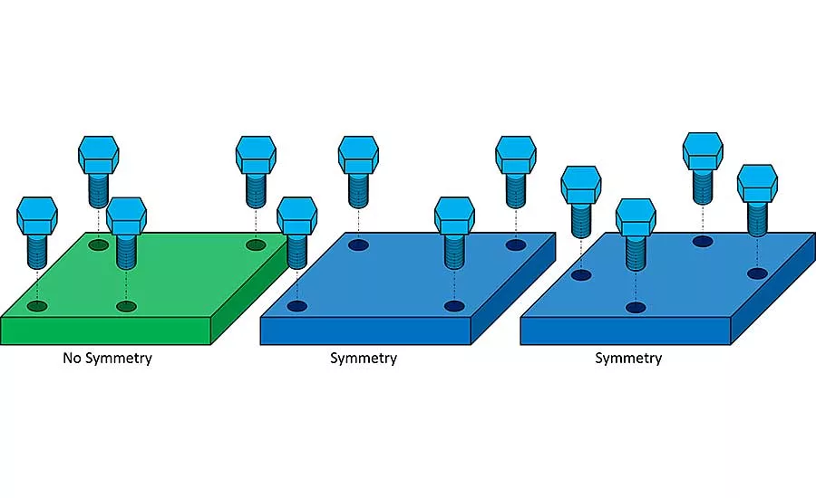

DFMA emphasizes the importance and benefits of symmetry in part design. Graphic courtesy Christoph Roser at AllAboutLean.com

The basic principles of design for manufacture and assembly (DFMA) are a good place to start, regardless of how the product will be assembled. DFMA is a technique pioneered by University of Massachusetts professor Geoffrey Boothroyd and University of Manchester professor Peter Dewhurst in the 1980s. It combines DFM (design for manufacturing) and DFA (design for assembly), and is used throughout the entire product development lifecycle—from concept selection to cost estimating and product benchmarking.
DFM focuses on minimizing part cost though choosing the best manufacturing process, the optimal material and the best tool for making the product. DFA emphasizes minimizing the total cost of the product by reducing total part count, assembly time and the complexity of the assembly process.

Minimizing parts is the biggest advantage of the DFMA methodology, but other basic tenets must not be overlooked, according to Meeker. Engineers should design products that require few or no fasteners and no reorientation during assembly. Modular design is also recommended if making a family of products with feature variations.

“Circular parts, like washers, can be quite challenging to feed,” says Pflum. “When they are thinner than 0.005 inch, they tend to stack on top of each other and won’t feed up the feeder bowl. When they are less than 0.03 thick, they are subject to jamming in the inline.
“Round caps are a little easier to feed due to their thickness, but their feed rate will be different in vibratory and centrifugal systems,” he continues. “For example, a 1.5-inch-diameter cap can be fed at a rate of 60 to 120 parts per minute in a vibratory bowl or step feeder, vs. 900 parts per minute in a centrifugal system. Centrifugal feeders are designed more for high-speed feeding.”

Based in Seattle, Fresh Consulting is a full-service product development company that was founded in 2007. Since 2019, the company has implemented the use of automation and robots to help its clients with their product assembly and testing. Clients range from Fortune 500 OEMs, to logistics companies, to small entrepreneur-inventors, and growing mom-and-pop manufacturers with a niche product they want to assemble with automation.
“Understanding market fundamentals plays a significant role in determining whether or not a company should automate assembly,” opines Micheletti. “Knowing the product’s intended lifespan and expected production volume are also key factors in determining the ROI of any automation capital investment.”
When a prospective client meets with Fresh engineers, the client discusses its automation goals and preferred equipment. These include feeders, conveyors, robots, indexers, motors, vision systems, sensors, gearboxes and PLCs.
