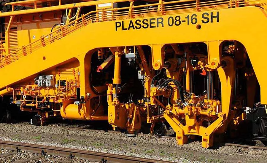

Plasser machines efficiently and accurately lay railroad track in the correct geometrical position using hydraulic nonsynchronous constant pressure. Photo courtesy Plasser America Corp.

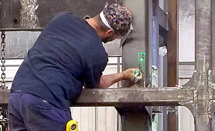

Plasser America Corp. uses the Tracer projector to project component locations onto the model frames of its railroad-track-tamping machines. Photo courtesy FARO

Still others, like Plasser American Corp. (PAC), love trains because of the track they ride on. PAC, you see, makes large machines that efficiently and accurately lay the track in the correct geometrical position using hydraulic nonsynchronous constant pressure.

Eventually, PAC researched laser projection technology before purchasing a Focus 70 laser scanner and a Tracer laser projector from FARO. Workers now use the hand layout process for the first machine frame type, before scanning the frame as a complete model with the Focus and merging this scan data with related CAD files. From these files the company creates projector files, which enable the Tracer to project component locations onto succeeding model frames.
PAC likes that the projection equipment enables easy updating of engineering documentation for critical and noncritical machine components alike. The company has also reduced the time needed for gathering and documenting component information on an entire machine from four weeks to two days.
Layout time has been cut in half, as well. Previously, six or more people were needed for layout work. Now, one person does layout and tack-welds components according to the projection, while another person follows and finishes the welds.
A final benefit is PAC can now pre-make all of its components and weld plates. Once they are attached to the machine frame, the Focus 70 scans the surface and creates high-resolution images.
From these, the projector detects, in real time, misplaced or missing parts, and foreign object debris. It also allows PAC to perform targetless alignment with the work surface by using actual holes or edges rather than retroreflectors.
