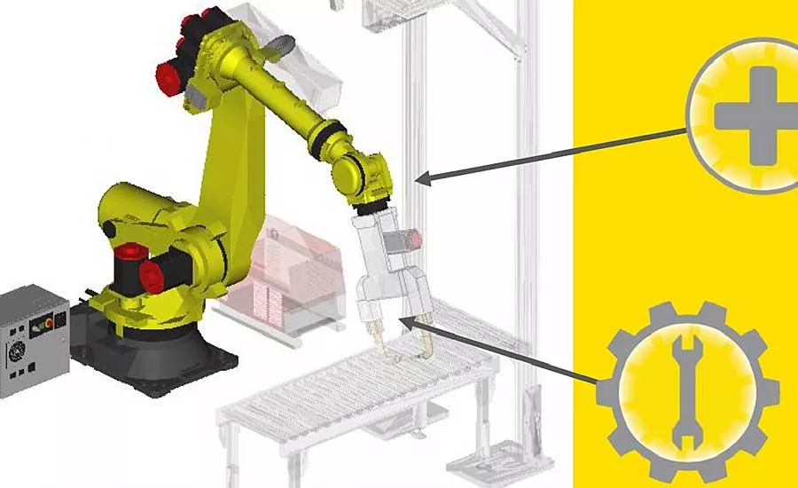

This graphic illustrates how the ZDT program works with a robot. The wrench indicates where on the EOAT the program gains data insight to recommend maintenance actions. The plus sign shows where predictive features are located.
Graphic courtesy FANUC America Corp.

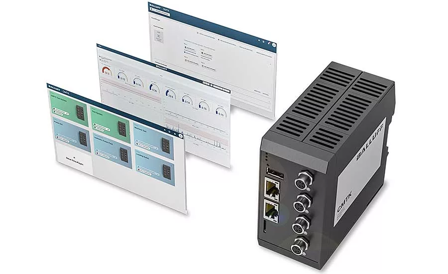

IO-Link sensors, software and a base unit make up the Condition Monitoring Toolkit.
Photo courtesy Balluff Inc.

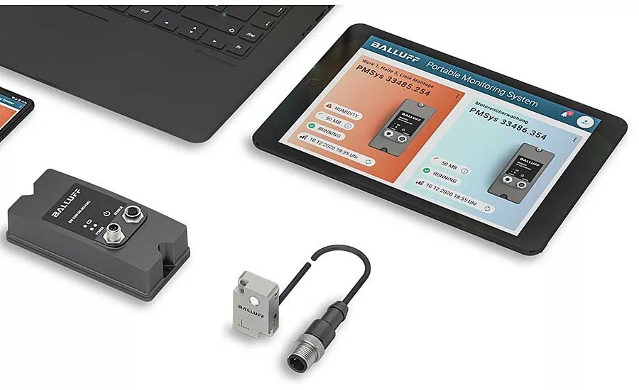

Cloud based, the Portable Monitoring System contains a condition monitoring sensor, a mobile gateway for data transmission and software to view data on any terminal device.

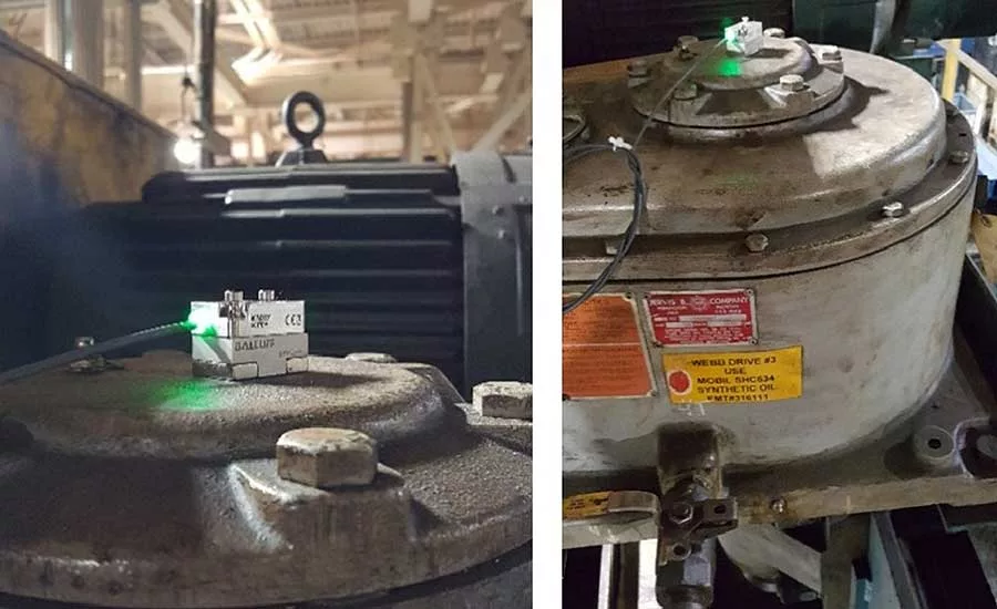

A sensor installed on this conveyor drive monitors vibration exposure to prevent drive failure.
Photos courtesy Balluff Inc.

Nearly two years ago, Balluff engineers faced an interesting maintenance challenge: Help a large automotive tier one supplier keep its old, chain-type conveyor up and running. The conveyor features multiple synchronized drives, is nearly 2,000 feet in length, and moves large metal structural components across the whole width of the plant, according to Healy.
“Because the drives are fully synchronized, when one goes down, the conveyor chain buckles and crashes, causing major production downtime,” explains Healy. “We installed a sensor on each drive to monitor its vibration exposure. When excessive vibration in the gearbox alerted maintenance to a drive failure, the manufacturer performed a controlled shutdown, thereby preventing a major machine crash.”

“ZDT works well because FANUC is vertically integrated,” explains John Tuohy, national account manager at FANUC. “The service also uses binary code for quick and simple calculations. Before introducing ZDT, we provided manufacturers a few weeks advanced notice for required maintenance. Today, we provide as much as much as six months notice, and schedule maintenance at the customer's convenience.”
According to Tuohy, the ZDT program has proven to be quite successful over the last several years. He says that about 30,000 robots worldwide are connected to the system.

These IO-Link sensors are also available as part of a Condition Monitoring Toolkit, which includes software and a base unit. Data visualization and plug-and-play commissioning are possible with the kit, so long as the retrofitted machine has 24-volt power and a plant network connection point.
Product three is a cloud-based Portable Monitoring System. It contains the BCM condition monitoring sensor, a mobile gateway for data transmission via mobile radio, and software for visualizing data on any terminal device. Healy says the system comes preconfigured to digitally and efficiently monitor pumps, fans, motors and machine tools.
