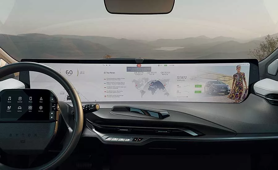

New electric vehicles, such as the M-Byte SUV, feature big cockpit displays. Photo courtesy Byton

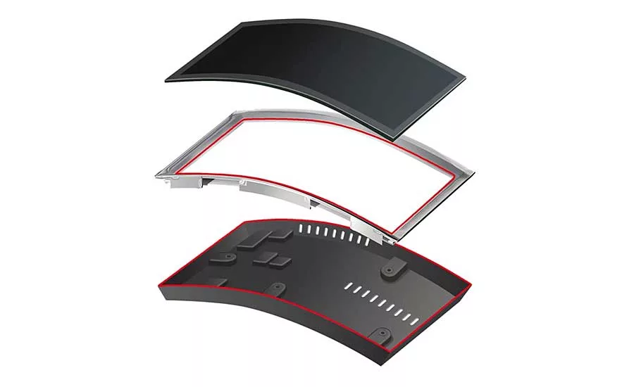

When integrating displays into assemblies, it’s important to create a tension-free and reliable connection between the display glass and the frame. Illustration courtesy DELO Industrial Adhesives
Thanks to the use of optical bonding, there is no visible boundary or gap between this instrument cluster and embedded information display. Illustration courtesy Continental AG
Structural bonding is required to attach display modules onto dashboard frames or housing structures. Illustration courtesy Henkel Adhesive Technologies

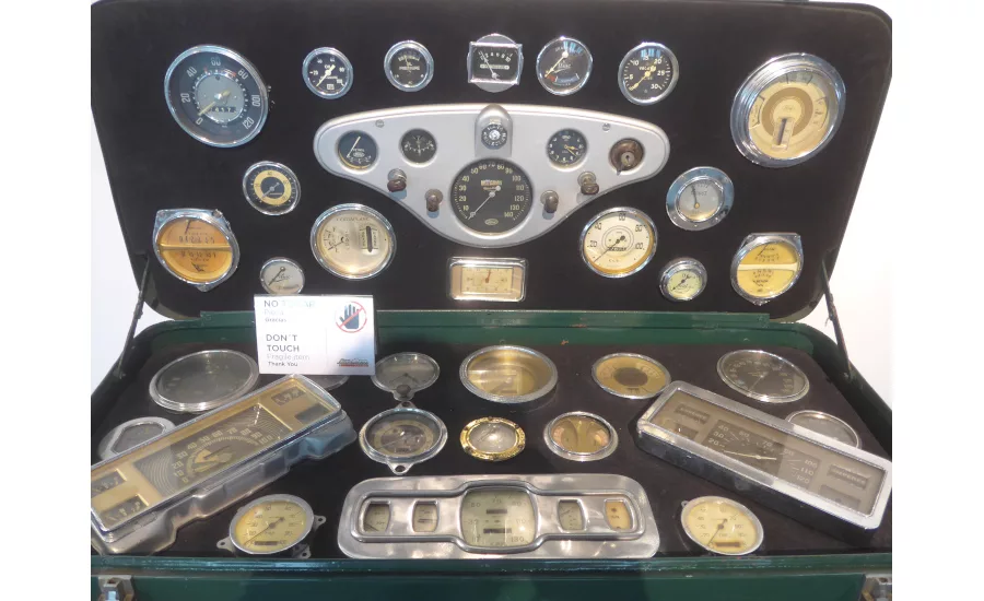

Soon, the only place to see analog instrument clusters will be in museums, such as this display at the Museo Automovilistico in Malaga, Spain. Photo by Austin Weber
July 11, 2022
Up until a few decades ago, instrument panels in most vehicles consisted of a smattering of simple analog buttons, dials, gauges, knobs and needles. Today, mechanical speedometers and tachometers have gone the way of ashtrays, bench seats, hood ornaments, hub caps and running boards.

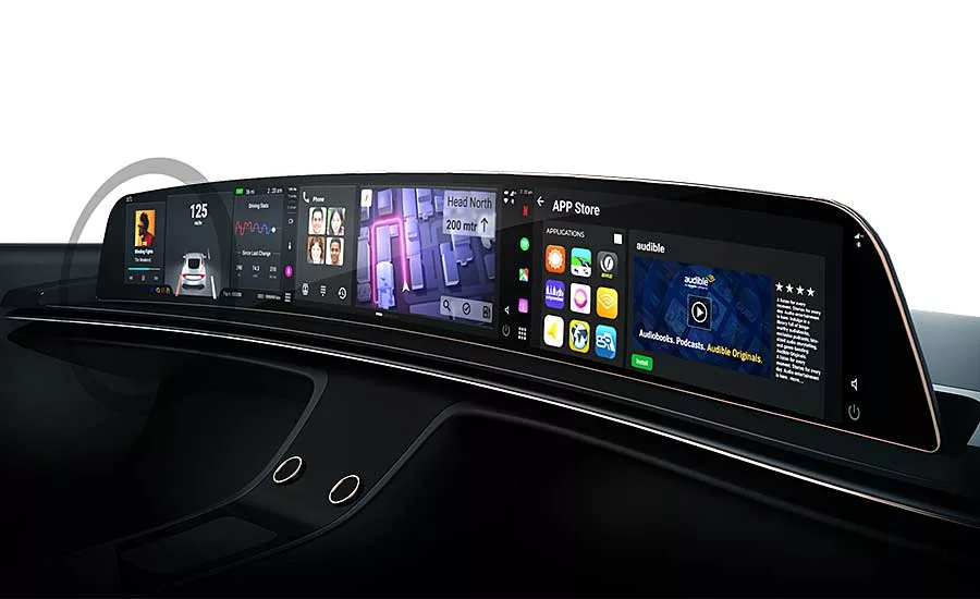

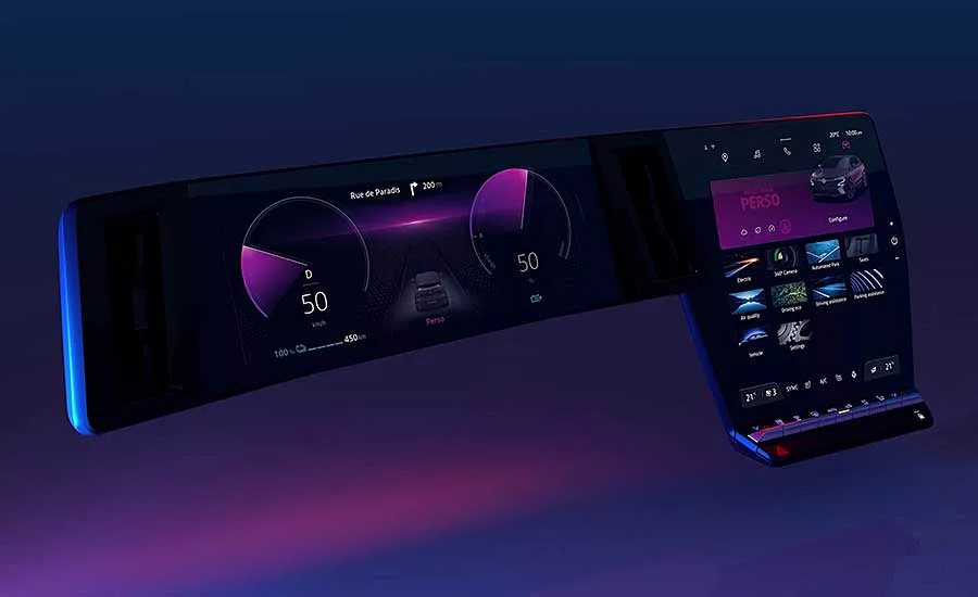

“There’s a trend toward combining instrument clusters and center stacks into one large unit called a multidisplay module,” says Kyle Davis, senior analyst for connected car and vehicle experience at IHS Automotive. “Because it provides a cleaner look and feel in the interior, these types of displays are beginning to appear in vehicles such as the Cadillac Escalade and the Mercedes-Benz A-Class.
“Consumers today are used to interacting with displays on smartphones, tablets and other portable electronic devices, so automakers are following the trend,” explains Davis. “It’s a way for them to be creative and differentiate their products. We’re seeing more complex display configurations, because automakers are going for the ‘wow’ factor whenever someone steps into a vehicle.”

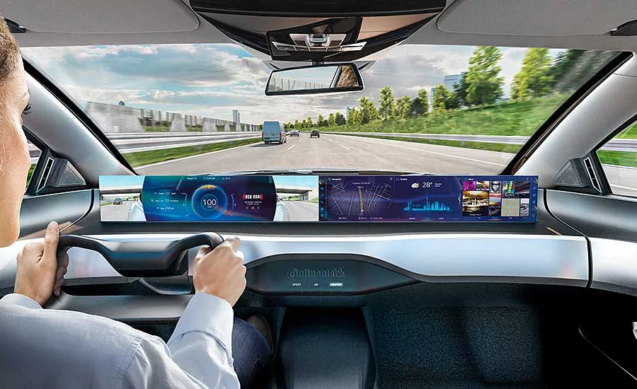

Continental AG recently developed a large OLED display for a major OEM that it plans to begin producing next year. It stretches from the driver’s area to the center console and integrates two screens that are optically bonded behind a curved glass surface.
“The integrated OLED display ensures a first-class user experience and offers automotive manufacturers a further opportunity for differentiation and individualization,” notes Frank Rabe, Ph.D., head of the human-machine interface business unit at Continental. “Among other things, OLED technology delivers an aesthetically appealing user experience because it’s self-illuminating.
“This means that no backlighting is required, in contrast to conventional LCD displays, which results in extremely lightweight and flat units, and significantly increases design freedom thanks to the compact dimensions,” Rabe points out. “The technology also allows for more complex shapes and curved installation of the display. The screen’s slim bezel rounds off the overall visual package and creates a satisfying appearance.”

Structural bonding is required to attach display modules onto dashboard frames or housing structures. However, challenges include bonding narrow borders and thin bondlines, quick handling strength and the need to assemble multiple substrate materials. New applications demand modules that are thinner and lighter, in addition to the need to integrate increasingly complex advanced driver assistance and infotainment systems.
“When integrating displays into assemblies, the most important thing is to create a tension-free and reliable connection between the display glass and the frame, as well as between the different materials of retainers, housings and active components,” says Bitzer. “Something else to consider is the size of the assemblies, which often requires the use of room-temperature curing adhesives.”
