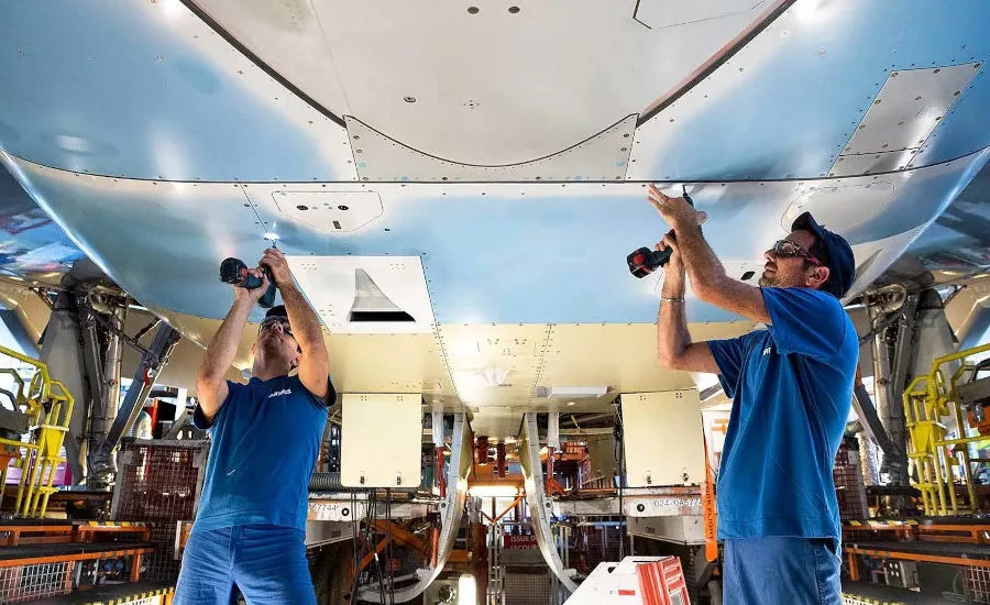

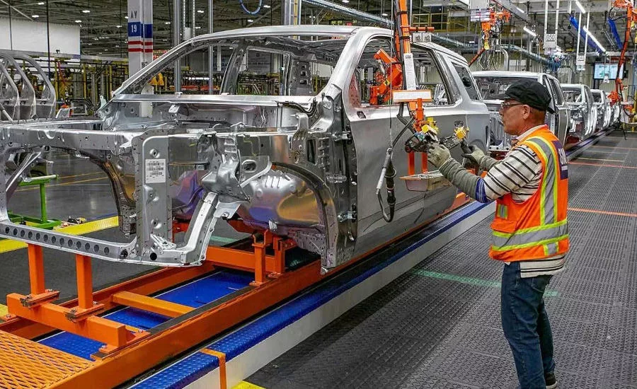

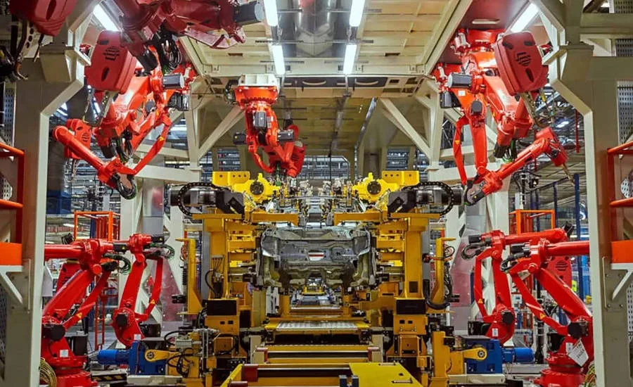

Large and small manufacturers must take steps to protect their assembly lines from cyberattacks. Photo courtesy Brose

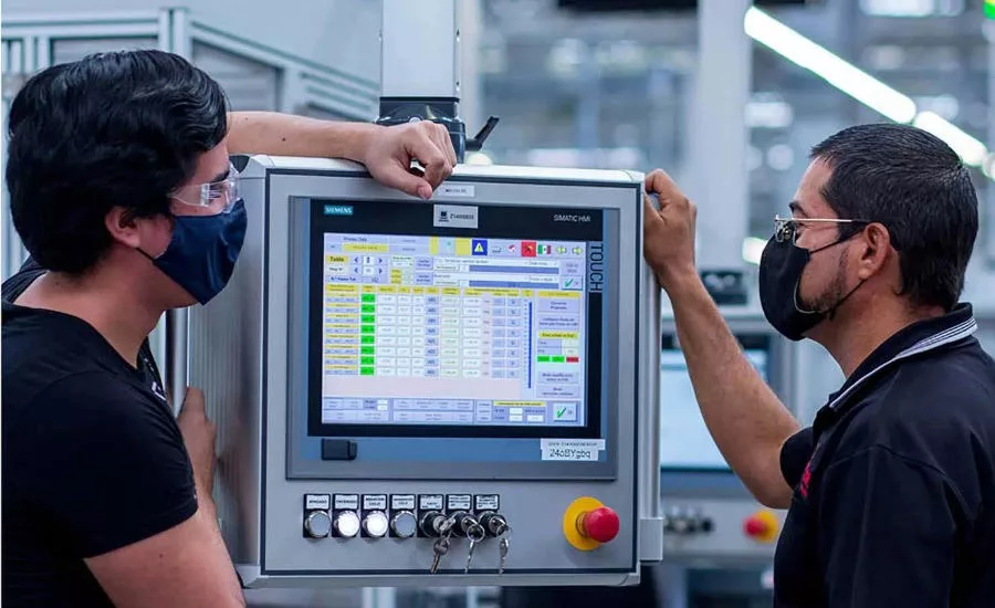

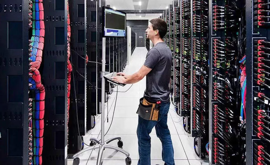

Rapid adoption of Industry 4.0 technology has increased the vulnerability of manufacturers. Photo courtesy Airbus

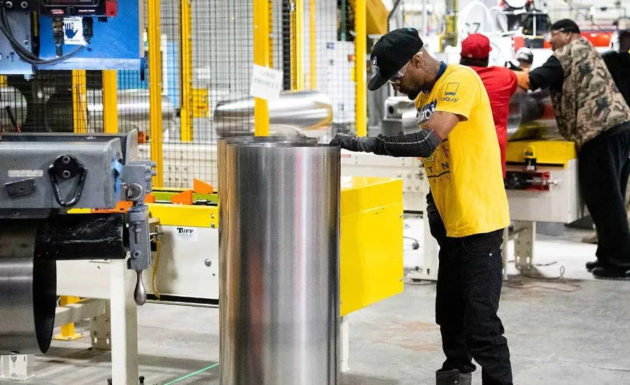

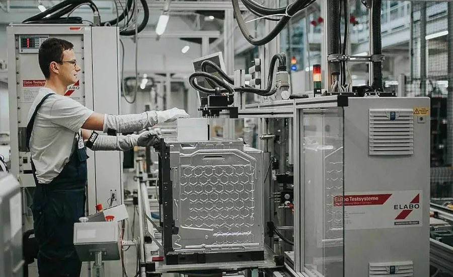

Manufacturers are particularly vulnerable to ransomware attacks. Photo courtesy BSH Hausgerate GmbH

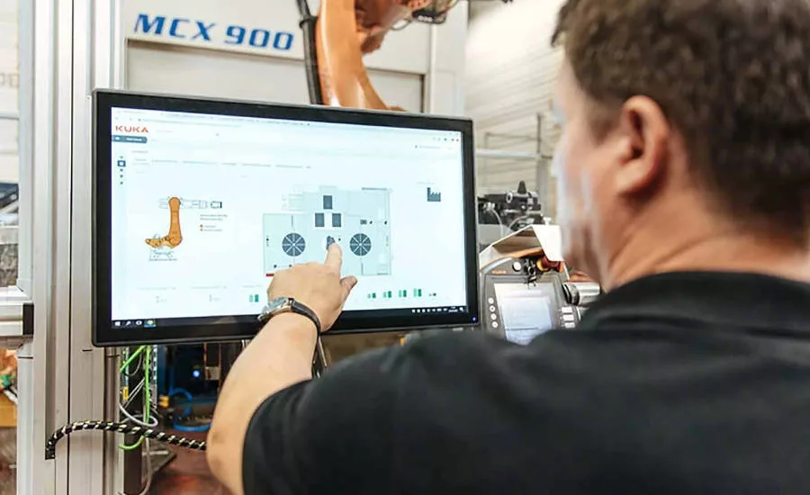

Cybersecurity initiatives must involve information technology and operational technology teams. Photo courtesy IBM Corp.
Industry 4.0 technology provides cybercriminals with more vantage points for attacks and leaves assembly lines more vulnerable than ever. Photo courtesy KUKA Robot

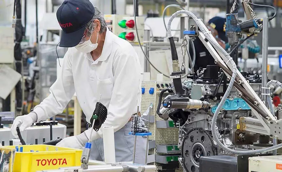

Earlier this year, Toyota was forced to suspend operations at 14 plants in Japan after a key supplier was hit with a ransomware attack. Photo courtesy Toyota Motor Corp.

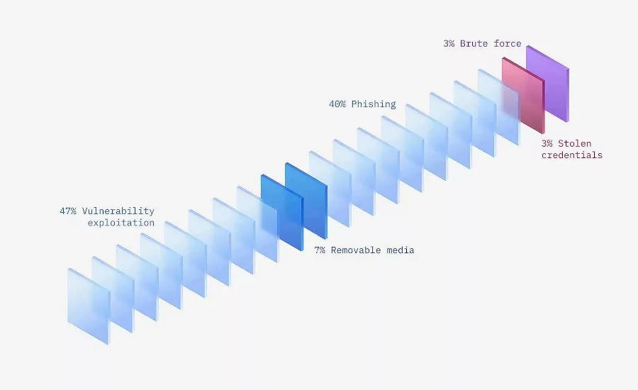

Phishing is one of the top infection vectors for manufacturers. Illustration courtesy IBM Corp.

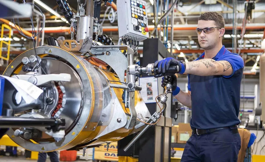

Robotic systems and processes are increasingly vulnerable to cyberattacks. Photo courtesy Stellantis

As assembly plants become more digitally connected to both suppliers and customers, the potential threat posed by cyberattacks will only get worse. Cyberthreats to manufacturers are real, and the consequences can be devastating.
Aside from locking up host computers or holding critical data hostage, hackers could, for example, simulate that a robot or conveyor is working properly when it is not. As a result, the machine could produce faulty products or have a catastrophic breakdown.
In the past, plant managers and manufacturing engineers only had to worry about occasional machine breakdowns or malfunctions. But, things are much different in today’s Industry 4.0 era. A cyberattack thousands of miles away can shut down an entire factory.
Toyota Motor Co. recently learned that firsthand. Earlier this year, it was forced to suspend operations at 28 production lines across 14 plants in Japan for at least a day after a key supplier, Kojima Industries, was hit with a ransomware attack. The incident affected one-third of the automaker’s global production capacity.

Manufacturers are particularly vulnerable to ransomware attacks. Ransomware schemes often target manufacturers by disabling their operations technology and blackmailing victims into paying to restore the functionality of their systems. Manufacturers that cannot afford to have production halted by hacks often have no choice but to pay the hackers’ ransom.
Industrial ransomware attacks increased significantly in 2021, with criminal groups specifically identifying manufacturers as vulnerable and profitable targets. Last year, manufacturing accounted for 65 percent of industrial ransomware incidents, according to Dragos Inc., a cybersecurity provider. The top three manufacturing subsectors targeted were metal components (17 percent), automotive (8 percent) and plastics (6 percent).
Unfortunately, most manufacturers remain unprepared for ransomware attacks, warns Peter Vescuso, vice president of marketing at Dragos and a member of the Manufacturing Leadership Council, a division of the National Association of Manufacturers that focuses on digital transformation.
Vescuso claims that 90 percent of manufacturers have limited visibility into their operational technology (OT) systems and are ill prepared with poor network perimeters. In addition, 80 percent have external connectivity exposure in their OT systems and 60 percent use shared credentials that make it easier for ransomware groups to infiltrate systems.

Manufacturers in every industry are transitioning to cloud-based operating systems, digital production processes and wireless networks. While this is great for productivity, it gives cybercriminals more vantage points for attacks and leaves assembly lines vulnerable.
“More technology reliance equals more risk for cyberattack,” warns Eyal Benishti, CEO of Ironscales, a company that specializes in email security. “As more entry points and vulnerabilities enter the manufacturing process, it’s critical that manufacturers maintain constant, real-time visibility to these systems, implement effective cybersecurity measures for systems of all maturities and have a back-up plan in the event of a successful attack.”
“Digital transformation and the interconnectivity of industrial automation machines with IIoT are making assembly lines more vulnerable, because now more than ever it’s almost impossible to have a fully air-gapped network,” adds Quade Nettles, cybersecurity services product manager at Rockwell Automation.
“Machine learning, predictive maintenance [and other state-of-the-art technology] require some form of internet connectivity for the transfer of real-time data,” explains Nettles. “This opens a threat vector that, if not secured correctly, can be compromised by cyber adversaries.
“All industrial automation is vulnerable to cyberattacks,” Nettles points out. “Robots, conveyors and other types of equipment are controlled by [software] programs, codes and processes. If an adversary gains access to an organization’s network, they can compromise and tamper with those automation programs and impact the functionality of those machines.

“Robotic systems and processes are vulnerable in all kinds of ways,” explains Bocek. “One of the most commonly overlooked are machine identities. On every network, there are two actors: people and machines.
“People use names and passwords to gain access to networks, data and services,” says Bocek. “Machines also need to identify each other to connect to a network securely. However, machines don’t rely on user names and passwords. Instead, they use keys and certificates that serve as digital identities.
“Manufacturing organizations spend a lot of time and money protecting user names and passwords, but very little time protecting and managing machine identities,” claims Bocek. “Attackers know this, and they routinely target them in order to break in.”

  1. Cybercriminals are outsiders. In reality, cybersecurity breaches are often the result of malicious insiders, working for themselves or in concert with outside hackers. These insiders can be part of well-organized groups backed by nation-states.
  2. Risks are well-known. In fact, the risk surface is still expanding, with thousands of new vulnerabilities being reported in old and new applications and devices. And opportunities for human error—specifically by negligent employees or contractors who unintentionally cause a data breach—keep increasing.
  3. Attack vectors are contained. Cybercriminals are finding new attack vectors all the time, including Linux systems, operational technology, Internet of Things devices and cloud environments.
  4. My industry is safe. Every industry has its share of cybersecurity risks, with cyber adversaries exploiting the necessities of communication networks within almost every government and private-sector organization. Ransomware attacks are targeting more sectors than ever, and threats on supply chains have also increased.
