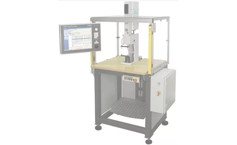

Dave Zabrosky, North American sales manager for Schmidt Technology, says a common misconception is that a servo press is necessary for force and distance monitoring.
“There’s a difference between process monitoring and process control,” he explains. “We do process monitoring on manual presses, hydraulic presses, pneumatic presses and servo presses. Monitoring measures what happens during the pressing operation. But, you look at the data after the fact.
“Servo presses are about control. They monitor the process, but they use that data as feedback to control the motion of the ram. A lot of times, that’s not what our customers need.
“For the most part, they want process monitoring for quality control. They want to be able to put tolerances on a force and distance curve to ensure that every part they produce is the same and to detect parts that are out of that range.”

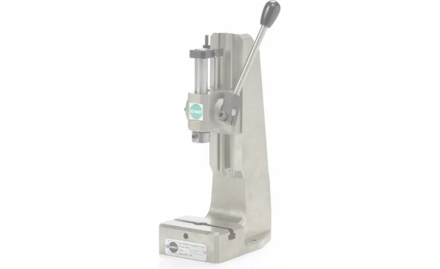

Another common mistake, particularly with manual presses, is to choose the wrong type of press for the application, says Zabrosky. When selecting a press, engineers often look solely at the machine’s force capacity without considering how it actually delivers that force.
For example, a manual toggle press is a better option for crimping, staking and swaging applications, because it produces little force at the start of the stroke, but delivers maximum force at the end. A rank-and-pinion press produces constant force over the entire length of the stroke, so it’s a better option for pressing pins.

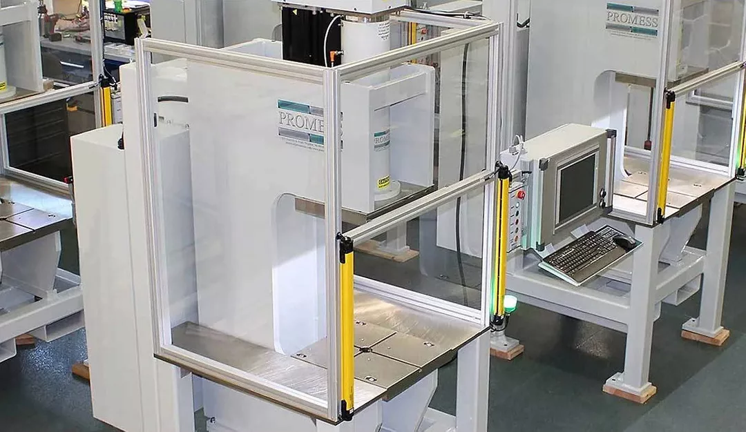

Glenn Nausley, president of Promess Inc., reiterates the importance of testing. Most mistakes with presses, he argues, begin before production even starts. Assemblers are well-advised to involve press suppliers early in the design process.
“When people buy our presses, we walk them through station design,” he says. “Our customers bring their parts and tooling, and we work through the process on our floor. We don’t see a lot of problems with our presses, because we are heavily involved in the integration. How are the parts going to go together? What are the key parameters and measurements that must be made? How can you tell a good part from a bad part? What data do you need to collect and how are you going to handle it?”

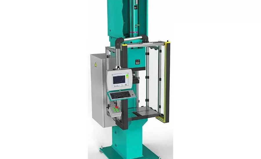

Troy Waldherr, vice president sales and operations at TOX-Pressotechnik LLC, says the most common mistakes he sees concern presses that are already on the line. He points out the following:
Zabrosky echoes the latter two points. “A common mistake is to assume that what you have is what you need,” he says. “Don’t try to use a 6-ton press to insert a pin just because you happen to have one on the shop floor. You also want to match the load cell to the application. The accuracy and resolution of a load cell is based on its capacity. A load cell that is oversized or undersized will not provide accurate readings.”
Users removing or overriding safety devices, creating injury risk.
Aligning the press ram to the physical center of a part instead of to where the maximum force is applied. “These are not always the same,” he explains. “Misalignment can cause side-loading, which can damage the press or the parts, and create a safety hazard.”
Overtaxing a press: turning up the power to drive a press over its rated capacity. This could damage the press and create a safety hazard.
Using an existing, oversized press to assemble small parts instead of buying a smaller press that is better matched to the application. An oversized press can damage the parts and tooling.
