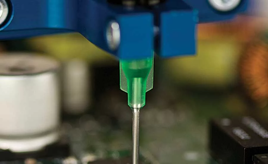

Another important aspect of the dispensing system is that it fully prevents the adhesive from being exposed to light. Kevin Zoeller, engineering sales representative at Ellsworth Adhesives, notes that all dispensing equipment needs to be both opaque and UV resistant to prevent premature curing. Curing within the dispensing tubes and needles wastes material and causes a need for increased dispensing pressure. This can cause incorrect amounts of the adhesive to be dispensed.
“Often, manufacturers underestimate how much light can cause an issue. Continued exposure to light from a window or even the overhead room lighting can cause the adhesive to cure within the dispensing equipment,” says Rodriguez.
Zoeller suggests using plastic dispensing tips that can be easily replaced if the adhesive begins to cure inside it. The dispensing pressure should be monitored as well, to show when there may be a clog in the tubing or dispensing needle due to unwanted curing. Maintaining the dispensing system is crucial to success with light-curing adhesives.

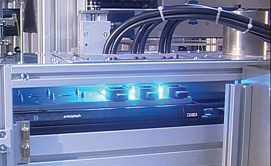

The most important part of the cure is matching the wavelength to the adhesive, Zinn states. This is also where many people go wrong with curing. The adhesives have a preferred wavelength of light at which they will cure fast and strong. While it is important to achieve this ideal light wavelength, the adhesive will still cure under lighting that is a bit off.
“UV-cured materials don’t require UV light. Rather, they need light at a wavelength near the UV spectrum. They can cure in ambient light and any light that matches the frequency required by the chemistry,” says Zoeller. “High-energy light that is closer to the blue-purple end of the spectrum cures faster than ambient or sunlight; it can cure deeper.”
Rodriguez agrees, noting that matching the UV wavelength to the photo-initiators in the material offers the best results. This can be remedied by speaking with the adhesives manufacturer to make sure that the curing light used is at the correct wavelength. In addition, Zinn says that the exposure can impact the cure.

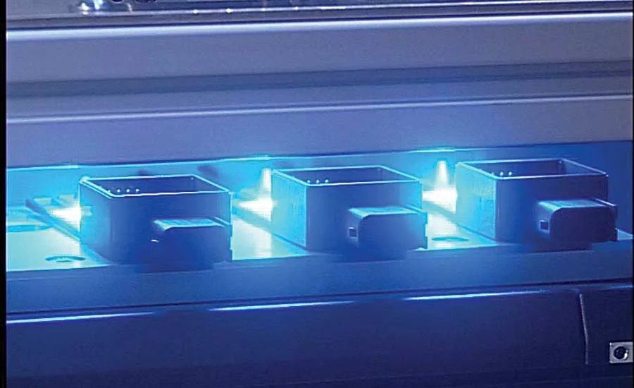

“Refraction and light block can cause incorrect exposure,” Zinn notes. The light-curing adhesive must be exposed to light for a full cure to be achieved. If certain areas of the product are shadowed and unable to be fully exposed to the light, manufacturers could consider a hybrid adhesive. Hybrid, or dual-cure, adhesives can be set with light and fully cured with heat or other activators.
However, for certain applications, heat can be a detriment to the curing process. While the adhesive can’t be over cured from light exposure, excess heat from conventional UVA or UVB lightbulbs can damage the adhesive or the substrates. LED lighting can offer the same spectrum of light, without the added heating element.

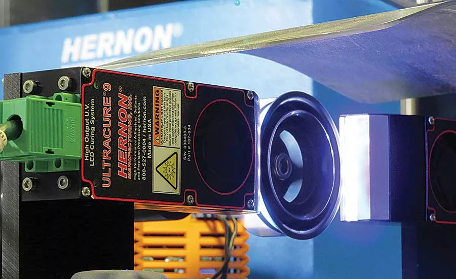

The distance of the light source from the adhesive can also affect the cure. If the light source isn’t in a fixed position, each object that is cured with it may receive different amounts of light, causing inconsistent cures. This problem is remedied by having the light built into the automation process, where the products pass by light that is at a fixed distance and intensity. Zinn suggests that manufacturers can further eliminate this step by using an automated system that cures the adhesive immediately after dispensing.
