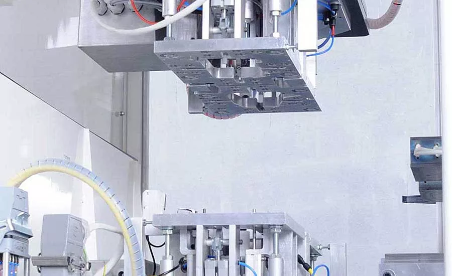

Compared with ultrasonic welding and vibration welding, hot-plate welding has two big advantages: It can weld large parts and curved parts.Photo courtesy Best Tool and Engineering Co.

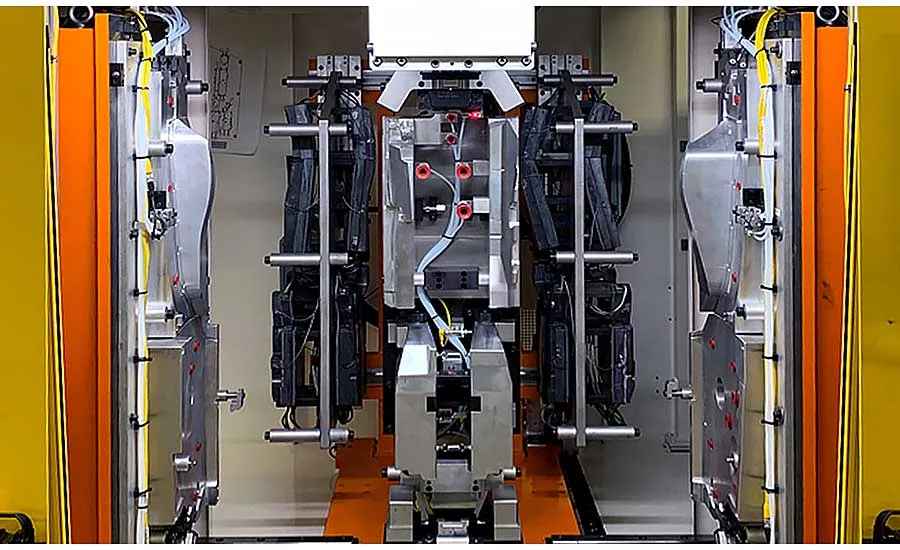

Servo control gives engineers precise control over welding force, speed and displacement. It can also detect errors, such as a warped part or a part that has been loaded incorrectly. Photo courtesy Totally Automated Systems

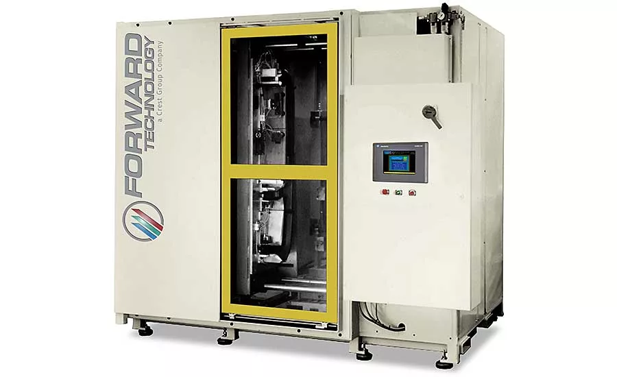

In hot-plate welding, the fixtures can be vertically or horizontally oriented. A vacuum port can be installed at the back of one or both fixtures to hold the parts in place. Photo courtesy Forward Technology

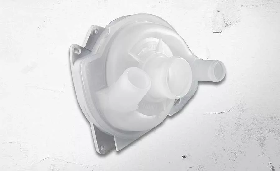

Because of the amount of material that is melted, hot-plate welding produces strong, hermetically sealed joints. Photo courtesy Sonimat

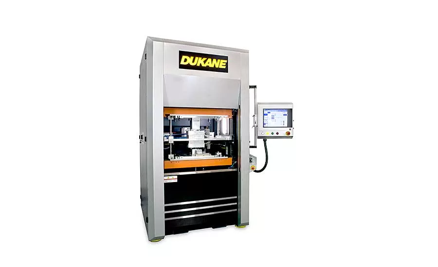

The TH3 platform can be equipped to perform infrared welding, hot-plate welding or hot-gas welding. Photo courtesy Dukane

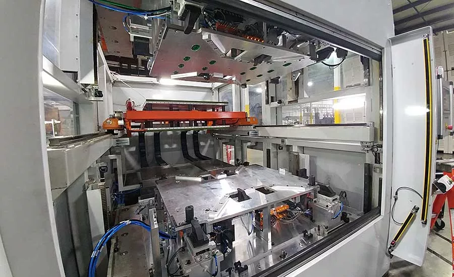

Hot-plate welding is a six-step process. First, the two halves of the assembly are loaded into custom-made fixtures. Loading is usually performed manually, though it could also be done with a six-axis robot. The fixtures can be vertically or horizontally oriented. A vacuum port can be installed at the back of one or both fixtures to hold the parts in place. When loaded, only a small portion of each part protrudes from the fixture.
The orientation of the fixtures depends on the application. Vertical fixtures are often preferred, because they’re easier for operators to load. With horizontal fixtures, operators may have difficulty seeing, and therefore loading, the upper half of the fixture. Headlight and taillight assemblies are typically done in vertical fixtures.
On the other hand, horizontal fixtures are best if the assembly has internal components. That way, components can be inserted into the lower half of the assembly without fear of the parts falling out. Horizontal fixtures are also better for long, flexible parts, such as the ductwork for an automotive dashboard.
The fixtures are connected to linear slides powered by pneumatic cylinders, hydraulic cylinders or servo-driven ballscrews. The latter lets engineers precisely control welding force, speed and displacement. It can also detect errors, such as a warped part or a part that has been loaded incorrectly.
When the machine is actuated, a heated platen moves in between the two fixtures. The fixtures then press the parts against the platen for a set time until a small portion of plastic around the edge of each part melts. Mechanical stops built into the fixtures and platen prevent too much material from being melted. (Servo control obviates the need for hard stops.)
Once the plastic has melted, the fixtures move apart, the platen withdraws, and the fixtures travel toward each other again. The parts are pressed together and held for a set time so the melted edges fuse as the plastic cools. Finally, the fixtures separate again, and the assembly is unloaded.

Compared with ultrasonic welding and vibration welding, hot-plate welding has two big advantages: It can weld large parts and curved parts. And, because of the amount of material that is melted, hot-plate welding produces strong, hermetically sealed joints. Hot-plate welding can be used on tall, thin, non-supported interior walls, and it is highly forgiving of variations in the molded parts.

If the assembly will be pressurized, engineers may want to increase the thickness of the part near the joint. As a rule of the thumb, the thickness of the joint should be 1.5 times the nominal wall thickness. For example, if the walls of a windshield washer fluid reservoir are 0.1 inch thick, the width of the joint should be at least 0.15 inch wide.
