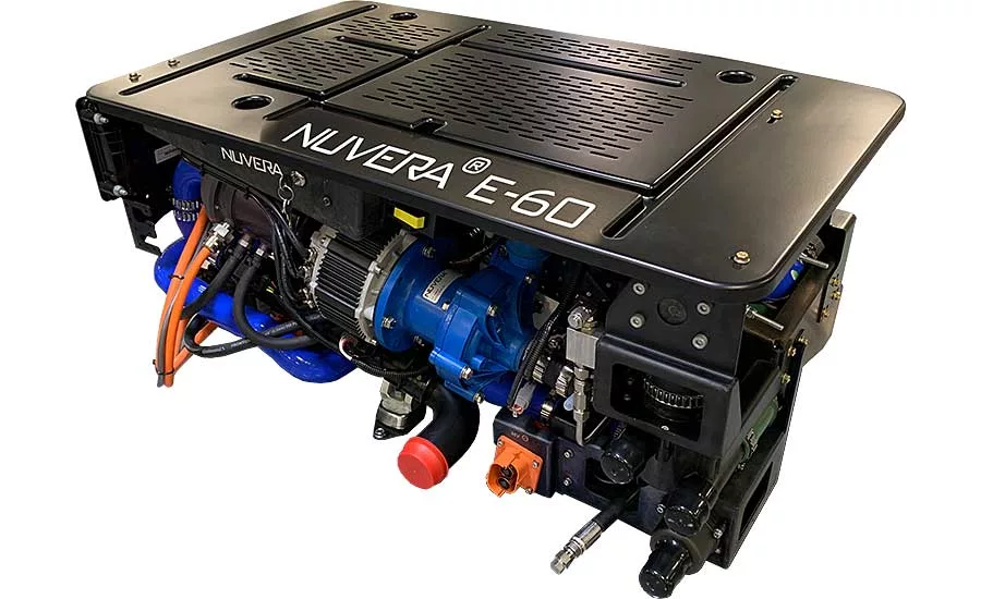

This fuel cell powers electric buses, trucks and material handling equipment. Photo courtesy Nuvera Fuel Cells LLC

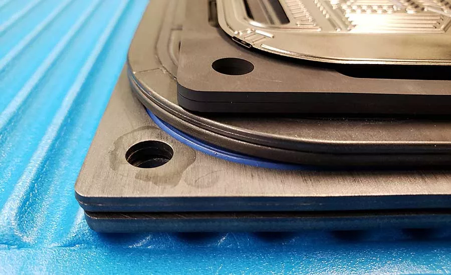

Fuel cell stacks consist of a series of bipolar plates. Photo courtesy Plug Power Inc.

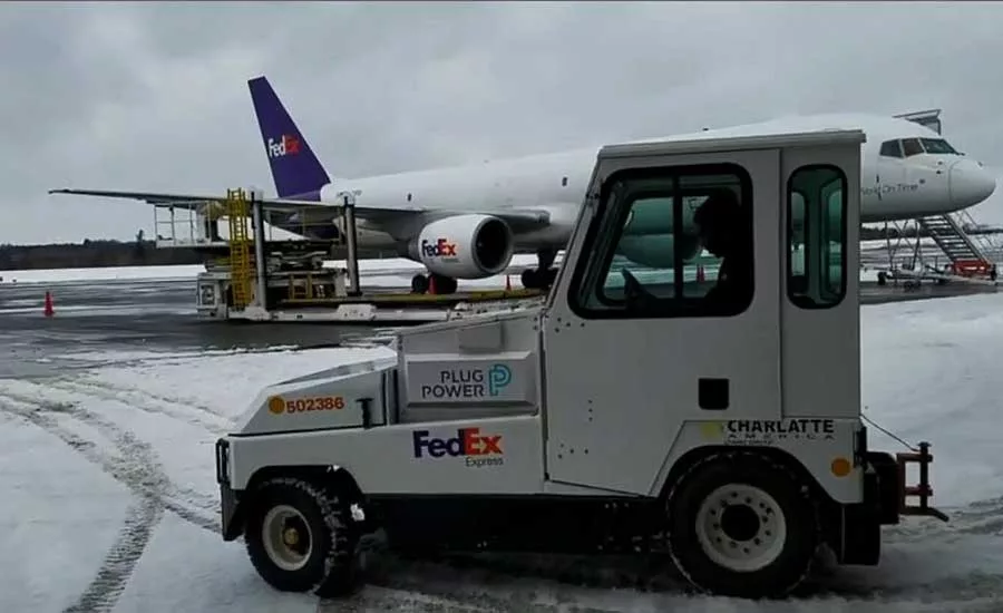

Fuel cells are ideal for material handling equipment and airport ground support vehicles. Photo courtesy Plus Power Inc.

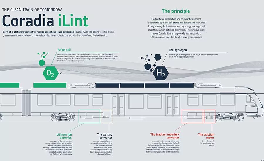

The Coradia iLint is the world’s first passenger train powered by a hydrogen fuel cell, which produces electrical power for traction. Illustration courtesy Alstom SA

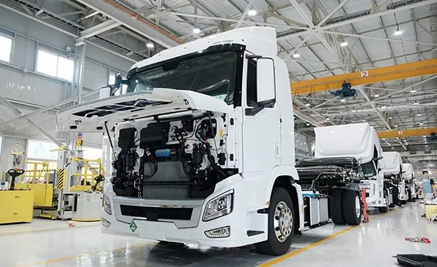

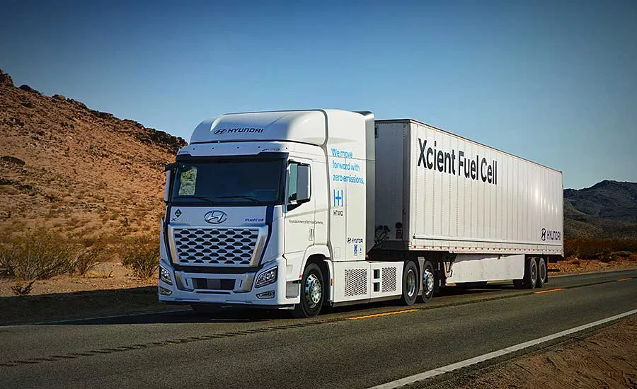

Hyundai recently started to mass-produce fuel cell-powered trucks. Photo courtesy Hyundai Motor Co.

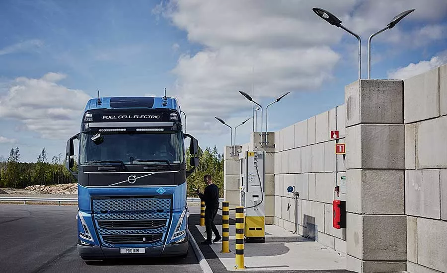

Lack of refueling infrastructure is one of the biggest barriers to widespread adoption of fuel cell vehicles. Photo courtesy Volvo Trucks

A single fuel cell consists of an electrolyte sandwiched between two electrodes. Bipolar plates on either side of the cell help distribute gases and serve as current collectors. Fuel cells are easily scalable. Depending on the application, a fuel cell stack may contain hundreds of individual fuel cells layered together.

PIVOVAR: The No. 1 issue is hydrogen infrastructure and cost. Safety is not a huge challenge; it’s more of a public perception issue. Today, hydrogen is primarily used in oil refining and ammonia production. Hydrogen is added to oil to improve its energy content and it’s used to make ammonia for fertilizer. Most hydrogen is produced at dedicated plants and consumed nearby. Distributing and delivering hydrogen to parts of the United States beyond the Gulf States region is still prohibitively expensive. Most infrastructure for refueling hydrogen vehicles is currently in California, where there are approximately 50 stations supporting 10,000 fuel cell vehicles.
