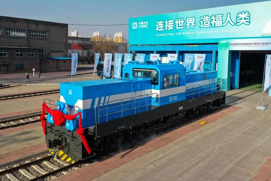

DATONG, China—A fuel cell-powered locomotive has rolled off the assembly line at CRRC’s factory here. It is designed to run at a speeds of 80 kilometers per hour, with 700 kilowatts of continuous power for 25 hours. Its maximum traction load on a straight track exceeds 5,000 tons.
"The locomotive uses a combination of a hydrogen fuel cell system and a high-power lithium battery," says Zhao Mingyuan, chief engineer of CRRC Datong Co. Ltd. “Compared with traditional fuel and electric locomotives, hydrogen-fueled hybrid locomotives are not only safer and more environmentally friendly but also quieter, cheaper and easier to maintain.”
According to Mingyuan, the modular design of the locomotive gives it the flexibility to utilize different power levels and power modes to cater to multiple applications, such as operating in tunnels and mines.
