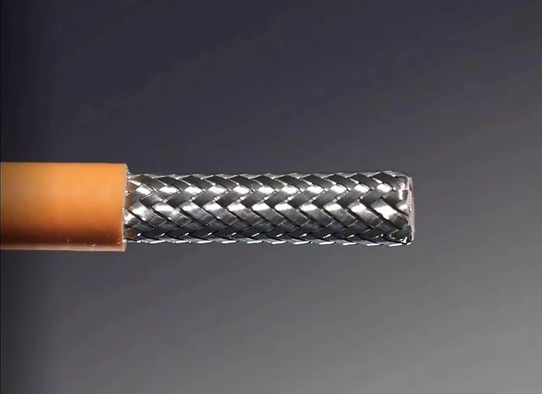

Cables without a foil layer around the shield are easier and faster to strip. These cables can be stripped with radiused fixed blades, rotary stripping blades or a laser stripper.
Radiused fixed blades will likely be the fastest, but perhaps not the safest, for quality. If one blade is sharper than the other, the blades will not penetrate the insulation evenly and may damage the shield. If the cable is not very concentric, it is nearly impossible not to damage the shield. Changing to a different cable size requires a blade size change as well.
Laser stripping is popular. There is no way to damage the shield, because the laser beam is reflected off of the shield. However, if the shield is not woven tightly, the laser can penetrate the shield and damage the inner layers. Laser strippers require fume extraction, since some fumes are toxic. They are also the most expensive, compared to other stripping methods.
Rotary stripping will provide the cleanest cut using blades and conductor detection systems that can prevent damage to the shield. Special processes can be used for nonconcentric cables.

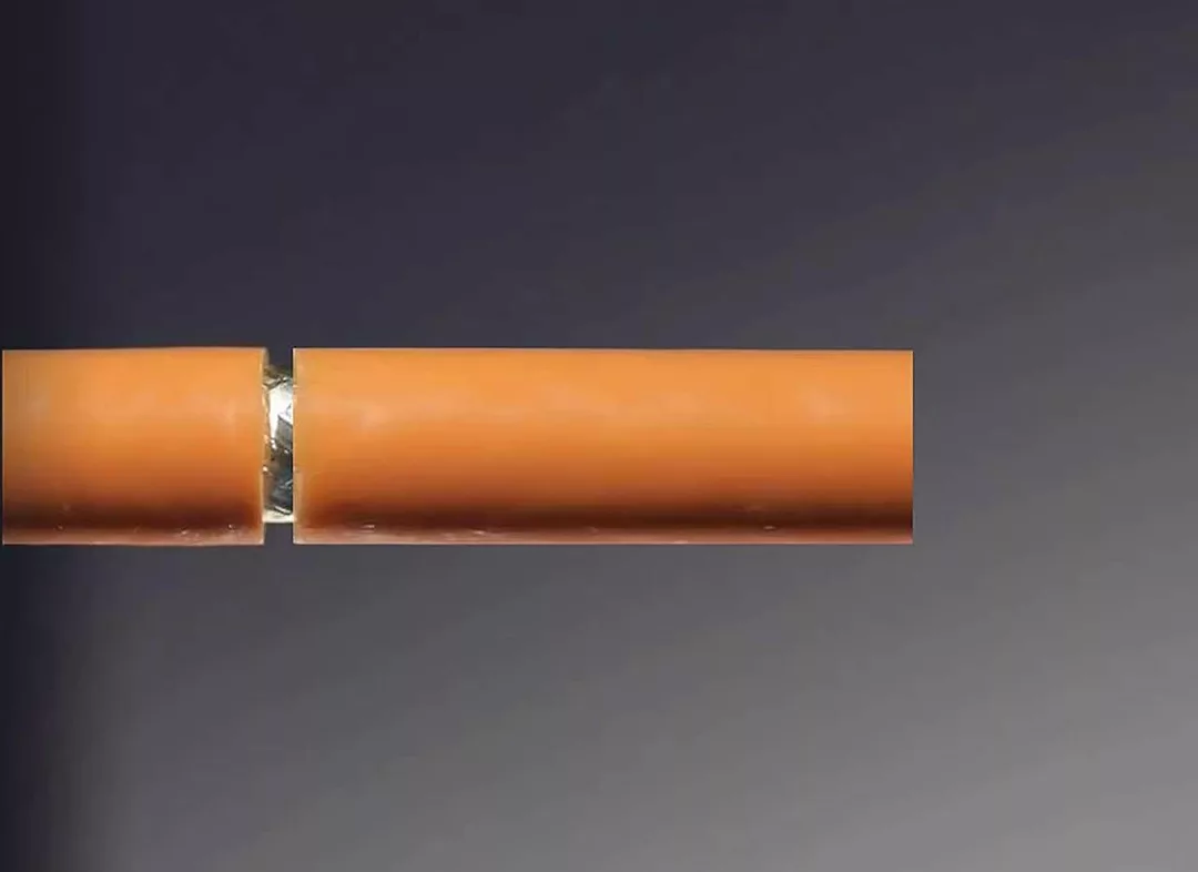

If the cable has a foil layer, it must be stripped cleanly, flush with the outer jacket with no flags remaining. This is nearly impossible with fixed blades. It is certainly possible with a laser system, unless the foil is bonded to the outer jacket. Laser systems require space for the laser to get to the foil.
However, if the foil is bonded to the outer jacket, any pulling of the slug may cause the foil to tear unevenly. Lasers will also not cut where the foil overlaps.
With rotary stripping blades, it’s possible to score the foil without pulling the slug. The jacket slug and foil can be removed simultaneously by manipulating the cable and twisting the slug as it is removed. The result is a clean foil cut that is flush with the outer jacket.

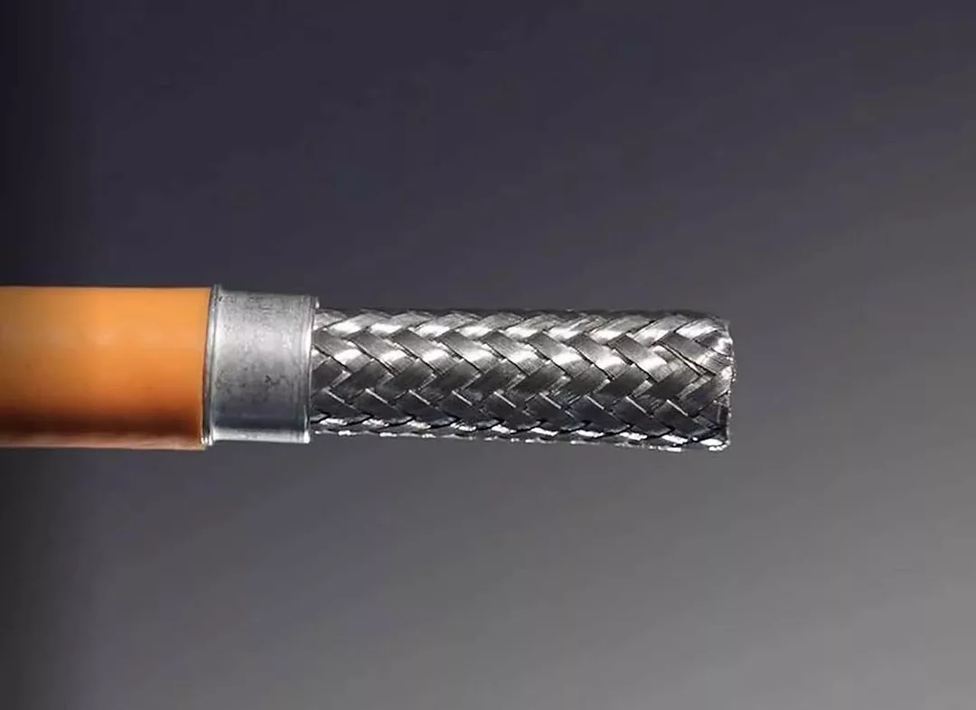

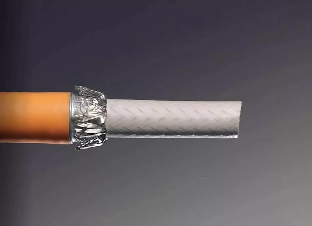

Assembling the Inner Ferrule
Loading the ferrule onto the cable is critical, but not overly challenging if done manually. However, different connectors use different ferrules. Therefore, it should be possible to change over to different ferrules with a few cable- and ferrule-specific parts. The system should also have the ability to detect if the ferrule is the correct type and if it is properly oriented on the cable.
Installing the ferrule onto the cable is a step that could be done manually to save costs, since automatic loading systems are quite expensive.
Cutting and Removing the Shield
Properly cutting the shield consistently with a traditional rotary stripping unit is very challenging for high-voltage cables, especially if the cable has nonconcentric layers or is otherwise out-of-round. The integrity of the dielectric and filler are critical for proper performance of the cable. Traditional rotary stripping machines risk damaging the inner layers.
An anvil and punch system guarantees the inner layers will not be damaged and cuts the shield cleanly and evenly, 360 degrees around the cable.
The resulting shield length will depend upon the ferrule being used, since it will be wrapped around it. The cut must be clean and consistent. Otherwise, long strands may cause shorts with other components and short strands may degrade the integrity of the ferrule crimp.
Sometimes, the shield length is longer than the length of the dielectric. These applications require the shield to be opened and folded back after it’s trimmed so that the inner layers can be stripped.
Fold Shield

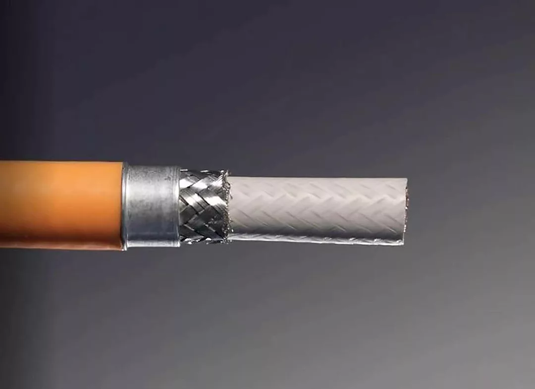

The shield gets folded back over the ferrule, but in some cases, not completely. Different connectors require different fold angles to ensure the connector fits together correctly. The fold angle may be between 90 to 180 degrees, but the fold must be even, 360 degrees around the ferrule.
The shield strand ends should fall within the specified tolerances to ensure proper performance. Strands that are too long may cause shorts and short strands might not secure the shield properly when the outer ferrule is crimped.

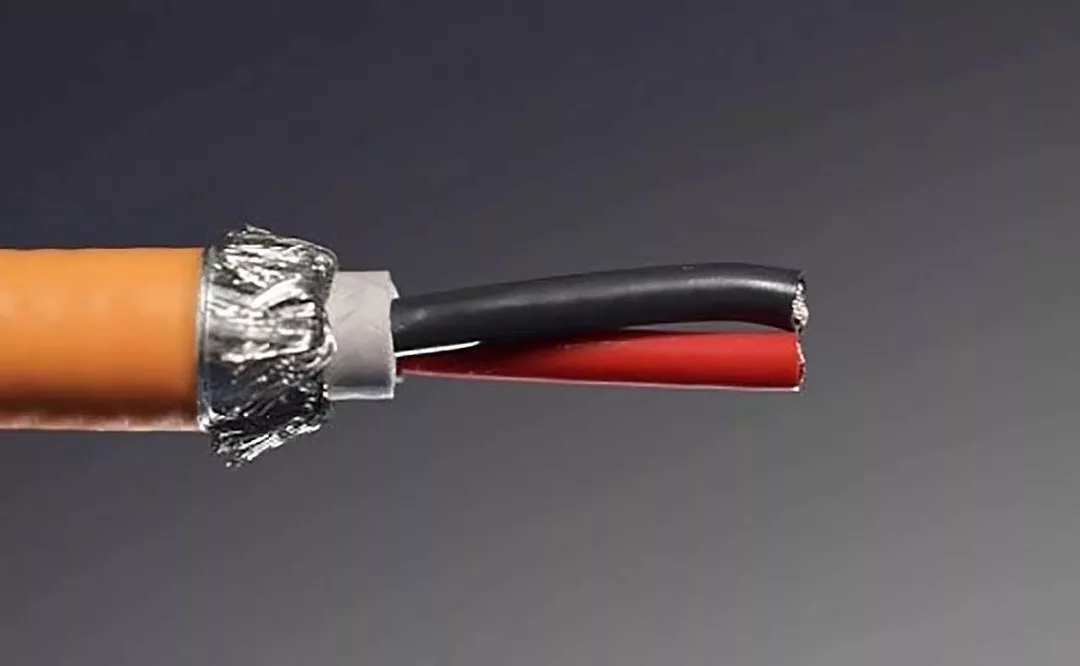

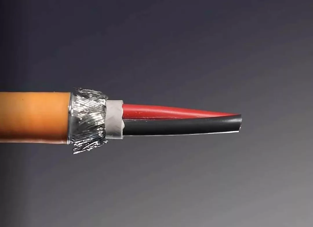

Removing Dielectric or Filler
The dielectric or filler can be removed in the same way as the outer jacket. Multiconductor cables are not allowed to have any damage to the conductor insulation.
For coaxial cables, conductor detection can play a big role in ensuring the center conductor is not damaged by the stripping blades. As with the outer jacket, the system must be able to accommodate nonconcentric cables to provide the most flexibility.

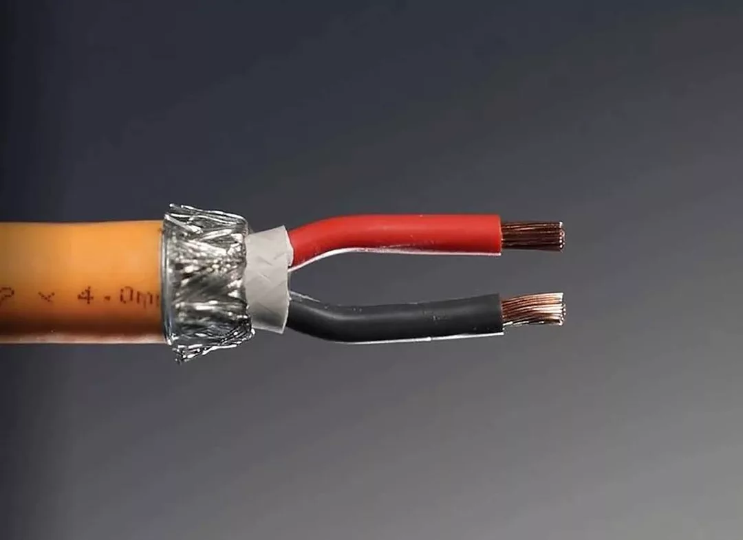

Prior to terminating multiconductor cables, the cable must be oriented properly so that polarity is correct when the conductors are plugged into the connector. Photo courtesy Schleuniger Inc.

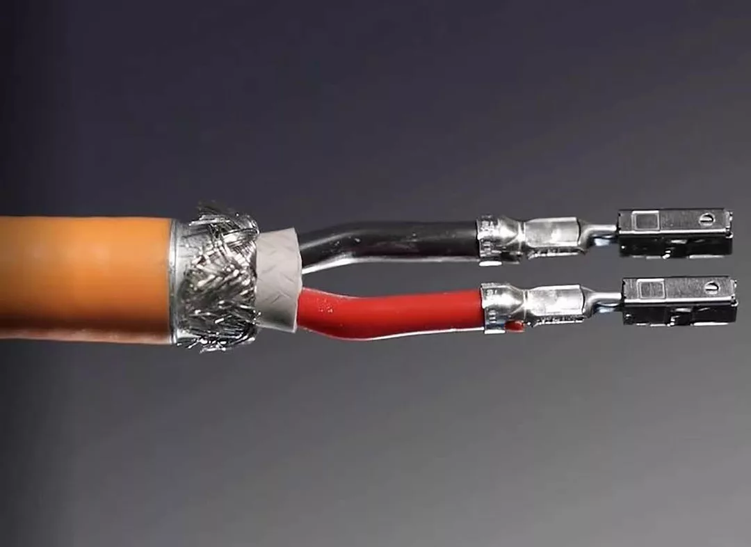

Multiconductor Orientation and Stripping
Prior to terminating multiconductor cables, the cable must be oriented properly so that polarity is correct when the conductors are plugged into the connector. Sophisticated systems must be able to recognize the wire colors and then rotate the cable accordingly without losing cable position.
Once oriented properly, the conductors are formed to enable termination according to the connector cavity pitch. After the conductors are properly formed, the ends should be stripped on a device with conductor detection to ensure the wire strands are not damaged.
Termination
Inner conductors are either crimped or ultrasonically welded to the terminals. Automation systems can integrate suitable crimping presses with crimp force monitoring systems. Ultrasonic welding systems typically have integrated monitoring to ensure a proper weld.
Automation systems that can integrate third-party systems are very convenient. They can minimize the validation process for presses and welding systems that have already gone through lengthy approval processes.
Multiconductor Connector Loading
For multiconductor cables that will be terminated and loaded into a connector, it’s critical that the wire ends and terminal positioning are consistent. This will ensure that the terminals will load and lock into the connectors properly.
