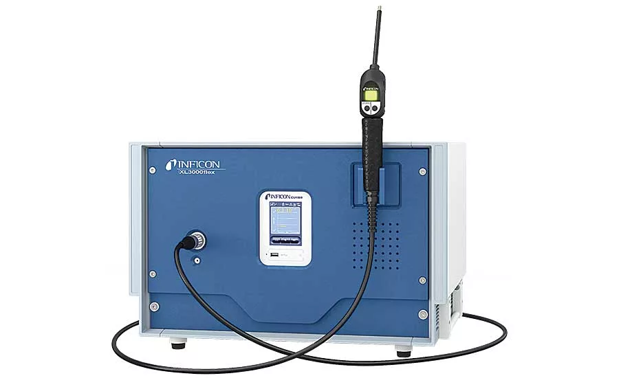

The resolution and sensitivity of the transducer can reduce test time. PHOTO COURTESY INFICON

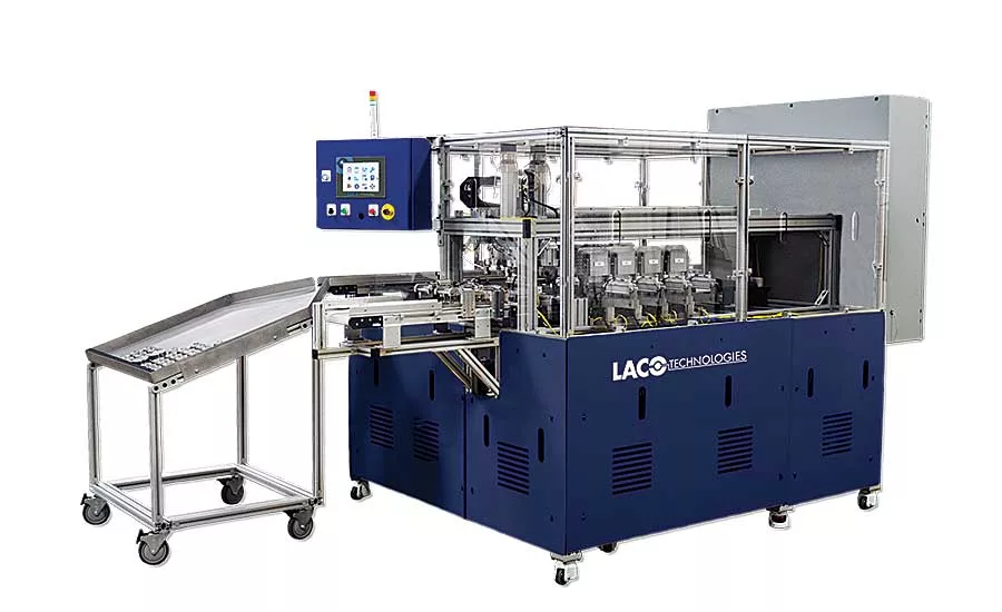

If the part’s temperature is unstable, it can cause longer test times and erroneous results. PHOTO COURTESY LACO TECHNOLOGIES INC.

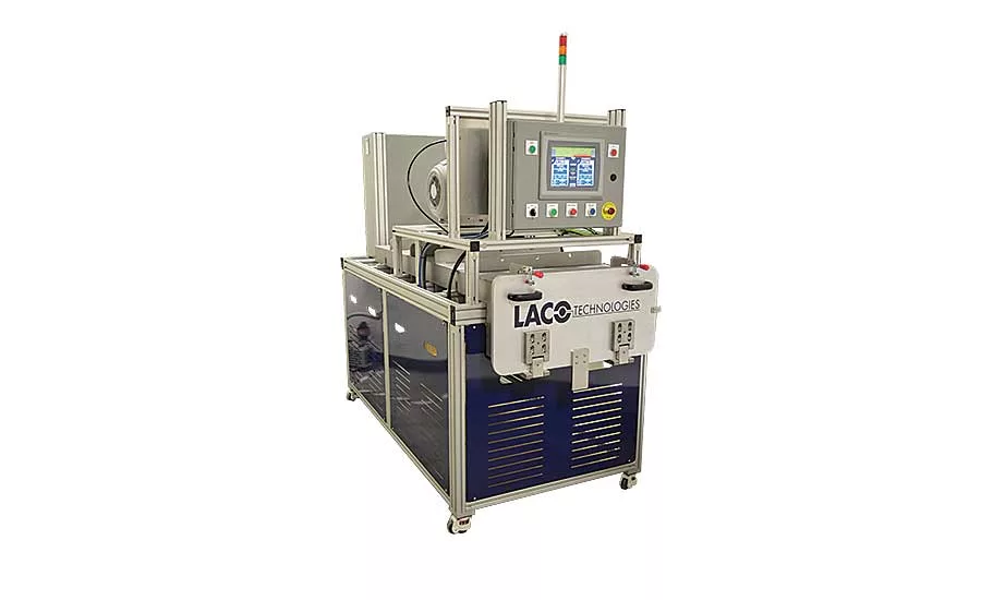

To speed up the process, know exactly what your test parameters are before choosing a leak testing method. PHOTO COURTESY LACO TECHNOLOGIES INC.

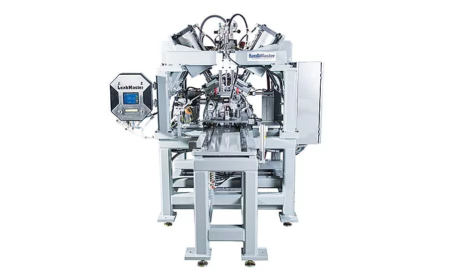

A proper seal has to prevent leaks without squishing the product or causing volume displacement. PHOTO COURTESY LEAKMASTER

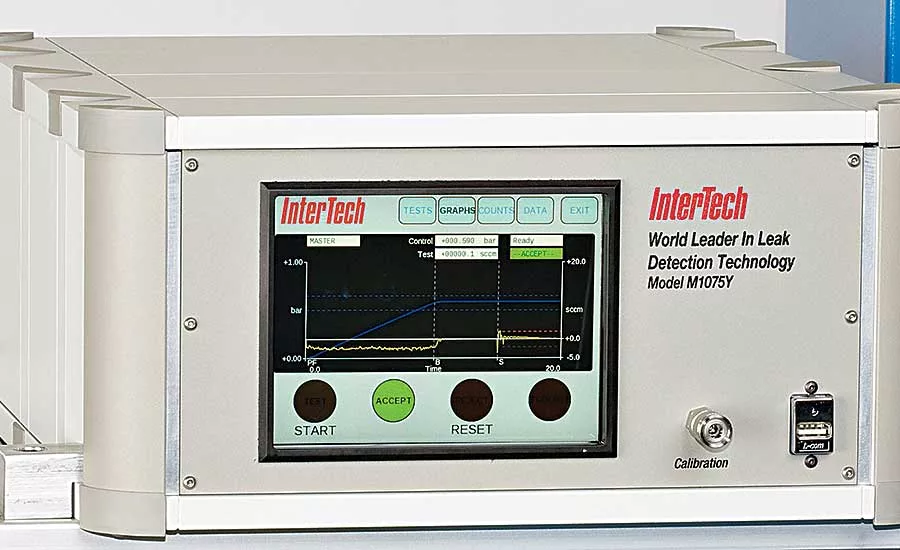

Many factors can affect how long it takes to perform a leak test, such as product volume, product material and type of leak test. PHOTO COURTESY INTERTECH DEVELOPMENT CO.

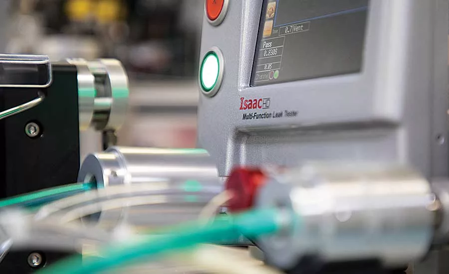

It is important for many devices to be watertight, so the person setting up the test needs to know the right air test that correlates with a water leak. PHOTO COURTESY ZAXIS INC.

According to Jacques Hoffmann, president of InterTech Development Co., many factors affect how long it takes to perform a leak test, such as product volume, product material, type of leak test, leak rate specification and temperature. These factors, alone and in combination, can add time to the leak test.

The leak testing device can also play a role in how long the test cycle takes. Having a device that can accurately detect leaks is crucial, be it the sniffer probe for tracer gas methods or a transducer for pressure decay. The more resolution you can get from a transducer, the faster you can detect pressure change, says Splete.

Properly designed seal tooling and fixturing will compensate for a lack of rigidity. Tooling that restricts flexing can minimize cycle time. In addition, proper sealing of all openings as well as the hose will minimize the time needed to pressurize the product. Parker recommends adding vacuum pumps to evacuate the part or test chamber faster, once the test have been completed.
