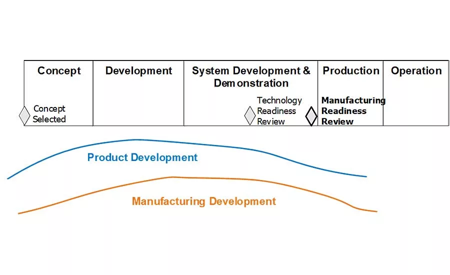

Product development and manufacturing development should happen in parallel. Illustration courtesy Defense Acquisition University
Product development and manufacturing development should happen in parallel. Illustration courtesy TWI Ltd.

Similarly, the process of developing new products also goes through levels of maturity. We start with models, then move on to prototypes, advanced prototypes, and so on, until we reach the final design.
Of course, the term product development is a bit of a misnomer. It gives the illusion that engineers are working solely on the new product. In fact, product development includes development of the supply chain and the assembly line, as well. Just as a new product evolves from model to prototypes to final design, the assembly line for that product will go through advancing levels of sophistication and capability. The goal is to learn and improve the process on the way to full-scale production.

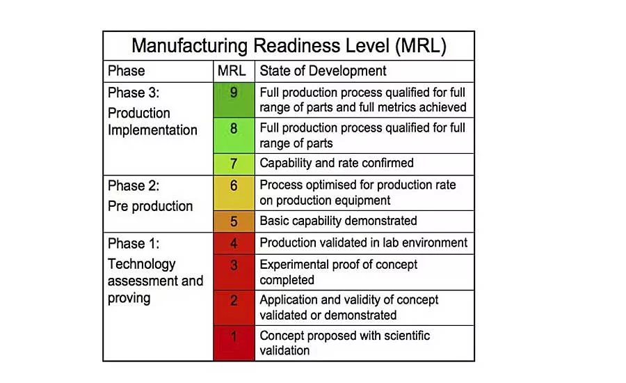

The various manufacturing readiness levels are as follows:
The early phases of manufacturing readiness consist of technology development. These are necessarily not part of manufacturing line development. Specifically, we are trying to understand the physics that might be associated with manufacturing. Is it even possible to make the product, as conceived, with current technology? It could be argued that levels 1 and 2 are strategic operations development. It is possible level 3 could be associated with a specific production line setup.
Level 1, physics basis and implications.
Level 2, concepts identified.
Level 3, proof of concept developed.
Level 4, produce concept in a lab.
Level 5, produce prototype component in a relevant environment.
Level 6, prototype system in a relevant environment.
Level 7, produce systems in a production environment.
Level 8, pilot line capability demonstration (trial production run).
Level 9, low-rate production demonstration (trial production run).
Level 10, full-rate production demonstration in place (run at rate).

The design maturity and the manufacturing line maturity overlap. Very early prototype parts will likely have nothing to do with the eventual assembly line. For example, early parts might focus solely on the dimensional attributes of the product. These can be 3D printed without any need for a manufacturing line. Indeed, early prototypes could simply be cardboard representations. Whatever we can do to learn quickly and adequately is fodder for exploration.
As we develop the assembly line, the new product design will become more refined, and the product will incrementally gain more features and functions. We will have part drawings in various iterations. We will know the results dimensional and fitment checking. We’ll know the results of various designs of experiments to determine process parameters.
