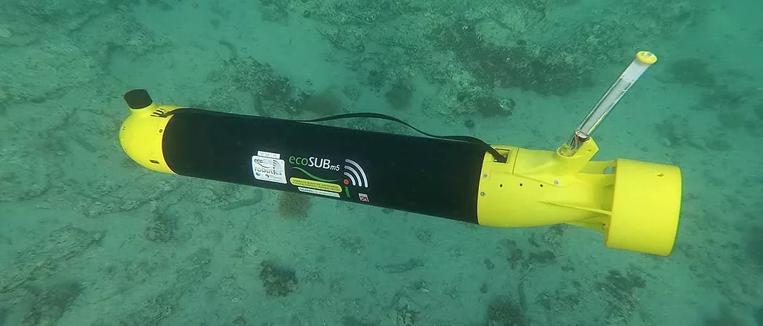

Our customers have learned this first-hand. For example, ecoSUB Robotics used AM to maximize efficiency and reduce costs per part. In addition, the company has benefitted from the ability to customize designs for individual clients.

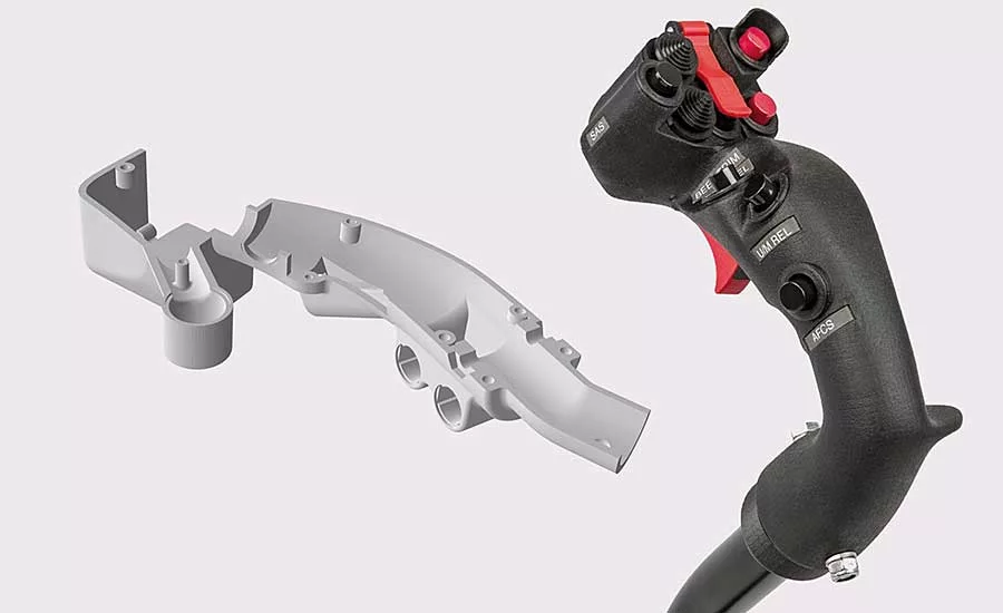

Komodo Simulations developed realistic control systems for its line of helicopter flight simulators for home and professional use. In the past, these control systems consisted of many parts made with traditional manufacturing methods. We showed the company how to use AM to print the assembly as a single part, which reduced costs significantly. In addition, AM allowed for hollowed-out internal parts and little or no limitation on the design of complex curved parts. The capability to produce high surface detail also means that textured grip surfaces can be included in the design.
