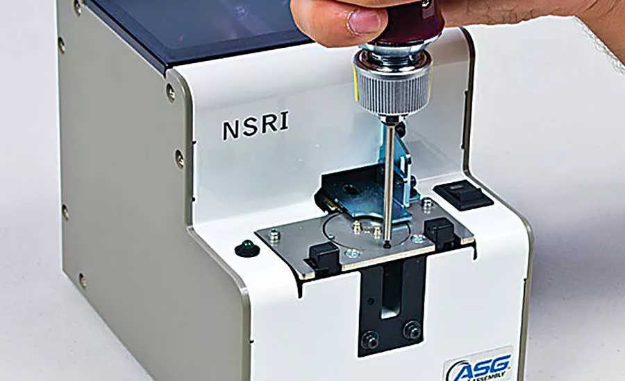

Benchtop screw presenters are popular for many screwfeeding applications. Photo courtesy ASG, Division of Jergens Inc.

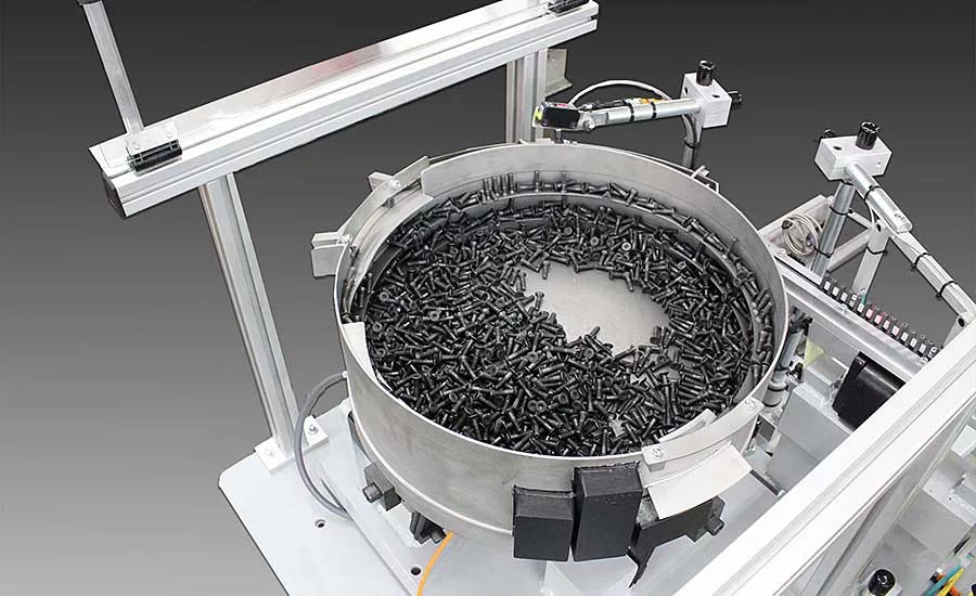

Vibratory bowl feeders are typically used for high-volume assembly applications. Photo courtesy Performance Feeders Inc.

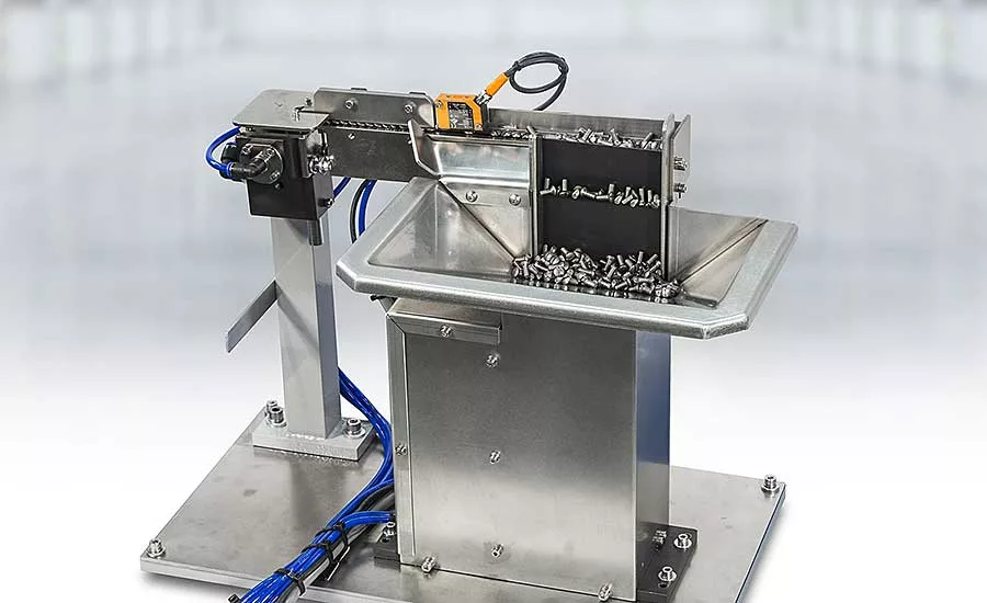

Step feeders are ideal for larger and heavier fasteners. Photo courtesy Performance Feeders Inc.

Another option is to use a step feeder. “However, they traditionally operate with a slower output rate,” says Neff. “Step feeders are usually used to feed larger and heavier fasteners, such as an M8 screw or larger.”

“Vibratory bowl feeders are still popular, because you can accommodate a wide range of fasteners,” says Emanuele. “They are ideal for applications that require high production rates and they come in many different sizes.
“However, bowl feeders can be noisy,” warns Emanuele. “They’re not too flexible and are typically set up for a particular type or family of screws.”

Screw presenters place a fastener at a pickup point so that the operator can insert a magnetic bit and engage the screw. The operator does not have to handle fasteners, which reduces waste from lost fasteners and improves quality by eliminating the chance of a dropped fastener entering the assembly.
As soon as the screw is removed from the pickup point, the presenter advances another screw, so the next screw is available as the screw is being driven, which reduces cycle time.
