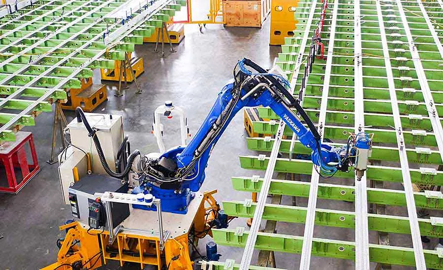

Reinforcing the floor structure of passenger aircraft to accommodate heavier payloads, is one such labor-intensive process. It involves drilling thousands of holes. To accomplish this task, Singapore-based ST Engineering Aerospace Ltd.—a specialist in aircraft conversion—relies on a robotic cell. ST Engineering worked with Helios Applied Systems, also based in Singapore, to design and build the cell.

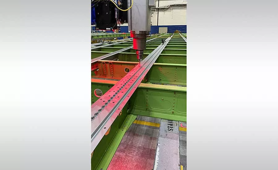

The robotic cell drills dozens of holes in the floor grids of Boeing’s 767-300ER aircraft at ST Engineering’s plant near Paya Lebar to convert it into a freighter in accordance with Boeing’s standards. To do this, the cell moves along the floor structure, allowing the robot to drill holes according to a predefined plan. The cell is located in a hangar that is conveniently adjacent to the converted aircraft. The cell consists of a moving platform with a hydraulic lift, a six-axis robot with a 180-kilogram payload, an end-of-arm tool with a special image processing system developed by Helios, a motor spindle with 6 kilowatts of power, and a hollow shank taper fixture for automatic tool changing.

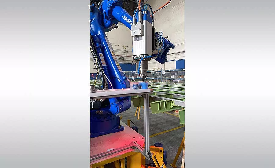

In addition to parameters such as concentricity and high speeds, the most important prerequisite for selecting the right spindle was the possibility of easily adapting it to the existing robot by means of a tool changer. Helios found what it was looking for with automation specialist Zimmer Group of Rheinau, Germany.
Zimmer has 13 branches worldwide, three of which are in Asia. Zimmer supplied Helios with its HF145-001 series air-cooled spindle, which has a power rating of 6 kilowatts and a maximum speed of 24,000 rpm. The spindle comes complete with an EtherCAT operating terminal, cables and frequency converter. The spindle is particularly suitable for precise positioning tasks with integrated safety technology. It works equally well in operations at low or high speed. The inverter offers optimum power output with perfect coordination of the spindle.
To be more flexible for future applications, the spindle was mounted directly on a tool changer, also from Zimmer. The tool changer allows the spindle to be exchanged for another tool or handling unit, so the robot can accomplish more than one task. In addition to the tool changer, Zimmer supplied a storage station for the various tools.
Zimmer supplied the spindle with a fieldbus connection (EtherCAT) and also handled the parameterization of the unit. Zimmer also helped Helios during installation and has provided technical support during operation.
“Due to the rigid design and the very smooth running of the spindle, even at higher speeds, the drilling result is very good. You have to keep in mind that these parts are light and not completely flat, so the vision system detects the position and angle of each hole,” says Sunil Raibagi, project manager and vice president of business development and strategy at Zimmer.
