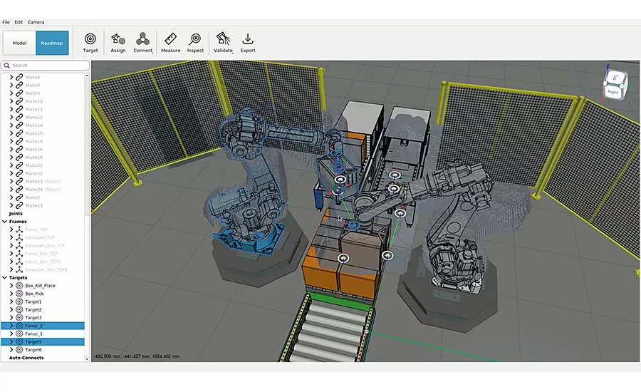

New software simplifies programming and speeds up deployment time. Illustration courtesy Realtime Robotics Corp.

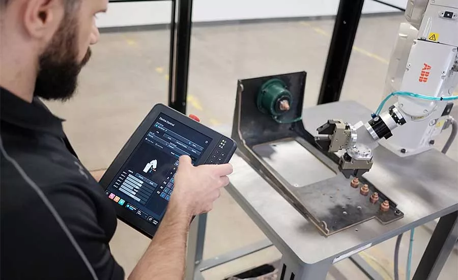

“Third-party programming software is designed to be agnostic to robotics hardware, meaning it can be used on most, if not all, industrial robots [marketed] by major brands,” says Lian Jye Su, robotics research director at technology intelligence firm ABI Research Inc. “Traditional robot software tends to very low level and requires high technical skills.
“Third-party software allows end users to program and simulate the behavior and movement of an industrial robot on a very user-friendly interface,” explains Su.

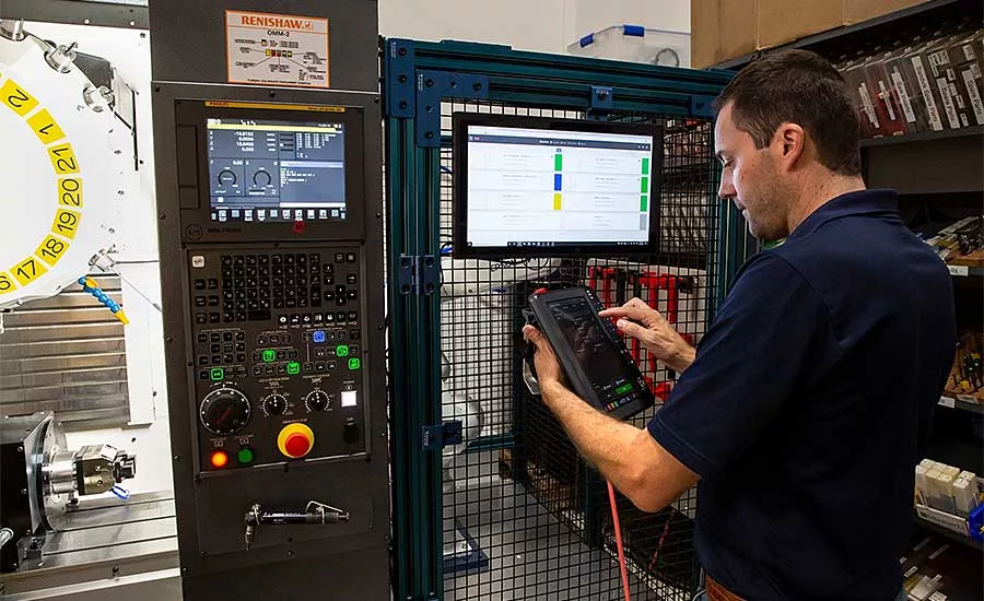

“In the past, many companies were stymied by the complexity of traditional programming,” adds Benjamin Gibbs, CEO of Ready Robotics Corp., which has developed an open, cross-brand operating system for industrial automation called Forge/OS. With support for ABB, Epson, Fanuc, Kawasaki, Stäubli, Universal Robots (UR) and Yaskawa robots, it offers a single programming interface for hundreds of machines and peripherals.
“Today, open systems make it more cost-effective to use robots in high-mix production environments,” claims Gibbs. “Several developments have helped push this idea forward. One is the advent of Industry 4.0 technology, which has forced robot vendors to open up their platforms.
“Another was the debut of the robot operating system (ROS), an open-source system that was developed 15 years ago,” notes Gibbs. “However, ROS typically works better with automated guided vehicles and autonomous mobile robots rather than robot arms.

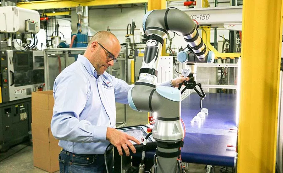

“In addition, the growing popularity of UR’s collaborative machines has helped spur new developments,” claims Gibbs. “It has led to a big increase in easier-to-use programming techniques.”
“Companies like UR have opened up their application programming interface (API) to allow third-party companies to develop directly onto their software,” adds Tyler Bouchard, CEO of Flexxbotics, which markets a cloud-based manufacturing management software platform that’s used by companies such as Abiomed, Boeing, Northrop Grumman, Sub-Zero and Toyota.
“They have created a robot company that sits on a platform,” says Bouchard. “The platform has accelerated innovation within robotics, giving manufacturers access to more application-based solutions.”

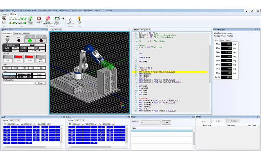

“[Engineers today] are looking for tools to make programming easier,” says Ryan Guthrie, executive vice president of TM Robotics (Americas) Inc., the American and European distributor of Shibaura (formerly Toshiba) Machine robots. “There is less and less interest in having to script out code. Customers want precanned, packaged, plug-in, drag-and-drop tools.
“They don’t want to think about code at all,” notes Guthrie. “They want to be able to modify robot programs without having to even look at or understand the code.
“Most third-party apps that we have come across were developed to address specific needs,” adds Guthrie. “When a robot leaves the factory, we do not know if it is going to be packing chocolates, welding an auto body, gluing together battery cells for an electric vehicle, assembling electrical components or being used in a laboratory that is developing a cure for a disease.”
Robot manufacturers need to develop generic software that works for all these cases, and as such, they can’t possibly know what types of details or functions might be needed for specific applications.
However, third-party apps can be used to take the flexibility of the robot and really dial it in and tune it to the niche production task a specific end user may have in mind.
Guthrie says the push to make programming easier is not a new concept. “The idea of canned libraries and drag-and-drop code is something that has always been there,” he points out. “What is changing is processing power and the overall general knowledge of integrators.

For instance, Ready Robotics recently released Version 5.3 of Forge/OS. It unites all the hardware in a robotic workcell under a single user-friendly programming platform. In doing so, the operating system makes automation accessible to any manufacturer and any operator, with no experience necessary.
Forge/OS provides a hardware-agnostic software layer that controls robots and related automation hardware from leading brands through a common set of APIs. Using those APIs, Ready Robotics has built a suite of low-code apps designed to make it simple for non-engineers to program and manage robotic cells.
“Manufacturing has been held back for decades by software silos between robot vendors,” claims Gibbs. “We’ve broken down those barriers with a standard interface that simplifies deployment for enterprises and dramatically increases the market opportunity for the automation industry.
“For factory workers, that interface is a no-code tablet which allows them to upskill to become a robot programmer within weeks,” explains Gibbs. “For software developers, it’s a standard API that unlocks data streams from over 3 million compatible robots deployed today.”

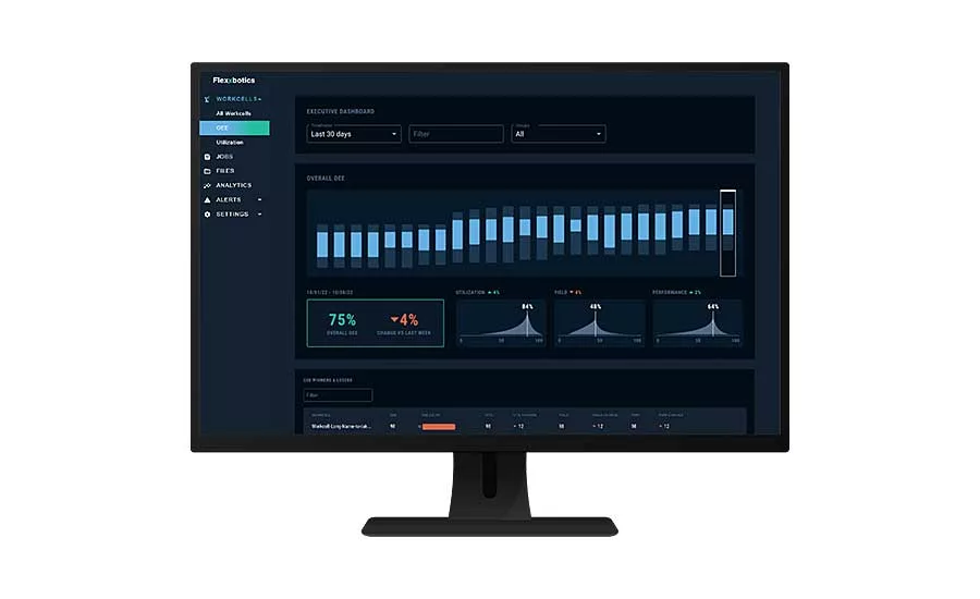

Flexxbotics just launched FlexxConnect UR, a continuous improvement platform that empowers discrete manufacturers to easily manage their collaborative robots and maximize performance.
It provides instant access to contexualized data and intelligence, enabling engineers to fully optimize and continuously improve cobot performance. The platform also gives simple, step-by-step instructions that enable a quick transfer of ownership of cobot workcells to operators, upskilling the existing workforce.
“FlexxConnect enables the instantaneous transfer of both job intelligence and robot data digitally between the workcell and back office business systems,” says Bouchard. “The platform is revolutionizing the way jobs are being built, dispatched and executed. [It saves] manufacturers time, reduces changeover tasks and empowers the entire workforce to do more with less.
“Digital transformation can be a daunting task,” Bouchard points out. “We break it into pragmatic, digestible steps so manufacturers can trial different approaches to maximize their business outcomes.
“A robot’s life cycle can be split into three distinct buckets: design, deploy and operate,” explains Bouchard. “FlexxConnect focuses heavily on the operating portion, which is the longest aspect of a robot’s life cycle.”

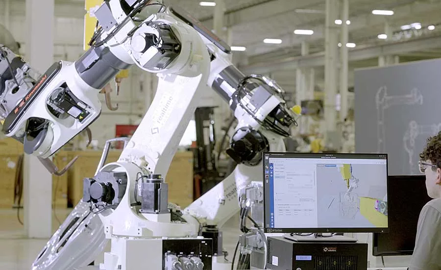

Earlier this year, Realtime Robotics unveiled RapidPlan software, which simplifies programming and speeds up deployment time. It choreographs all robot movements and removes the need for brand-specific robot programming.
Cell modeling, task planning, programming and operations are all handled within the same workflow tool. The motions in simulation and as-built reality match, dramatically speeding up the design and deployment processes.
“Optimizing the efficiency of your factory operations should not be held back by technical barriers,” says Konidaris. “We specifically designed RapidPlan to deliver an accurate simulation of robot task planning, making it easy to program models and use them directly on the factory floor, but did so in a way that streamlined the process and made the technology easy-to-use for all.
“Our software functions as the basic physical intelligence that robots should have, but don’t,” explains Konidaris. “It allows robots to autonomously generate their own motion, rather than having to specify each and every movement by hand, at the individual joint level. The programmer simply tells the robot where its business-end needs to be and our software handles the rest. Each robot generates its own highly performant motion that never collides with the environment or any other robot.
“This unlocks immense value, because suddenly building a 12-robot workcell is just a matter of specifying goals for 12 robots,” claims Konidaris. “Existing technology is more like choreographing a 12-dancer ballet in a small, dark room. Our [system] makes development faster and easier.”
