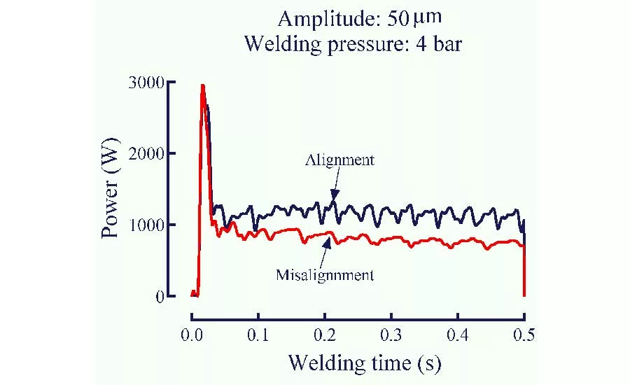

In the case of misalignment (top), less welding energy is generated in the area to be welded. Conversely, if the tooling is aligned (bottom), the welding energy is large since the area that the horn is contacting is relatively larger. Illustration courtesy Monisys Co. Ltd.
This graph compares the power signals of misalignment and alignment under the same welding conditions. It verifies that when the tooling is properly aligned, the weld energy applied to the joint is higher and therefore the weld will be stronger. Illustration courtesy Monisys Co. Ltd.

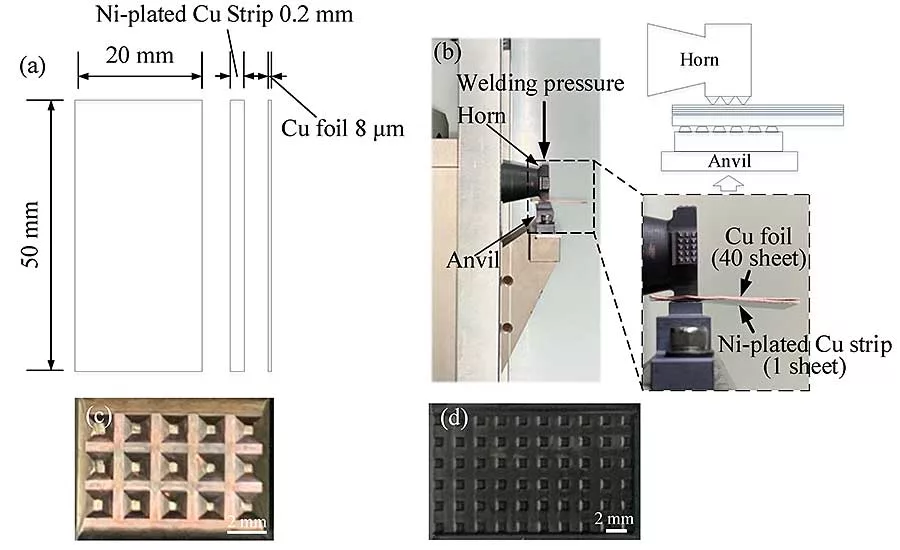

The test specimens for our study consisted of a multilayer copper foil (99.99 percent pure copper), 8 microns thick, and a nickel-plated copper strip, 0.2 millimeter thick. Both the foil and the strip were 20 millimeters wide and 50 millimeters long.

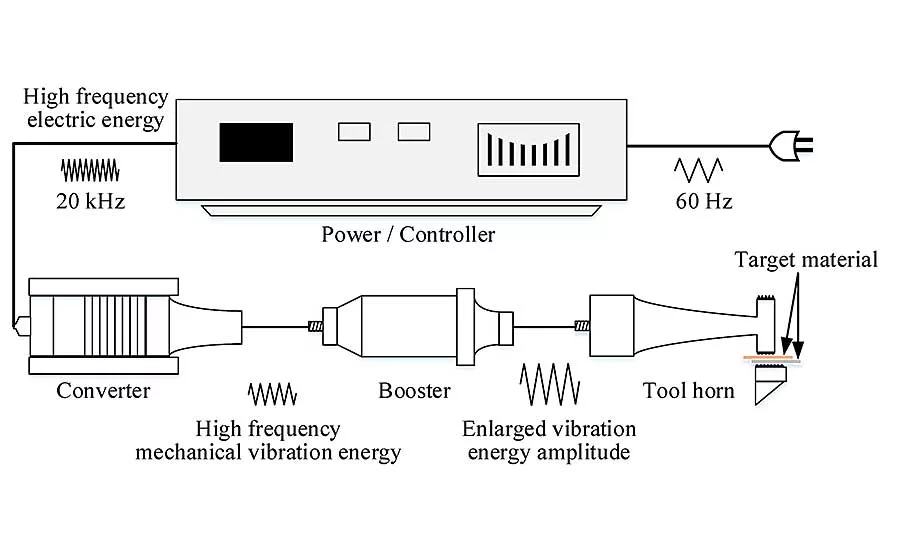

The ultrasonic welder provided a maximum output power of 3 kilowatts and an operating frequency of 20 kilohertz. Welding was performed by placing one nickel-plated copper strip on the anvil side and 40 layers of copper foil on the horn side.

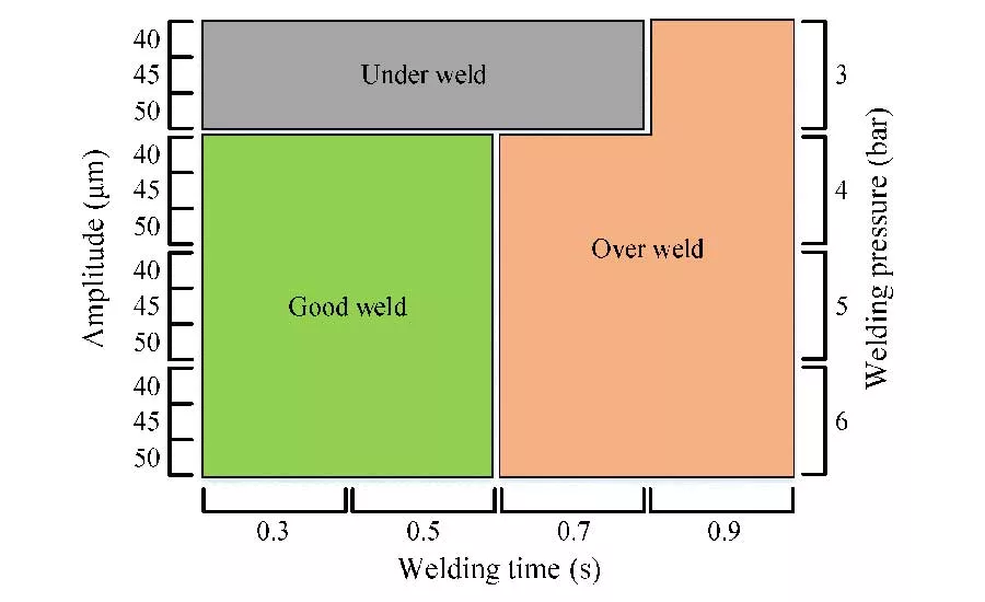

The UMW process variables included time, amplitude and force. Time was set at 0.3, 0.5, 0.7 or 0.9 second. Peak-to-peak amplitude was 40, 45 or 50 microns. Force was set at 3, 4, 5 or 6 bar.

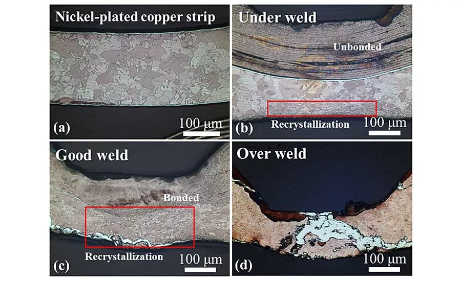

For the purposes of our study, joints were classified as being under-welded, good or over-welded. An under-welded joint produced a maximum T-peel load of less than 40 newtons and showed interfacial fractures. In the case of good welds and over-welded joints, interfacial fractures were not seen. Both good joints and over-welded joints demonstrated a T-peel load of 40 newtons or more. However, the results for over-welded joints were inconsistent, and the foil color was changed. The latter could be an indication that the foil’s properties, such as electrical conductivity, have been adversely affected.

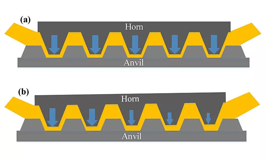

If the horn and anvil were misaligned, wrinkles were observed on the weld surface, and the weld cross-sectional shapes showed left-to-right asymmetry. Few wrinkles were observed if the horn and anvil were aligned, and a left-to-right symmetric weld was formed. The welded area was narrower with misaligned tooling than with aligned tooling.
When the tooling is misaligned, the weld tends to fracture between the nickel-plated copper strip and the copper foil. When the tooling is aligned, the fracture is observed only in the copper foil and not in the weld. Therefore, we infer that the fracture is in the copper foil and not the weld, because the strength of the weld is greater than that of the copper foil.
In the case of misalignment, since the horn is asymmetrically set up, less welding energy is generated in the area to be welded. Conversely, when the tooling is aligned, the welding energy is large since the area that the horn is contacting is relatively larger.

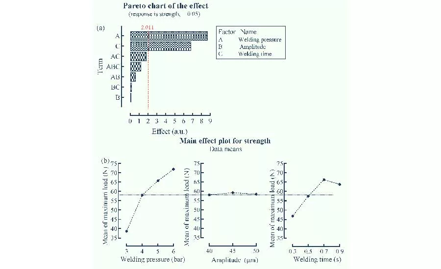

Weldability evaluation was performed without misalignment of the horn and anvil. The experimental conditions were repeated twice with a full factorial design with welding force at four levels, amplitude at three levels, and welding time at four levels.
Our results indicated that average weld strength increases with the increase in welding force, but weld strength is not significantly affected by the amplitude. Additionally, the highest average weld strength was obtained at a welding time of 0.7 second.
Under-welded joints were mostly observed at a welding force of 3 bar. High-strength welds were obtained at a welding time of 0.9 second, but were classified as over-welded joints because of the discoloration of the foils due to the high welding energy. Good welds were produced at welding forces of 4 to 6 bar, and at welding times of 0.3 and 0.5 second. Additionally, the over-welded joints were observed at all welding force levels and at welding times of 0.7 and 0.9 second. Therefore, we concluded that weldability can be ensured at a welding force of 3 bar or more and a welding time of 0.5 second or less.

Cross-section analysis verified our determinations of under-welded, over-welded and good joints.
With under-welded joints, cross-sections show an unbonded region in the weld where the horn knurl is engaged with the anvil. This is observed at low welding forces and short welding times.
With over-welded joints, thinning is observed in the weld where the horn knurl is engaged with the anvil, and cracks exist on the slope of the outer sheets. These two phenomena reduce weld strength. Additionally, we infer that the thinning and cracking are caused by the excessive energy applied to the joint. These defects are not observed in good welds.
FE-SEM analysis revealed that the nickel-coating on the strip has a distinctly continuous interface in under-welded joints, which indicates that there is no metallurgical bond between the foil layers and the strip. In the nickel layer, the coating is observed all the way to the top of the weld in over-welded joints, which is considered as a driving force for the occurrence of thinning due to excessive plastic deformation. The nickel layer exists discontinuously by pushing and moving down to the lower part of the weld in a good weld, indicating that there is a metallurgical bond between the foil and the strip.

  • Alignment of the horn and anvil are important for weldability.
  • Amplitude was almost unrelated to joint strength, but welding force and welding time correspond with weld strength.
  • The best welds were produced at a welding force of 3 bar or higher and a welding time of 0.5 second or less.
