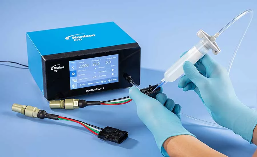

Waste can vary based on the type of material being dispensed, the size of parts and even the type of industry. Photo courtesy Nordson EFD

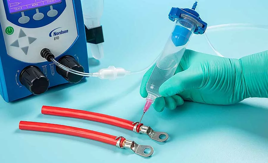

Handheld tools are ideal for dispensing adhesives, fluids and pastes on delicate parts that require a high degree of touch. Photo courtesy Nordson EFD

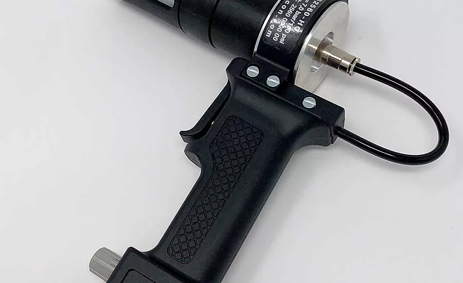

Some operators prefer the look and feel of pistol-grip dispensers. Photo courtesy Techcon Systems

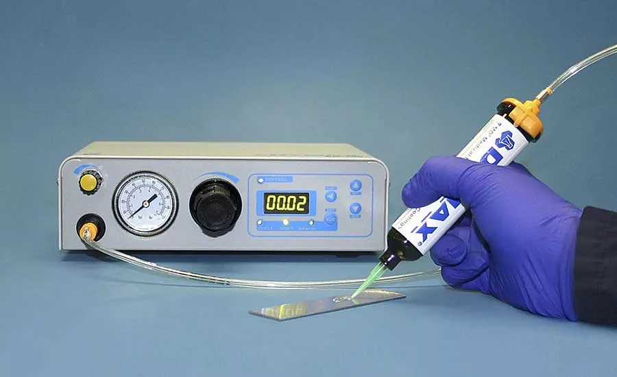

Operators don’t always utilize all of the functions of a handheld dispenser. Photo courtesy Dymax Corp.

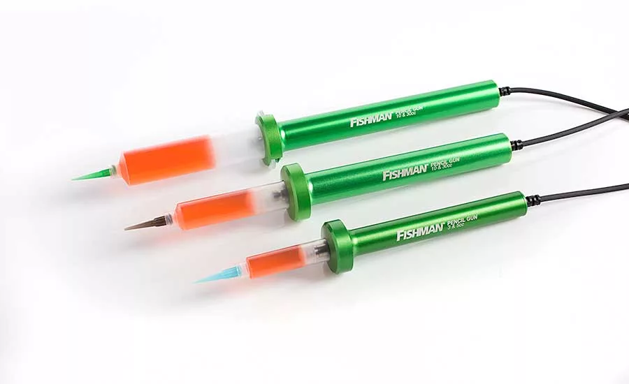

Dispensing pens are suitable for manually dispensing continuous beads or applying dots of low-viscosity fluids in noncritical applications. Photo courtesy Fishman Corp.

Handheld tools are ideal for dispensing adhesives, fluids and pastes on delicate parts that require a high degree of touch. Assemblers working in tight or confined spaces also rely on manual dispensing equipment.

Dispensing pens are suitable for manually dispensing continuous beads or applying dots of low-viscosity fluids, such as cyanoacrylates, in noncritical applications.

Operators don’t always utilize all of the functions of a handheld dispenser. “I’ve been in many different facilities where I walk along an assembly line and see all of the operators using dispensers set in the ‘manual’ mode vs. the ‘time’ mode,” says Muccino.
“With the latter, you can set parameters such as pressure and dispense time,” explains Muccino. “With the former, the operator controls how much material they apply. Assemblers keep their foot on the pedal until they think they’ve dispensed enough fluid or paste. Essentially, it’s a glorified manual process similar to using a hand syringe, a squeeze bottle or a toothpick.
“When I inquire about this type of situation, the answer I usually get from supervisors is ‘our operators like to have control over how much they apply,’” notes Muccino. “However, if they don’t utilize all of the features that a dispenser has to offer, that’s actually counterintuitive. It defeats the reason why most manufacturers purchase a dispenser—to provide the precision and control necessary for an assembly application.
“The manual mode can lead to waste and excessive fluid application,” warns Muccino. “The more excess you apply, the longer it takes a joint to harden and cure, which can affect process time and throughput. It can also lead to quality issues due to rejected parts.”
