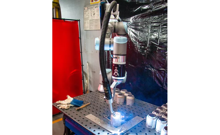

The Cobot Welder has become a way to brand the company. “If I bring the vice president of one of the most prestigious boat builders in the world here for a tour, I’m going to make sure we stop by the cobot and he sees it running, as it really opens up their eyes. People like to see the technology; it makes an impression,” says Montes.
Photo courtesy Universal Robots

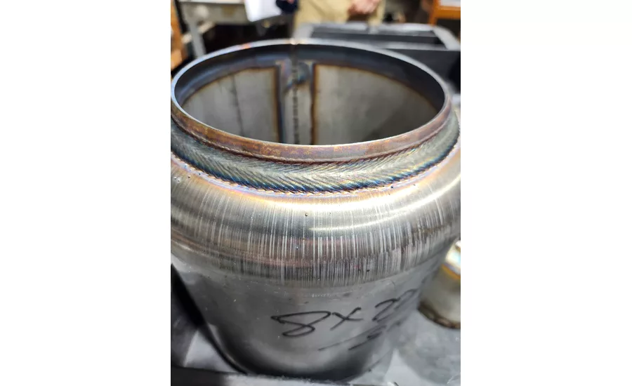

The cobot welds parts as good or better than skilled manual welders.

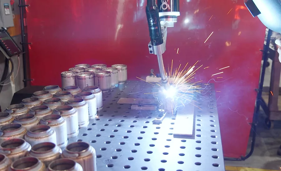

Nobody at DeAngelo had experience with robot programming before the arrival of the Cobot Welder. “We still have World War II era machines running every day on our production floor,” says Montes. “So just the thought of a ‘robot’ would be enough to send some of our folks to a therapist. But, the ease of use is truly remarkable. Within 20 minutes of uncrating our cobot, we were running parts.”

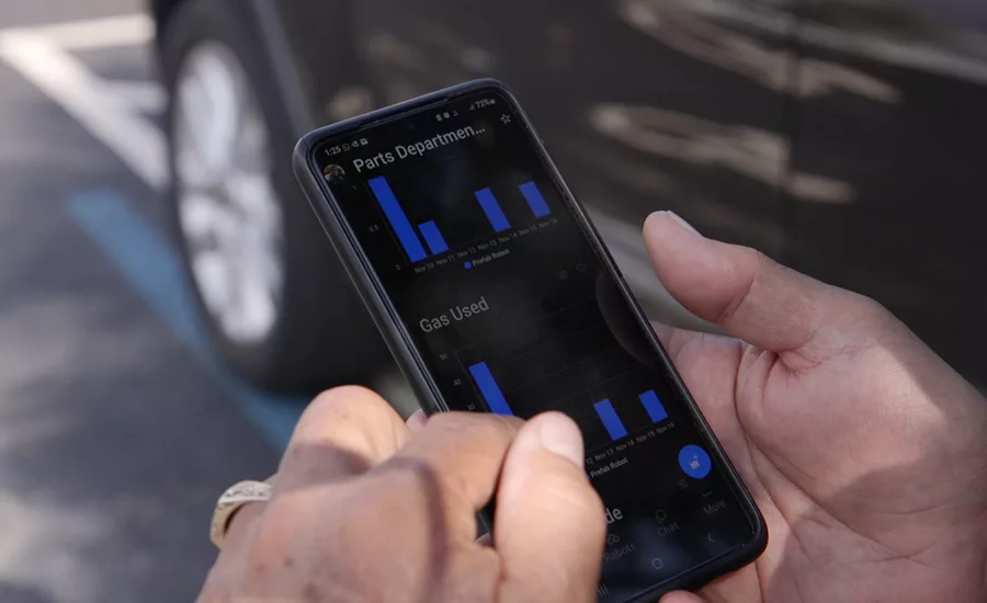

The Cobot Welder’s Beacon app provides production data in real time.

UR referred Montes to welding partner Hirebotics, a company that has incorporated UR’s collaborative robots into the “The Cobot Welder:” a complete system that includes the UR10e cobot arm equipped with a welding torch, the Beacon app for teaching, a welding power source, and a versatile welding table to perform high-quality welds on a variety of workpieces.

The Cobot Welder quickly enabled the company to catch up on lead times and reduce defect rates. “We went from being eight weeks over capacity back to baseline in a matter of days,” says Montes.
He attributes this accomplishment to the speed of the cobot that MIG welds 20 inches per minute compared to the 2 to 5 inches per minute when TIG welded manually. Montes runs his hands over a weave weld done by the cobot and says, “Any welder worth his salt would have a hard time believing this is a MIG weld. Once the operators started toying with the settings, we realized we could get the welds to look however we wanted them to: fat welds, skinny welds, butt joints, lap joints—we are even building fixtures to do seam welding. He also emphasizes the ability to dial-in the cobot to do full penetration welds.
“This was a very big concern for us. A leak could literally sink a $100 million yacht. But we have found no leaks by the cobot,” he says.

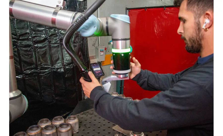

Though he had no prior robotics experience before the Cobot Welder arrived, the production manager is now the one teaching the operators how to run it. “The programming is not hard; our operators pick it up so fast,” he says.
As Montes put it, there was “no more writing 10-page programs in G-code or yearlong learning curves.” Instead, operators teach the robot simply by grabbing the robot arm and moving it through the desired weld trajectory, adding way points in Beacon, the Cobot Welder’s app-based interface that runs on any handheld device or tablet. “If you want to weld a circle, press circle, click three points—it knows that it needs to weld a circle along those three points. You want to do a line? Two points, it’s that easy,” explains Montes, who is working on fixtures that will enable the Cobot Welder to weld 25 to 50 products in the same cycle.

A Six Sigma black belt and a self-professed “numbers nerd,” Montes emphasizes the production data provided by Hirebotics’ Beacon app. “I have access to all my production data anywhere in real time through the app,” he says. “Everything is a number; we can see how long the arc was on, how much gas and wire we used. And if it looks like Shift A is more profitable because they ran faster, we can copy those settings over to Shift B.”
