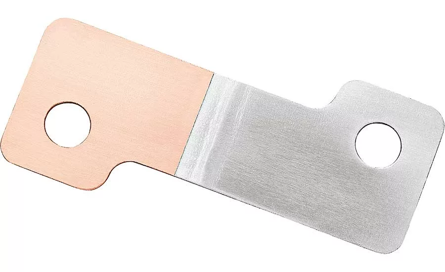

copper and aluminum bus bar
This copper and aluminum bus bar was assembled with magnetic pulse welding. Photo courtesy PSTproducts GmbH

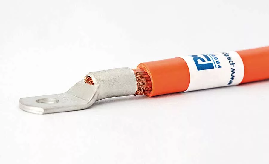

Magnetic pulse welding
Magnetic pulse welding can attach heavy-duty terminals to thick cables with high compression, high strength and low resistance. Photo courtesy PSTproducts GmbH

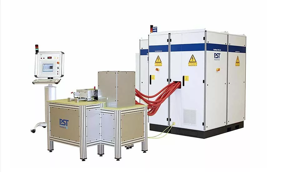

A typical magnetic pulse welding system
A typical magnetic pulse welding system includes a power supply, which contains a bank of capacitors, a high-speed switching system and a coil. Photo courtesy PSTproducts GmbH

The electric vehicle revolution is posing numerous assembly challenges for engineers, such as how to join dissimilar metals and how to attach large terminals onto thick cables. Ironically, a century-old technology, magnetic pulse welding (MPW), could be the answer to these problems.
A noncontact process, MPW uses electromagnetic pressure to accelerate one metal part to produce an impact against another metal part. The atomic bond created by this process is similar to the bond created by explosion welding. The technique can be used to join both similar and dissimilar metals.

A typical magnetic pulse welding system includes a power supply, which contains a bank of capacitors, a high-speed switching system and a coil. The parts to be joined are inserted into the coil, the capacitor bank is charged and the high-speed switch is activated. As current is applied to the coil, a magnetic field is created, and the outer component is collapsed over the inner component.
A significant amount of energy (5 to 200 kilojoules) is stored in the capacitors, which are charged to a high voltage (3,000 to 30,000 volts). The capacitors are then discharged through low-inductance and highly conductive bus bars into a coil that is custom-made for the assembly. The resulting current takes the form of a damped sine wave. Peak currents during this process range between tens of thousands and millions of amperes, with pulse widths measured in microseconds.
This creates an extremely intense transient magnetic field in the vicinity of the coil. The magnetic field induces eddy currents in any conductive materials nearby, in the opposite direction to the primary current. The opposing fields in the coil and workpiece result in a high repulsion force. This force drives the workpiece closest to the coil at high velocity toward the target, the stationary workpiece, resulting in a high impact between the two metals.
The impact pressure drives away surface contaminants and oxides on the parts and provides intimate contact across the joint interface, creating a solid-state bond without melting the materials. There is no heat-affected zone, and the purity of the metals, on the surface and below the surface, is preserved.
As a result, the process is particularly suitable for joining dissimilar metals, such as copper and aluminum, since little or no intermetallic compounds are created. The joint is gas-tight and stronger than the parent materials.

The MPW process has numerous applications for EV assembly, such as bus bars and battery housings. It can attach heavy-duty terminals to thick cables with high compression, high strength and low resistance. The process can accommodate cables with a cross-section of up to 400 square millimeters.
