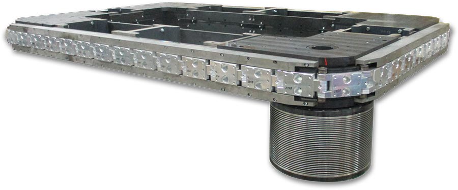

Specify Positional Accuracy and Repeatability: The precision indexing conveyor must offer the positional accuracy and repeatability that aligns with the tolerances of your automotive components. Precision indexing conveyors provide superior accuracy compared to timing belt conveyors, for instance, so ascertain the level of precision required for each process and select a conveyor that meets or exceeds these specifications. The Motion Index Drives LFA series of precision indexing conveyors has a standard overall accuracy of +/- 0.0025” on the opposite end of the drive side. The cam followers that are assembled to the links of the LFA precision indexing conveyor are trapped on all sides by a hardened and ground rail system, providing high accuracy in x, y, and z positions.

fixed indexing conveyor

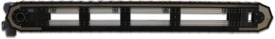

LTC Conveyor
Through meticulous planning, precise engineering, and thorough validation, a precision indexing conveyor can be seamlessly integrated into an automated production line, resulting in a sophisticated system capable of meeting the high standards of modern automotive manufacturing.
