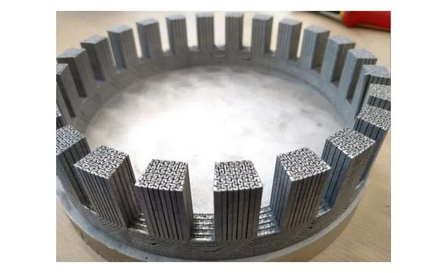

Electric Motor Features Printed Metal Parts
To increase range and power, electric vehicles need to be lighter. One way to do that is by using new materials in motors and other components.
Engineers at the University of Sheffield and the University of Wisconsin-Madison recently developed a motor that features stators produced with additive manufacturing technology. It uses a higher-percentage silicon electrical steel that reduces energy losses.
The biggest design difference between the prototype and traditional stators can be seen in the prongs themselves—they feature an intricate design of thin geometric lines meant to reduce energy loss.
Traditional methods of creating stators in electric motors use a lamination process, where sheets of electrical steel are stamped out. That method, though easily replicated, tends to rely on using an electrical steel alloy with 3 percent silicon in it, which leads to higher rates of energy loss and less efficiency.
"This project has shown the large potential that additive manufacturing has for electrical machines, with lightweight, efficient structures that have never before been possible using any other manufacturing technique.”
– Alexander Goodall
An electrical steel alloy made with 6.5 percent silicon, recommended by the U.S. Department of Energy, reduces energy losses but is more brittle and is less likely to withstand the traditional lamination process. However, with 3D printing, there’s no need for tons of pressure to be exerted during rolling and the machine can print the delicate pattern on the small 10-kilowatt prototype stator within 20 hours.
While that wouldn’t be enough energy to run an electric vehicle, the model could be easily scaled up to reach 40 kilowatts and printed faster on an industrial printer.
"This project has shown the large potential that additive manufacturing has for electrical machines, with lightweight, efficient structures that have never before been possible using any other manufacturing technique,” says Alexander Goodall, a doctoral student in the Department of Materials Science and Engineering at the University of Sheffield who worked on the motor.
