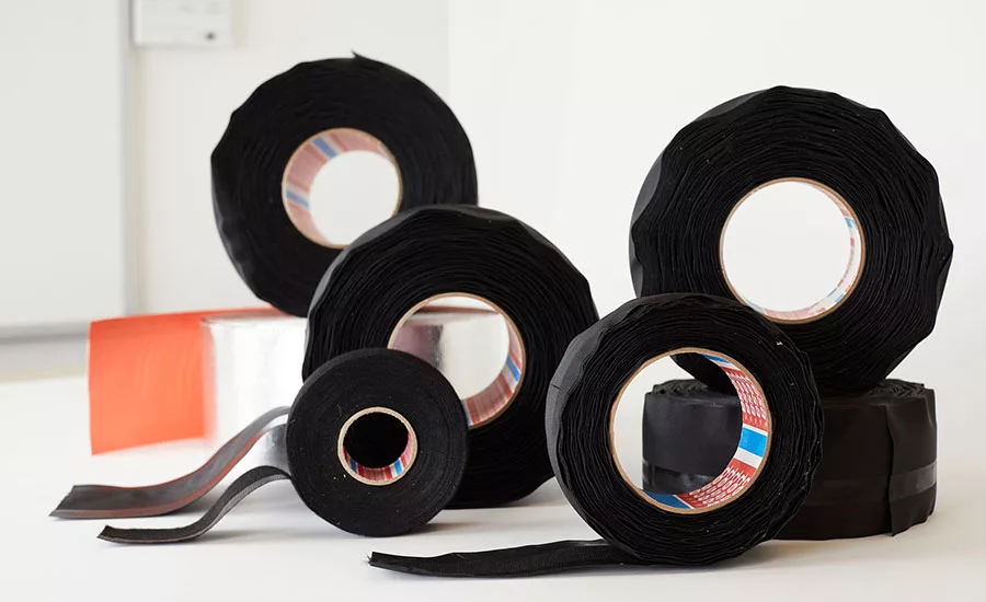

SuperSleeveplus 51036 PV6 and PV78 sleeves feature both a layer of cloth and a layer of fleece to bundle wires together in a car body. The sleeves enable the wires to bend and stay firmly together and protected. Adhesive tapes lack this flexibility and leave wires rigid. The sleeves also provide abrasion and temperature resistance, along with noise dampening and protection from dirt and grit kicked up from the road or from extensive disuse. SuperSleeveplus products resist temperatures of up to 300 F for 3,000 hours.
Sleeves can be applied in a fraction of the time that it takes for wires to be wrapped with tape in a spiral. Plus, under-wrapping and spot taping are removed from the process entirely. Precision is increased and inconsistencies are reduced because “lengthwise wrapping” is easier to perfect than spiral wrapping.
