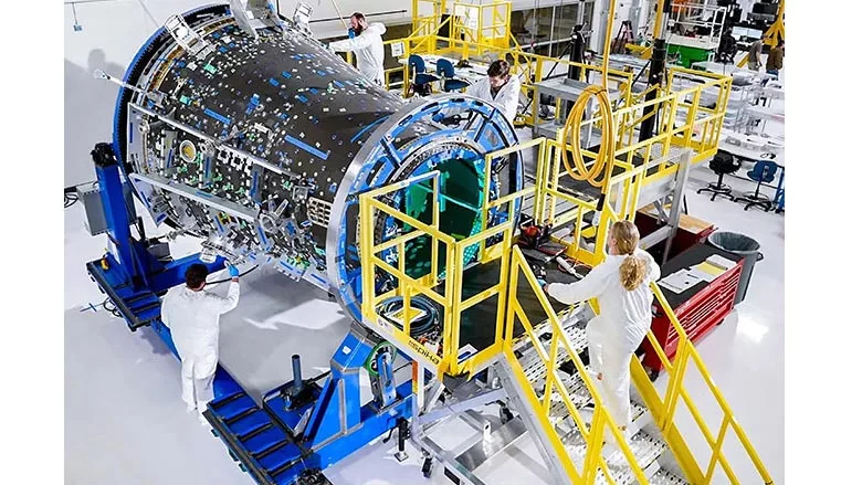

assembling the Dream Chaser spacecraft
Spika designed four unique platforms to work on the Dream Chaser spacecraft.
Photo courtesy Spika Design and Manufacturing

mobile work platforms for assembly of Dream Chaser spacecraft
This mobile platform was designed to work on the Dream Chaser spacecraft. Photo courtesy Spika Design and Manufacturing

To build and equip the Dream Chaser, Sierra Space needed custom work platforms that would give technicians unlimited access to the spacecraft, in a restrictive environment, while meeting a host of strict quality and safety requirements. Spika got the job.
The program required a system of platforms to provide access to the cargo module of the Dream Chaser during installation of internal and external details. The platforms had to meet the following requirements:
  • Allow for side, top, forward and aft access.
  • Provide access to the cargo module from the forward and aft openings.
  • Meet requirements for static electricity and foreign object debris (FOD) control.
  • Limit vibration and movement of the platform to prevent inadvertent contact with the vehicle.
In addition, Sierra Space required extensive project management, design reviews, product testing and analysis, and quality management.
Spika designed and built four unique systems to be used for specific locations and tasks on the space vehicle. They included:
  • Side access platforms with extended slider reach and deflection restrictions.
  • Tall, partially prone, tilt-out platforms with incorporated vacuum plumbing.
  •  End-access platforms with a diving board design protruding into inside areas of the space vehicle.
  • Platforms with a non-FOD-producing slide-out and extendable ladder.
