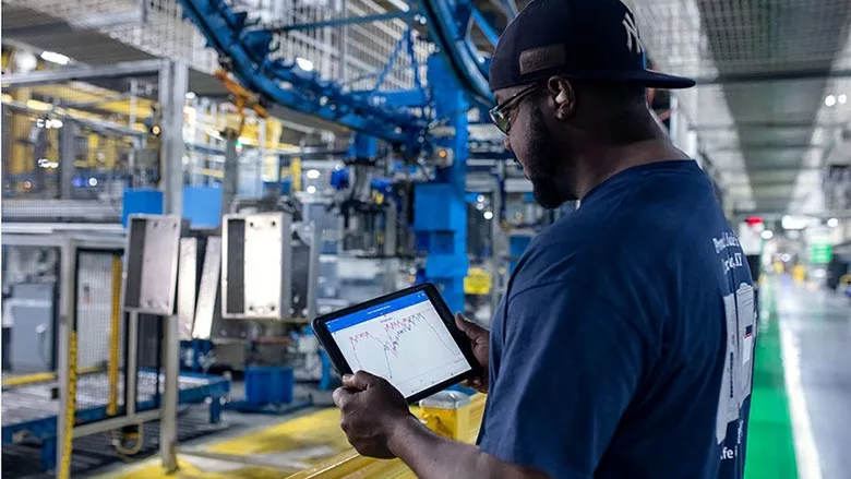

digital monitoring and diagnostics
Because production equipment is connected, employees can monitor energy usage and perform a variety of diagnostic and predictive maintenance tasks. Photo courtesy Schneider Electric
The Lexington plant harnesses Schneider Electric’s Industrial Internet of Things (IIoT) based EcoStruxure system, which provides digital tools such as augmented reality, remote monitoring and predictive maintenance to drive energy efficiency, sustainability and overall cost savings.
“By making our existing infrastructure smarter, we are able to extract data that was never available to us because it was trapped in silos; we now use that data to make the right decisions quickly,” says Labhart. “We are quite developed at the connected products level. The push buttons, lights, back lights, terminal strips, limit switches, photo eyes, RFID switches and HMIs are all connected."
