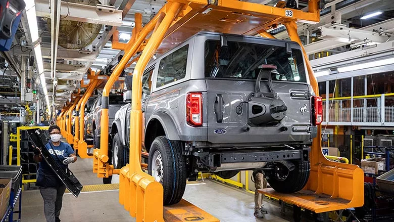

Ford Bronco on the assembly line
The Michigan Assembly Plant recently began producing the Bronco.

The Michigan Assembly Plant is located a short drive west of Ford’s corporate headquarters. The factory is a consolidation of two facilities that were built in the boom years of the 1950s: Michigan Truck and Wayne Stamping and Assembly. The former was built in 1957 to produce station wagons.
The building was christened the Michigan Truck Plant in 1964 when it began assembling F-100 pickups. The factory also produced Broncos from 1966 to 1996. Michigan Assembly gained acclaim as being among the most important and profitable factories in the world when it made Ford Expeditions and Lincoln Navigators from 1996 to 2008.
By 2012, the facility had once again undergone multiple changes and was building four versions of the Focus compact sedan and two versions of the C-Max crossover. It served as a showcase for producing multiple power train models—gas, electric, hybrid and plug-in hybrid—on the same assembly line in environmentally friendly ways.
Ford engineers also pioneered new tools and technology in the plant, such as an upper body exoskeleton for performing repetitive tasks. Operators on overhead clamshell assembly lines used the device for awkward tasks such as attaching brake and fuel lines.
In 2017, Ford announced plans to invest $850 million in the Michigan Assembly Plant to build the all-new Bronco and Ranger. The company proclaimed it was “a renaissance for a plant just outside of Detroit that has experienced the highs and lows of the American auto industry for the past six decades.”

Ranger production began at the plant in 2018, followed by the Bronco in 2021. The massive retooling effort included a modification center that specializes in factory-installed extras such as front bumper safari bars, roof racks and exterior graphic packages.
Earlier this year, Ford announced plans to create nearly 900 jobs as part of a new third crew at the Michigan Assembly Plant to meet surging demand for various Bronco and Ranger models. The company said the initiative would enable it to move “nimbly across its global footprint to capitalize on its balanced lineup and serve customers with the right mix of gas-powered, hybrid and electric vehicles, while optimizing financial returns…The new 1,600-person third crew at Michigan Assembly Plant will also include approximately 700 employees from Ford’s Rouge Complex in Dearborn who applied for job openings.”
“[We are] adding the manpower this summer to support planned future volume increases for vehicle lines assembled at the plant,” says Jim Farley, president and CEO of Ford Motor Co. “The all-new Ranger and Ranger Raptor are on track to launch this year. Michigan Assembly Plant will transition to producing vehicles seven days a week vs. five currently, with three crews working two shifts…We are taking advantage of our manufacturing flexibility to offer customers choices while balancing our growth and profitability.”
