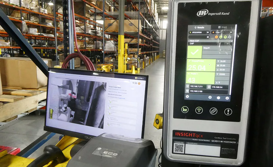

The digital work instructions guide every step in the assembly process. In the background, Pico MES logs the actions taken and the time to complete them for both traceability and process improvement.
One of the biggest advantages of the system is its connected tooling feature. Even though MORryde assemblers use air and cordless fastening tools from a variety of suppliers, including Atlas Copco and Ingersoll Rand, all torque values and other key parameters can be collected for error proofing and traceability.
Driven by process data embedded in the work order’s instructions, the system guides the operator to the correct fastener location, activates the tool to provide the correct torque, validates the applied torque, stores the data for each fastener and then disables the tool when completed.
