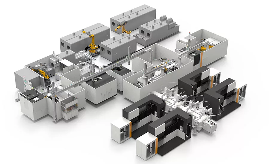

automated hairpin stator assembly system
BBS Automation designed and built this automated hairpin stator assembly system for EV motors. Illustration courtesy Dürr Systems Inc.

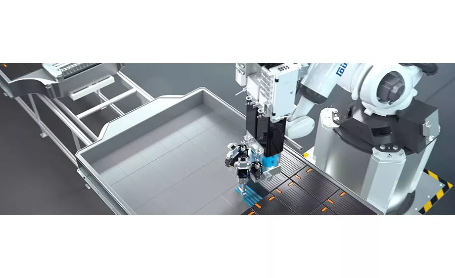

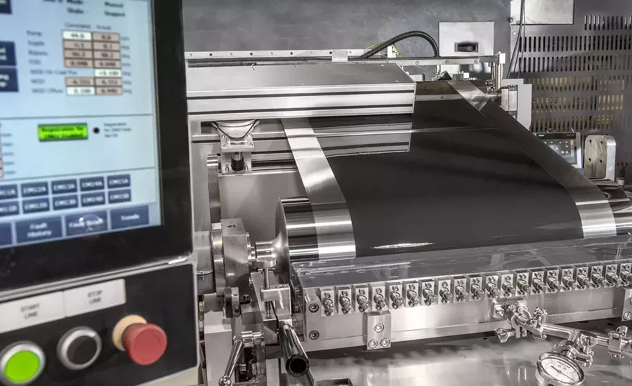

coating anode and cathode electrodes
This automated system coats anode and cathode electrodes used to make lithium-ion batteries. Photo courtesy Dürr Systems Inc.

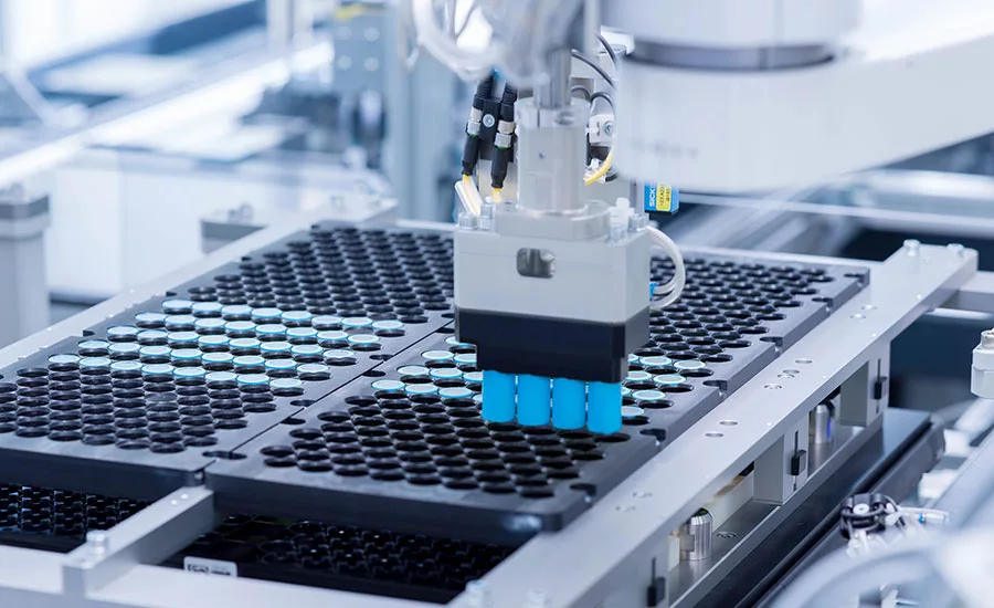

assembling EV battery modules
Battery modules for various EV applications are assembled and tested on Teamtechnik machines. Photo courtesy Dürr Systems Inc.

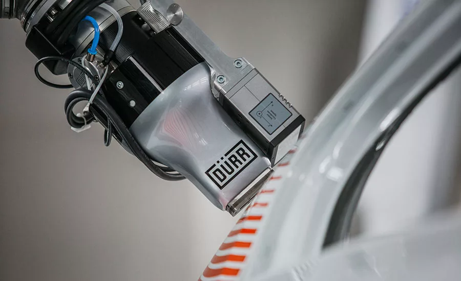

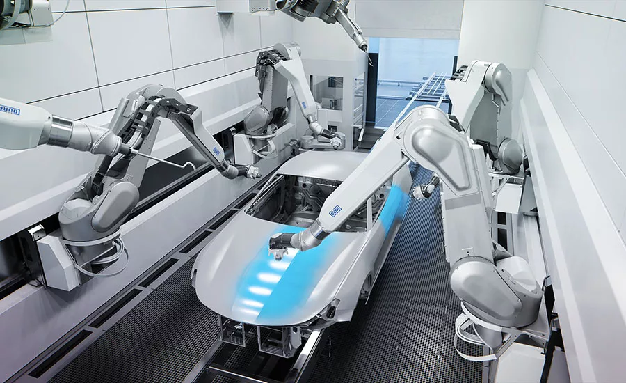

EcoPaintJet Pro
EcoPaintJet Pro ensures highly defined coating without overspray, eliminating the need for manual masking and saving time during two-tone painting. Photo courtesy Dürr Systems Inc.

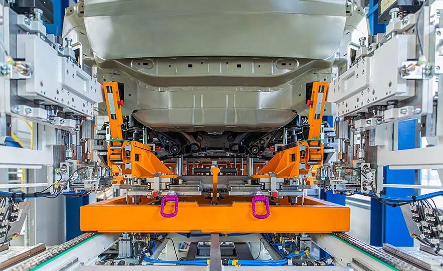

automated assembly line
Dürr supplies automated assembly lines to automakers around the world. Photo courtesy Dürr Systems Inc.
EcoProBooth painting box
The EcoProBooth reduces energy consumption and increases efficiency of automotive paint shops. Photo courtesy Dürr Systems Inc.

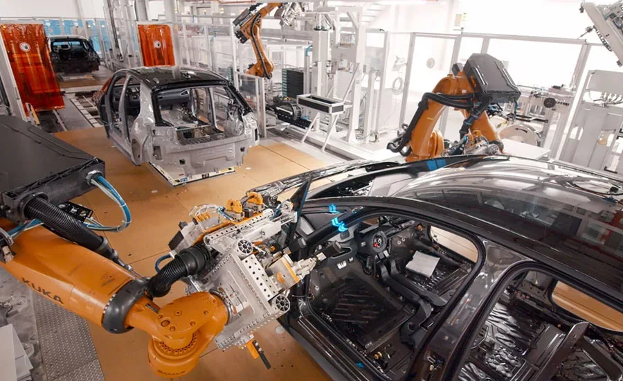

automated side window assembly at Volkswagen EV plant
An automated system glues in side windows at Volkswagen’s EV plant in Zwickau, Germany. Photo courtesy Dürr Systems Inc.

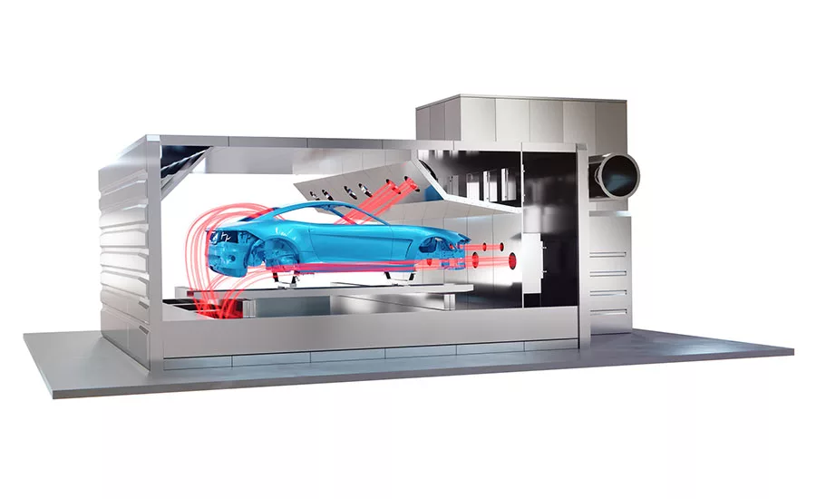

EcoInCure oven
The EcoInCure oven is ideal for drying rocker panels. Illustration courtesy Dürr Systems Inc.

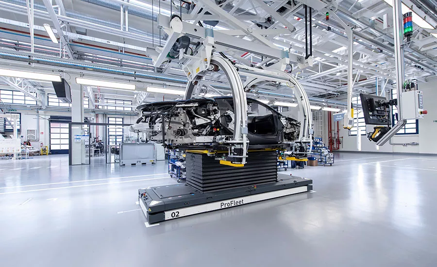

automated guided vehicles
Automated guided vehicles enable automakers to scale up production at the appropriate time, rather than investing heavily upfront. Photo courtesy Dürr Systems Inc.

EcoPaintJet Pro

Dürr engineers have been developing electrode coating technology for lithium-ion batteries and equipment to mass-produce electric traction motors. The company provides automation for various process steps in the battery production value chain, including wet and dry coating technology, dryers and solvent recovery systems for the production of battery electrodes, plus assembly and testing technology for lithium-ion cells, modules and packs.

AEM: What type of power train and final assembly lines are electric vehicle manufacturers typically looking for today? Do they have any unique requirements vs. traditional ICE production lines?
Murray: Our customers typically request battery assembly services, which involve integrating the battery pack into the car body or drivetrain subassembly alongside axles and suspension components, followed by transitioning to decking and bolting stations. Given the differing requirements for body and chassis integration between EVs and ICE vehicles, a flexible and scalable decking solution is typically necessary for EVs, particularly due to variations in power train configurations. To address this need, we've developed standardized products capable of accommodating both vehicle types and a variety of power train assembly strategies. In EVs, new car architectures, such as open floor designs, allow for additional assemblies like seats or center consoles fitting directly onto the drivetrain subassembly, providing humans or robots with improved access compared to traditional ICE vehicle architectures. This represents a shift in process flow from traditional cars. Early-stage testing of the battery pack, sensors and controls is increasingly crucial in EV assembly lines, due to the complexity involved in repairing or replacing components after the vehicle has been fully assembled.
AEM: Is assembly line flexibility becoming more important to legacy automakers today?
Murrary: Increased automation and robot utilization for assembly and calibration processes will reduce the workload per station. This could lead to more workstations and shorter sequences, enhancing flexibility in station arrangement. Subassemblies could be built in smaller loops, and component delivery via automated guided vehicles (AGVs) can be easily guaranteed to the main line.

Murray: Traditional automakers typically focus on producing high output volumes per assembly line. As a result, they have long, sequentially arranged lines, with the required areas and building size set up to accommodate these high volumes. Planning involves incorporating pits and roof reinforcements in dedicated locations, which typically remain in place throughout production of the car model. On the other hand, start-ups typically start their production with lower volumes and aim to scale up production as sales volumes increase in the market. Therefore, there is a noticeable trend toward prioritizing flexibility and scalability in production equipment.
AEM: Are EV lines usually configured any differently than traditional ICE lines?
Murray: Electric vehicle assembly lines differ significantly from traditional ICE lines, particularly in chassis assembly and integration of complex electrical systems. These differences necessitate tailored assembly line configurations to accommodate EV requirements effectively.
AEM: What is the advantage of building EVs on the same line as ICE vehicles vs. using dedicated assembly lines?
Murray: From our perspective, integrating an EV into an existing ICE production line presents numerous challenges. While several OEMs assemble traditional ICE variants on the same line, this integration is facilitated by shared chassis and parts across vehicles. However, despite similarities in components like body, axles, suspension and steering systems, significant differences in power train variants introduce complexity in achieving a unified assembly process. Managing multiple variants, providing additional components through logistics channels, and integrating test stations become more complex as a result.
Naturally, integrating EVs into existing lines makes sense for car designs utilizing the same architecture for ICE, PHEVs and BEVs. However, if the car design is tailored specifically for pure electric vehicles, building it on a dedicated line could reduce complexity in the assembly process.

AEM: What type of conveyors are EV manufacturers looking for? Why do AGVs play an important role in EV assembly lines?
Murray: [It's about] flexibility and scalability. AGVs offer significant benefits for relocating assembly areas or integrating additional models. Increasing production rates can be achieved seamlessly by adding additional AGVs to the line, avoiding down times during commissioning and integration of new systems. Another aspect to consider is the lower initial investment compared to conveyors, especially during the OEM start-up phase. With rising production volumes, AGVs enable scaling up at the appropriate time, rather than investing heavily upfront and potentially underutilizing equipment for a longer period of time.

AEM: Do EV manufacturers have any unique paint shop requirements?
Murray: Although EV bodies are similar to conventional bodies, automotive manufacturers often seek modern and sporty paintwork for EVs. This entails applying decorative and contrasting colors, like a two-tone roof while maintaining environmental friendliness and avoiding overspray masking of the car body. To achieve this, automakers often turn to specialized applicators such as Dürr’s EcoPaintJet Pro. It comprises a robot, measuring system and applicator, ensures highly defined coating without overspray, eliminating the need for manual masking and saving time during two-tone painting.
Electric vehicles also require well-reinforced rocker panels to protect their batteries in the event of a side impact. Our EcoInCure oven excels in drying these rocker panels, surpassing conventional ovens and preventing overheating in thinner body shell parts. Car bodies run transversely through the line in stop-and-go operation, facilitating direct inflow of hot curing air into the windshield opening. Jet nozzles with long throw distances target the interior of the car body, heating and cooling the structure and painted body sheets from the inside-out, resulting in a very gentle, yet effective, heating process and significantly improved top-coat appearance.
