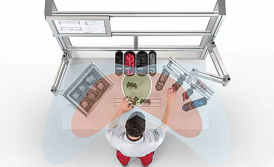

In a traditional workstation, parts and tools are spread out horizontally across the work surface. "There's not a lot of thought put into it," explains Eric Dotson, former vice president and general manager of Treston Inc. "However, a lean workstation has more vertical presentation, so tools and parts are closer to the operator. This reduces space and wasted time spent looking for materials."

"Most workstations just happen," says Lee. "No one takes much time to design them." When evaluating a workstation, he recommends focusing on specific areas, such as handling of product or materials; tool documentation and parts presentation; and organization and storage.
"It's especially important to analyze the frequency of reach for parts," adds Lee. "The most commonly used parts should always be placed closest to the operator."

"When designing workstations, it's important to remember that people move in arcs, not straight lines," says Chris McIntyre, vice president of product management at XSensor Technology Corp. "Too many workstations tend to be designed as a rectangular desk. As you move parts and tools further out from the side of the body, they become harder to reach."
Ergonomic reach zones extend both vertically and horizontally. Reaches below shoulder height are less fatiguing. Routinely used tools and parts should be placed within horizontal reach and work zones whenever possible. If reaches become excessive, engineers should consider splitting the assembly operation into two separate tasks.
