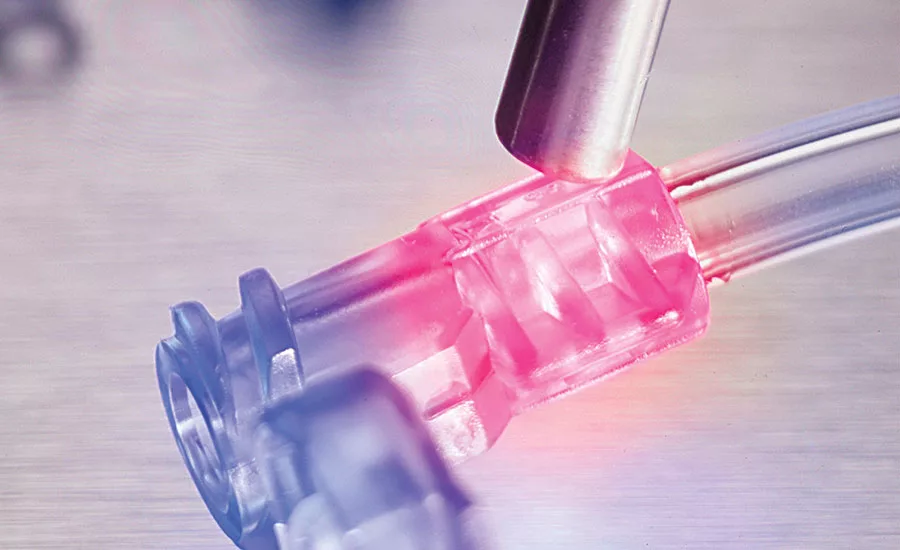

Encompass UV-cure acrylic urethane adhesives incorporate Ultra-Red fluorescing and See-Cure color-change technologies. The adhesives are blue, but become colorless when cured and appear red under low-intensity black light during inspection. Photo courtesy Dymax Corp.
