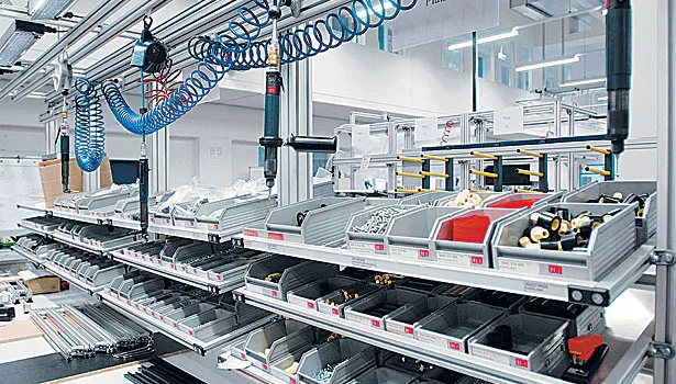

Putting parts at an angle allows for easy resupply from behind the workstation, separating the value-adding assembly tasks from the nonvalue-adding material handling tasks. Photo courtesy Bosch Rexroth Corp.

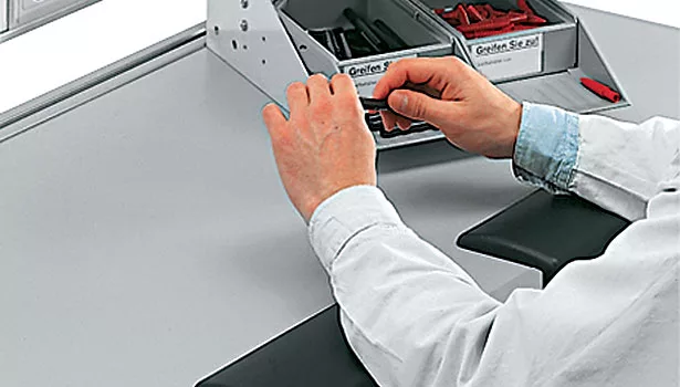

Bins should be placed within easy reach of operators and should have grab ledges to make it easy to pick up small parts. Photo courtesy Bosch Rexroth Corp.

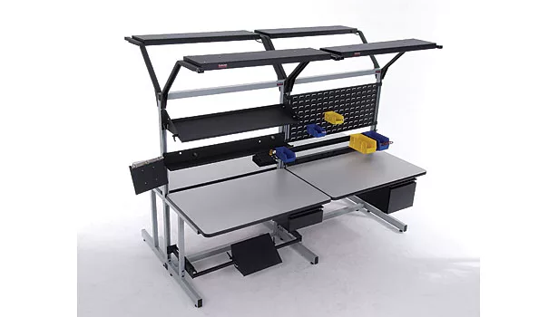

Shallow work surfaces and bin-holding extensions help reduce reach. Photo courtesy Production Basics

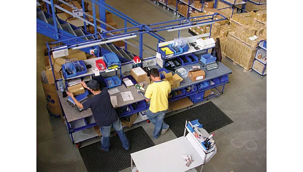

Parts bins should be presented to assemblers based on the frequency of parts use. Photo courtesy Creform Corp.
