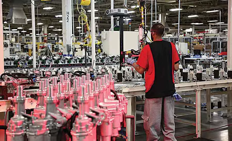

Manufacturers in a variety of industries face similar assembly line layout issues and challenges. Photo courtesy Nexteer Automotive

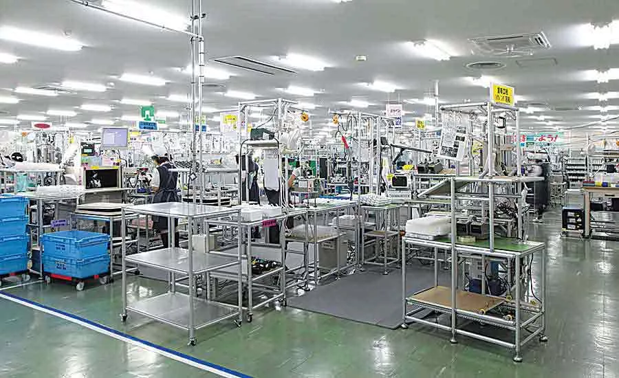

The way in which workstations and tools are arranged can affect ergonomics, productivity and throughput. Photo courtesy Lean Factory America

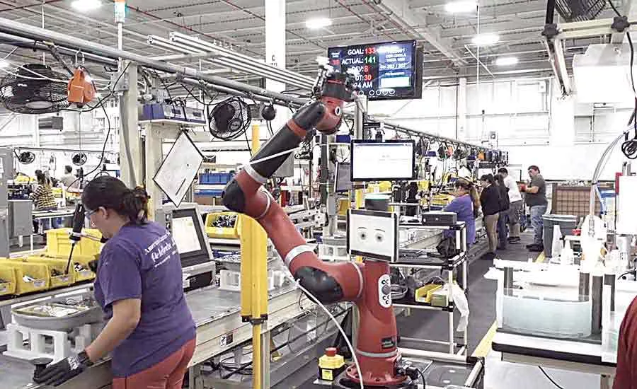

Engineers should involve operators in any decisions related to line layout. Photo courtesy GE Current

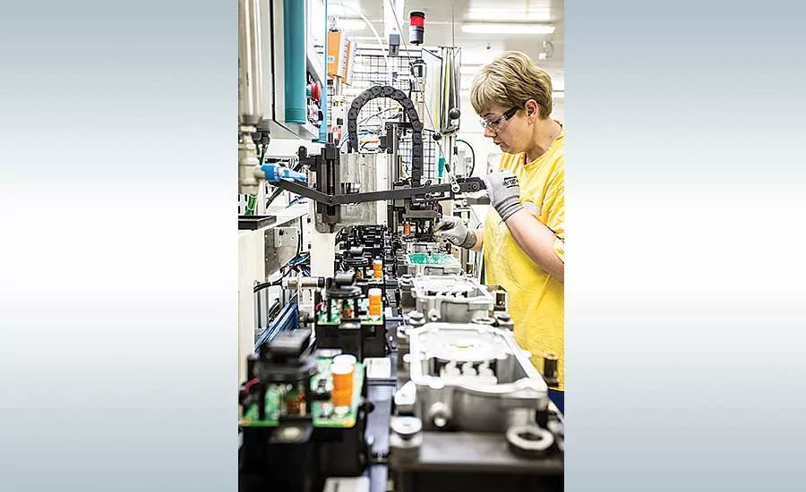

Lean lines should accommodate increasing product variety without compromising quality or introducing waste into the process. Photo courtesy Nexteer Automotive

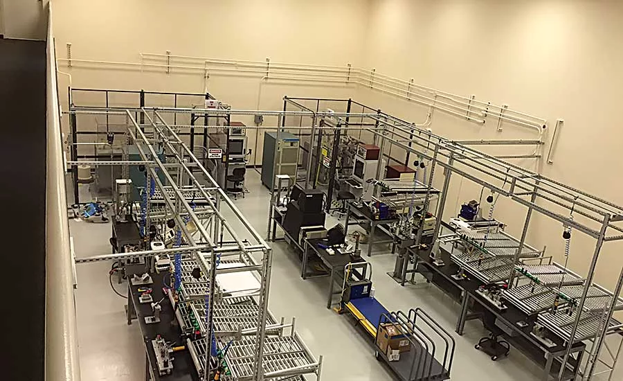

Sometimes, material handling and logistics issues aren’t sufficiently planned for. Photo courtesy Lean Factory America

“Producing more than one model simultaneously on an assembly line presents a number of challenges,” says Jeffrey Miller, P.E., managing principal at Productivity Engineering Services LLC. “Since the work content for each of the models will be different, this can lead to uneven flow along the line. Unless the line is properly balanced, you’ll end up with overstaffing or regularly scheduling overtime to meet customer demand.
“As model mix increases, so does the proliferation of parts and subassemblies that need to be presented line-side,” notes Miller. “Consequently, I see a lot of manufacturers struggling with the problem of how to best fit five pounds of stuff in a three-pound bag.
“It’s not an easy process, but this issue can be overcome with the proper material management system, such as implementing just-in-time kitting, sequencing and a small-lot strategy,” claims Miller. “But, [that] requires considerable upfront planning and know-how to get it right.”
Old or new, large or small; it doesn’t matter. Manufacturers in a variety of industries face similar line layout issues and challenges.
“There are a couple of problems I tend to see,” says Art Smalley, president of the Art of Lean Inc., and a former engineer at Toyota Motor Corp. “One is when new process or product lines are put into an old facility.
“Product flow is shoehorned into a space that is not optimal from the start,” explains Smalley. “This is done to save money on paper. But, it also tends to build in cost in reality, which is not fully understood up front. It contributes difficulty not only to the flow of product, but the flow of information, communication and daily supervision.
“Another problem, even in newer facilities, is to not fully plan out layouts in sufficient detail up front,” adds Smalley. “From the 10,000 foot level, things look fine. But, when actual movement of people, material, conveyance and product is put into place, problems jump out more clearly.”

“Flexibility is always important,” claims Locher. “As long as it’s safe, try to put everything on wheels and use quick disconnects. If possible, lighting should be attached to workstations.
“In addition, some engineers don’t adequately involve operators in the line design process,” says Locher. “Whenever Toyota makes a layout change, they always get input from the people working on the line.”
It’s also important to consider material handling issues, such as parts storage, movement and conveyance.
“Equipment location is static, but material, people and information flow is dynamic and harder to visualize when working with layouts,” says Smalley. “Engineers tend to see the layout from the equipment point of view, while actual daily operations involve dynamic events that are harder to see on paper. It is like the difference between a photograph and a movie.”

Involve Operators
Crossfunctional design teams should include key players from the production crew. “These folks have a wealth of tribal knowledge,” Miller points out. “Capturing how the products are actually built, the operating methods used to get things done, and issues and shortcomings of the current layout are invaluable nuggets of information needed for the successful design of the future state layout.
“Fostering active involvement and participation of key associates not only leads to a better line balance and layout solution, but also there will be much less resistance when it comes time to implementing the plan,” notes Miller. “[Operators] will take ownership of the layout they helped develop.”
