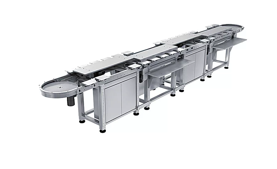

The LS 280 system consists of modular linear-indexing units called locking stations. Indexing at each station is governed by a cylindrical cam, and each station can run at a different pitch. Photo courtesy Weiss North America Inc.

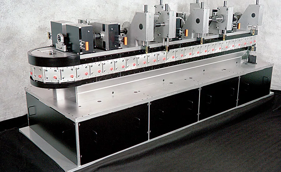

This carousel-style indexing chassis is fully synchronous. That is, a single motor controls the motion of the precision-link conveyor, as well as the pick-and-place units mounted to the tabletop. Photo courtesy Stelron Components Inc.

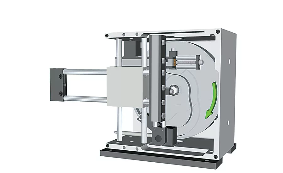

A cam controls the motion of this pick-and-place mechanism. The advantage of a synchronized, cam-driven unit is that it automatically speeds up as indexing speed increases. Illustration courtesy Stelron Components Inc.

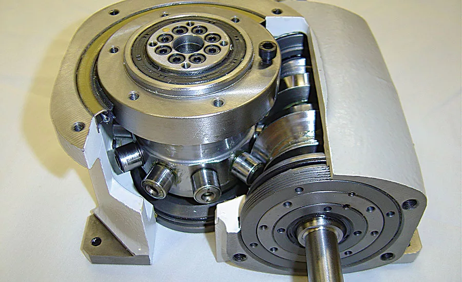

Constant contact between the cam and its followers means that cam-driven indexers provide fast settling times and stiff positioning during dwell periods. Photo courtesy Sankyo America Inc.

Constant contact between the cam and its followers means that cam-driven indexers provide fast settling times and stiff positioning during dwell periods. “If the servomotor has to go through a planetary gearbox, there’s going to be some backlash,” Bemer adds.

Unique Linear Indexer
The knock on cam-driven indexing systems has always been that the slowest process determines the overall cycle time of the system. Weiss North America has come up with a cam-driven linear-indexing system that overcomes that limitation.
At the heart of Weiss’ LS 280 system are modular linear-indexing units called locking stations. Indexing at each station is governed by a cylindrical cam. Locking stations are available with indexing pitches of 70, 140, 280 and 560 millimeters.
A single locking station can accommodate 10 positions at a pitch of 70 millimeters, five positions at a pitch of 140 millimeters, three positions at a pitch of 280 millimeters, or four positions at a pitch of 560 millimeters (double-sided). A double locking station can accommodate 28 positions at a pitch of 70 millimeters, 14 positions at a pitch of 140 millimeters, seven positions at a pitch of 280 millimeters, or six positions at a pitch of 560 millimeters (double-sided).
Each station’s cylindrical cam is designed to engage with cam-followers attached to a workpiece carrier. The carrier is supported by roller bearings that ride on a continuous, hardened and ground steel guide rail. Despite working at high speed, the sinusoidal motion curve within the cylindrical cam ensures smooth, impact-free transportation of the carriers.
Because the system is modular, a locking station with a 70-millimeter pitch can be paired with a locking station with a pitch of 140, 280 or 560 millimeters.
“Instead of a system that moves entirely at one speed, you can have multiple processing times within the same machine,” explains Eppich. “For example, you can have a 0.5-second index time, a 1-second index time, and a 3-second index time—all on the same machine. At the same time, you still get the accurate, rigid positioning of a cam-driven system.”
Pick-and-place units and other assembly equipment can be installed directly on the locking stations. Manual assembly stations can also be integrated into the system.
Belt conveyors transport carriers between locking stations. This decouples the cams from each other and also serves as a small buffer between stations. Both 180- and 90-degree corner units are available to create various loop layouts.
A clean-room-compatible version of the system (certified for use in a Class 6 environment) is also available.
