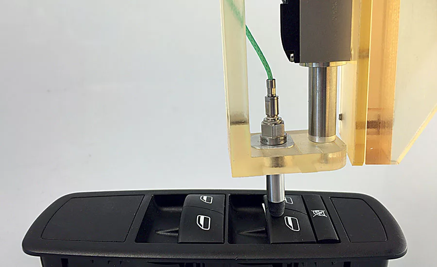

Since anyone who activates a switch expects that the desired effect will follow, haptic and functionality testing are critical to customer satisfaction. Only a thorough check of each switch by the manufacturer can ensure that substandard or faulty parts are rejected at an early stage. During such testing, a sensor is used to measure the effort needed to activate the switch. A “good” or “bad” assessment is made based on a plot of force vs. distance.

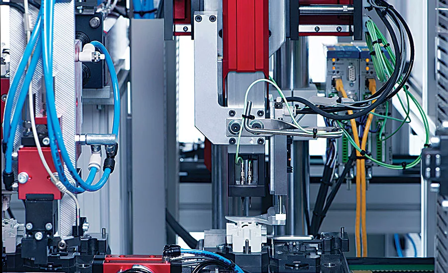

To ensure precise measurement and exclude measuring inaccuracies (for example, due to bending moments), the force application area at the sensor—and therefore the sensor itself—should be as small as possible. The size of the sensor is also important to the overall design of the automated test system. In most cases, there’s just not that much space available for the sensor to be installed.

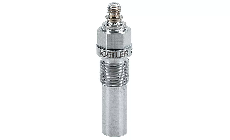

To meet the demands for testing ever-smaller switches and touchscreens, force sensors must be small enough to test buttons that are very close to each other. Accuracy and repeatability are vital. They also need protection against overload. Sensors that cannot resist a higher-than-expected load (as when a component is incorrectly inserted) could be damaged. Finally, they need to have a wide measuring range. While it doesn’t take much force to activate a button or touchscreen, the spread is wider than you might think, ranging from 0.1 to 500 newtons.
Miniature piezoelectric force sensors meet these requirements. These tiny instruments can take very precise measurements with the smallest force application areas. They offer excellent repeatability and high resolution, even when testing switches and keys. At the same time, the sensors are robust, durable and protected from overload.
The smallest such force sensor is 6.1 millimeters in diameter and 23.3 millimeters tall, but can measure forces from -20 to 200 newtons.
Piezoelectric sensors provide a superior price-to-performance ratio compared with strain-gauge technology. The latter must be integrated into the production line using adapters, while piezoelectric force sensors can be installed on a mounting plate directly through an external thread. Complicated and expensive recording elements are not required. In addition, this type of mounting makes it possible to arrange several sensors in tight spaces, making it possible to test a closely arranged row of keys in sequence.
