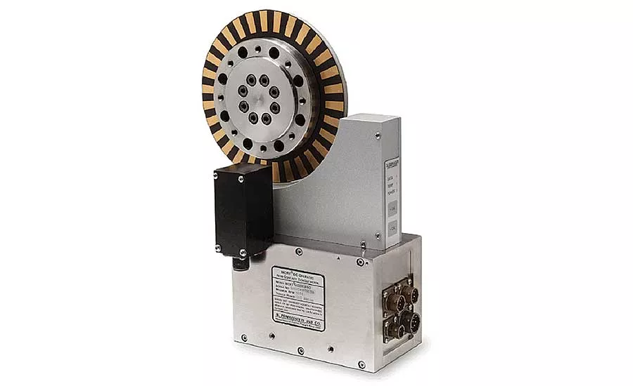

The 8400V series of bearingless digital torque transducers are accurate to within ±0.027 percent of full scale and offer torque capacity from 28 to 11,000 newton-meters. Photo courtesy S. Himmelstein and Co.

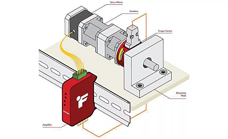

Torque sensors are installed between test pieces and their mounting plates. Graphic courtesy FUTEK Advanced Sensor Technology Inc

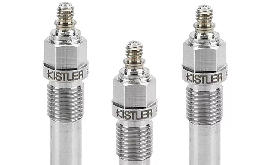

Shaped like a bolt, the 9217-A piezoelectric force sensor measures quasistatic and dynamic tensile and compression forces of 1 or more millinewtons on robots and automatic assembly machines. Photo courtesy Kistler Instrument Group

Torque sensors measure and record the rotational force on various rotating systems. Some torque sensors only measure static torque, while others are able to handle static and dynamic (in process) torque. The sensors are installed between test pieces and their mounting plates, and either sit on a pedestal or “float” in the driveline.

Kistler’s 9217-A piezoelectric force sensor is used for assembly and testing by different types of manufacturers. Shaped like a bolt, the sensor measures quasistatic and dynamic tensile and compression forces of 1 or more millinewtons on robots and automatic assembly machines. Force is introduced via an M3 tapped hole at the front.
The sensor offers high resolution, three calibrated measuring ranges (±5, ±50 and ±500 newtons) and a dynamic range of 1-to-100,000. Its preloaded measuring element provides high rigidity and a higher tolerance to bending moments. The sensor body has an M10x1 millimeter pitch external thread and a sealed connector.

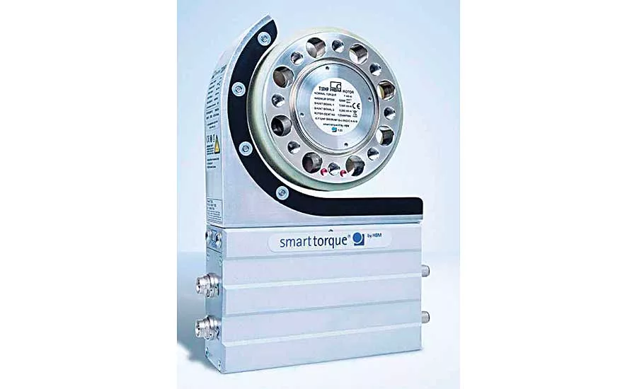

HBM’s calibration labs are certified by the German government (PTB), and tests there show the company’s T12HP torque transducer to be one of the most accurate in the world, with a non-linearity at ±0.007 percent of full scale. Introduced earlier this year, the transducer has a Spanning feature that allows users to run detailed analyses of any partial measurement range from the full scale range.
Minda says the transducer is available with nominal (rated) torques ranging from 100 newton-meters to 10 kilonewton-meters. Its measurement flange directly installs in the drivetrain and is maintenance free. CAN, Profibus, EtherCAT, and Profinet interfaces ensure easy integration of the transducer with different test stand concepts. In addition, it is temperature compensated to 0.005 error percent per 10 degrees Kelvin of change.

All 10 bearingless digital torque transducers in Himmelstein’s 84000V series come with FM and analog outputs, and are accurate to within ±0.027 percent of full scale. Tveter says the series’ wide range of torque capacity (28 to 11,000 newton-meters) makes it popular among automotive and aerospace manufacturers for assembly and testing.
The easy-to-install devices have a 3-kilohertz dynamic response, high overrange (300 percent) and overload (200 or 400 percent), and are immune to clamping and other extraneous loads. Users can select from 10 units of torque measurement without having to recalibrate the transducer. Dual-range configurations are available.
