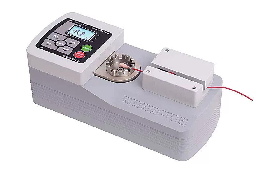

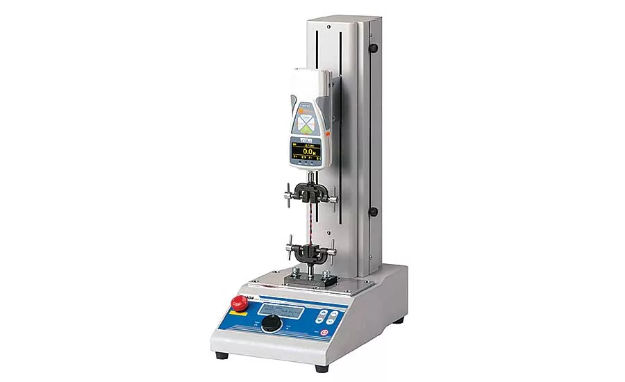

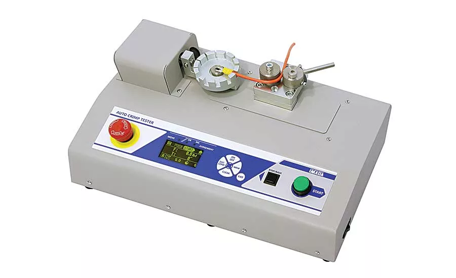

This process can be completed manually or with motorized testers. Mark Fridman, president of Mark-10 Corp., explains there are benefits to both manual and motorized testing.
“Motorized pull testing eliminates human error by offering a consistent test speed and force application,” says Fridman.

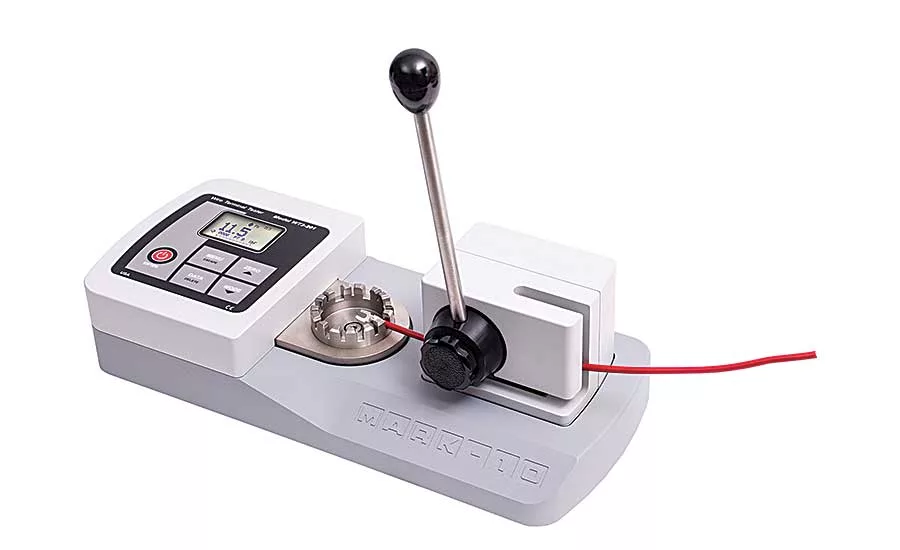

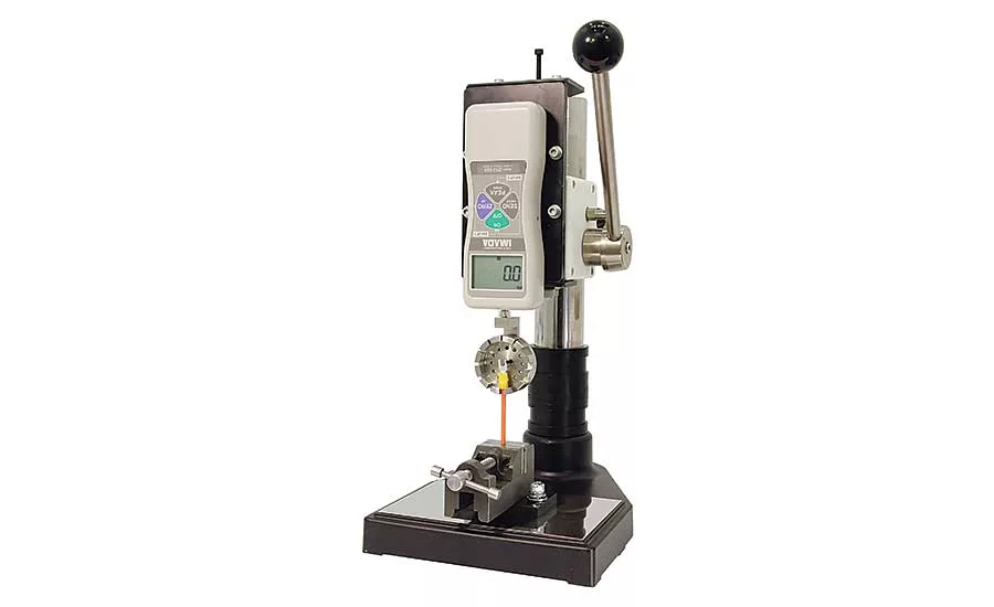

Manual pull-force testing is completed using a lever or hand wheel to apply force to the terminal. Hashoika explains that manual testing relies on an operator to provide consistent force every time. This can be difficult to achieve when multiple people are operating the tester. Each individual may use a different speed to apply the force and then may also apply inconsistent force from one terminal to the next.
“Motorized testing allows for very specific speeds, including half speeds, to be controlled as well as the amount of force applied,” says Hashoika.
This isn’t to say that manual pull testing doesn’t produce accurate results. Manual pull-force tests may be a better option for certain wire gauges. A number of organizations have established guidelines for specific wire gauges and applications. These include UL, ASTM International, NASA and the United States Council for Automotive Research. Some manufacturers, such as Volkswagen, have their own guidelines.
