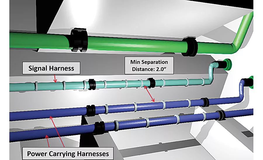

Figure 2 The signal harness (cyan) is within 2 inches of the closest power-carrying harness (blue). Our analysis found that the power cables produced no EMI on the shielded cables in the signal harness. Illustration courtesy Lectromec

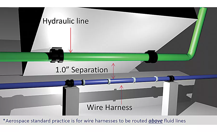

Regulation 25.1707 starts with the following: “Each EWIS must be designed and installed with adequate physical separation from other EWIS and airplane systems so that a EWIS component failure will not create a hazardous condition. …Adequate physical separation must be achieved by [an acceptable] distance or by a barrier that provides protection equivalent to that…distance.”
In other words, a hydraulic line should be located far enough away from a wiring harness, so that if the line were to rupture, the harness would not be damaged. Similarly, the harness should be sufficiently far from the hydraulic line so that, if electrical arcing should escape from the harness, the line would not be damaged. If the space between the line and harness can’t be increased, then one or the other should get additional protection.
What are the criteria for determining an acceptable separation distance? To address that, it’s helpful to look at an example. Figure 1 shows a wiring harness routed near a pressurized hydraulic line. The CAD model shows the harness 1 inch from the line. The harness contains four wires: two 16 AWG wires on 15-amp thermal circuit breakers and two 20 AWG wires on 7.5-amp thermal circuit breakers. The wires carry power in different phases.
There are two ways to determine if there might be an issue: physical testing or simulation.
For physical testing, engineers should strive to match system parameters and define safety thresholds, such as the maximum temperature of the hydraulic line. There are many variables to consider, including operating temperature, maximum fluid pressure and minimum tube thickness. An experienced laboratory can be a great resource for performing such tests and providing posttest analysis.
Simulation can be used to supplement test data, or it can be used as a standalone assessment process. With simulation, it’s possible to assess separation distance for a variety of materials. For example, engineers could determine if the hydraulic line would be more susceptible to failure if it’s made from aluminum or composite materials.
Lectromec’s arc damage modeling tool can be used to simulate wire failures and assess the potential for damage to nearby harnesses, structures, fuel lines and hydraulic lines.
The results of tests and simulations should provide a clear indication of a safe separation distance. If the test results are inconclusive (the target was near a failure condition, but did not actually fail), then additional testing should be performed. Alternatively, engineers may act empirically, either increasing the separation distance or adding a protective barrier.

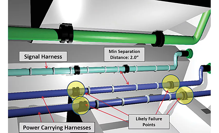

Figure 2 shows three harnesses. Two are power-carrying harnesses (blue), and the other is a signal harness (cyan). The signal harness is within 2 inches of the closest power-carrying harness. In this design, the interference from the power cables was investigated and determined to have no effect on the shielded cables in the signal harness.
However, if the cable shielding was insufficient to protect the signals, then additional methods for protection would need to be considered. Engineers would have to increase the separation distance or add shielding to the cables.
Systems that are necessary for continued safe flight, landing, and egress should be given the highest priority when assessing the impact of EMI.
The following methods are commonly used in the aerospace industry to protect against EMI:
  • Use of EMI or electromagnetic pulse filter protection connectors.
  • Route power and signal wires through separate connectors, if possible.
Shielded cables should be considered for signal cables. Safety-critical systems that depend on clean signals may need this type of shielding for additional noise reduction. When selecting a shielded construction, engineers should ensure that the EMI range suppressed by the cable is enough to protect the wire’s signal.
There are harness protection schemes that offer EMI shielding. As with other shielding techniques, it is important to determine the shield grounding before considering this option.
Separate the power wires from the signal harnesses. This design choice may not be possible in some scenarios, particularly where space is limited.

In our earlier example, the minimum distance between a signal cable and a power cable was 2 inches. The heavy power cables include three 4 AWG wires with three different phases. In practice, it is most likely that a breach and arcing would start at the clamps (see Figure 3).
While a general case would examine the 4 AWG cables under various conditions, the particular case will examine the potential damage to the jacketed, shielded, twisted-pair in the signal harness. The signal cable was selected because, based on past assessments, it was deemed to be the most susceptible to arcing damage.

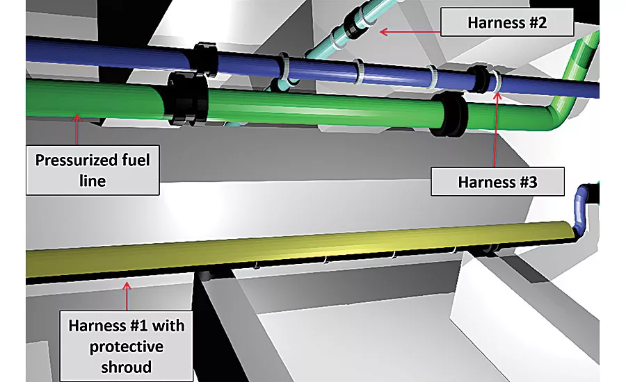

In Figure 4, three wire harnesses are routed near a fuel line. Harness 1 is routed beneath the fuel line, but it is protected by a shroud. While this can be used to protect a harness from fluid exposure, it does add weight, and it may need to be checked periodically during airworthiness inspections.
Harness 2 is routed above and perpendicular to the fuel line, but the supporting clamps are too far apart to prevent sagging and chaffing on the tube. Additional clamping could be installed to resolve this issue.
Harness 3 is routed horizontally, parallel to the line, which is not an issue. However, the separation distance is less than the allowed distance as defined by a damage assessment. Redesign, separation or protective sleeves must be considered for harness 3.
This part of the 25.1707 regulation should also be considered in coordination with the recommended practices of AS50881 section 3.11.11 “Gas- and Fluid-Carrying Lines and Tubes.” Whereas the standard suggests that wiring should be routed with “the maximum practicable separation from all fluid-carrying lines,” this regulation allows wiring to be installed in close proximity as long as the failure consequences have been considered.
The support clamps for separation between the EWIS and fluid and oxygen lines should be given additional consideration. AS50881 suggests that supporting clamps for EWIS should not be connected to fluid and oxygen components unless the separation is less than 2 inches.
The AS50881 standard recommends that wiring should “be installed to maintain positive separation [from gas- and fluid-carrying lines and tubes] of at least 0.5 inch.” First, while this separation distance may be fine for some system configurations, it is not an acceptable blanket statement for separation. Lectromec has performed testing to show that tube failure can occur at an even greater distance from the arc plume generated during a wire failure event.
Second, conformity to the regulation takes precedence over industry guidance. Certification relies on data to verify the safety of a design, and the recommendations of AS50881 do not provide sufficient data to support certification.

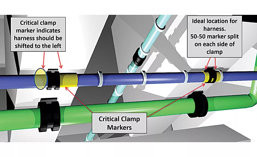

A popular trend in the EWIS community is the critical clamp marker (see figure 5). These markers indicate where a clamp should be placed on the harness. This provides a quick visual reference to a maintenance technician if there is a misalignment of a harness or a harness has slid from its designed location.
While not necessary, it is recommended that these markers be added to EWIS harnesses in areas with mechanical cables. This will ease inspections and ensure EWIS components that moved during maintenance are reinstalled with the proper clearance.
