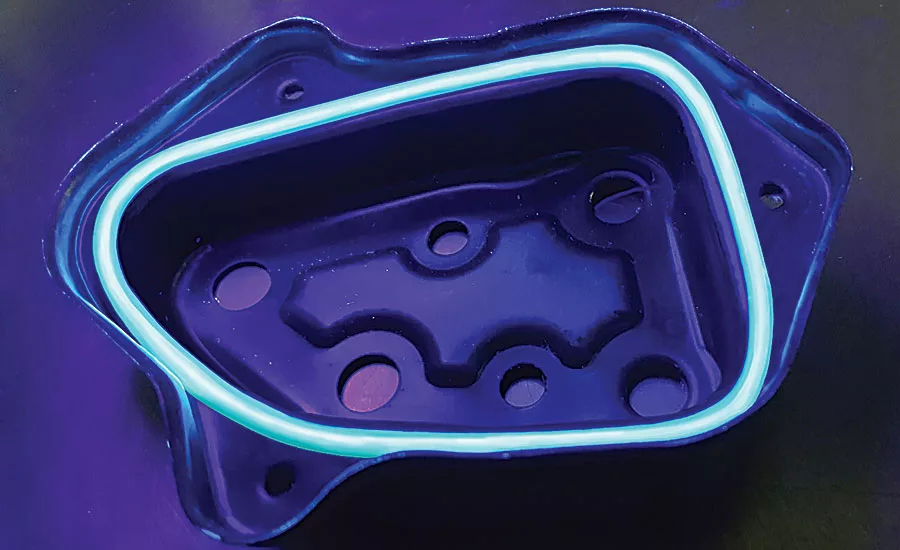

Several suppliers offer UV-cure adhesives for FIP and CIP gaskets. Photo courtesy Hernon Manufacturing Inc.

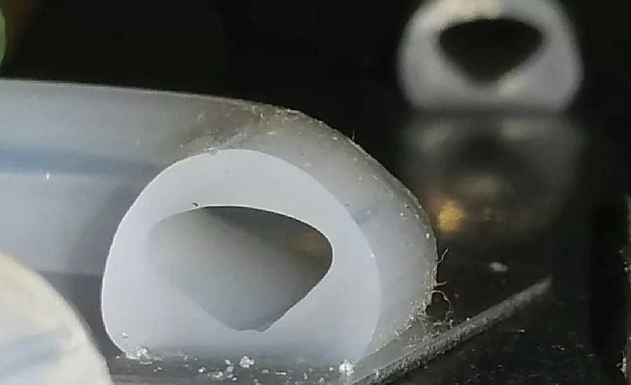

Hollow gaskets feature an open center that can be circular, triangular or rectangular. Photo courtesy New Precision Technology Inc.

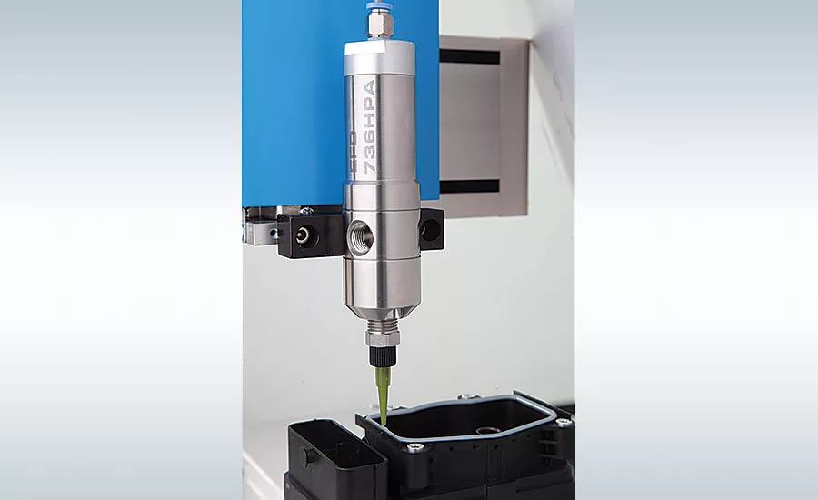

The 736HPA-NV high-pressure, balanced-spool valve applies industrial silicones at fluid pressures up to 2,500 psi. Photo courtesy Nordson EFD

CIP gaskets, in contrast, are cured with heat or UV light prior to assembly. The process involves applying the liquid bead to one flange, curing the bead and compressing the flange against its mating part to achieve a strong seal. CIP gaskets are recommended for assemblies that require frequent service.

Thin materials may be applied with a needle, whereas thicker materials— such as those that form gaskets in large engines—require a high-pressure valve. This type of valve ensures a smooth start to the bead, rather than a surge that creates a cobra head pattern. Its nozzle stem should be designed to snuff back material out of the nozzle area to prevent stringing or tailing at the end of the bead.
A spool valve is another good choice to dispense liquid gaskets. Because its upper and lower seals are the same size, pressures within the valve balance out. High pressure neither forces the valve open nor makes it difficult to open.
The 736HPA-NV from Nordson is a high-pressure, balanced-spool valve that applies industrial silicones at fluid pressures up to 2,500 psi. It is capable of exceeding 400 cycles per minute. A stroke limit adjustment reduces opening surge and regulates snuff-back, while ensuring consistent bead widths and dot profiles.
The valve’s durable components include a stainless steel fluid body and outlet cap, a chrome-coated stainless steel spool and polyester-elastomer upper and lower seals designed to provide millions of cycles without wear or leakage. Replacing the seals is easy: A worker loosens three bolts near the fluid body, removes the seals, inserts new ones and tightens the bolts.

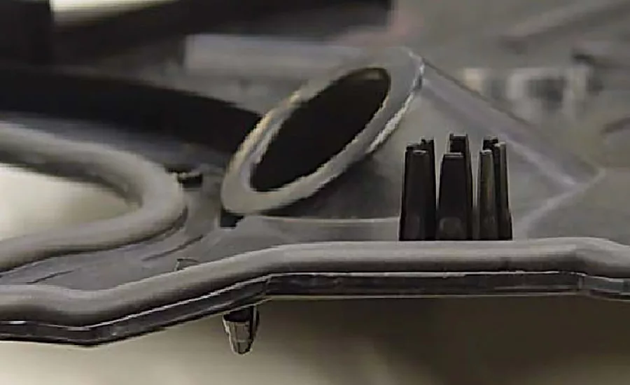

Most of the time, a solid liquid gasket is sufficient. Occasionally, though, the application requires low sealing force between the mating surfaces. For these instances, manufacturers use foam FIP and CIP gaskets. These closed-cell, self-skinning, lowdurometer foam gaskets resist water, chemicals and extreme temperatures while maintaining excellent rebound.
Dispensing this type of gasket usually involves applying a two-component silicone or polyurethane adhesive (1-to- 1 mix ratio) with a positivedisplacement metering and mixing system. Curing time ranges from 30 seconds to a few minutes.

In between solid and foam gaskets are hollow ones. Last year, Axel VanBriesen, founder and president of New Precision Technology Inc., developed technology (patent pending) that extrudes horizontal and vertical FIP gaskets with an open center. This opening can be circular, triangular or rectangular.
VanBriesen says that hollow gaskets require much lower compressive force than solid gaskets. In addition, some hollow gaskets can be designed to deflect into the hollow area, thereby eliminating the need for escape zones into which a solid gasket must deflect.
Because hollow gaskets are extruded, their profiles are not limited to the traditional 1-to-1 or 2-to-1 width-toheight ratios. VanBriesen says he’s able to produce ratios of up to 1.5-to-1 and gasket heights up to 0.5 inch.
The gaskets can be formed from RTV silicones, UV-cure acrylics and other thixotropic materials as low as 30,000 centipoise. Because hollow gaskets use up to 75 percent less material than solid gaskets, they require much less energy to fully UV-cure. Recently, the company developed “active” hollow gaskets, which are dispensed like typical FIP gaskets and are inflated with air (via a port) to better seal the two mating surfaces. Over time, pressure in the hollow area is monitored for loss to verify whether or not the gasket provides a sufficient seal.
