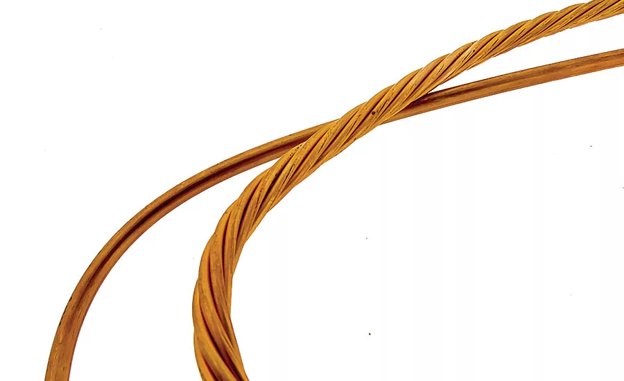

Stranded conductors (right) are more flexible than solid conductors (left). Both are bare, unplated copper. Photo courtesy Epec Engineered Technologies

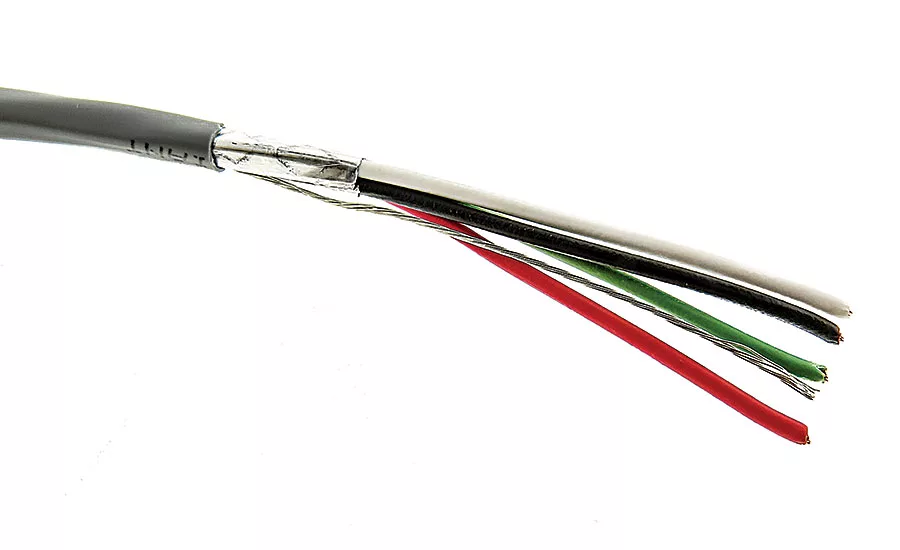

This cable consists of individual insulated conductors wrapped with a foil shield and enclosed by a polymer sheath. Photo courtesy Epec Engineered Technologies

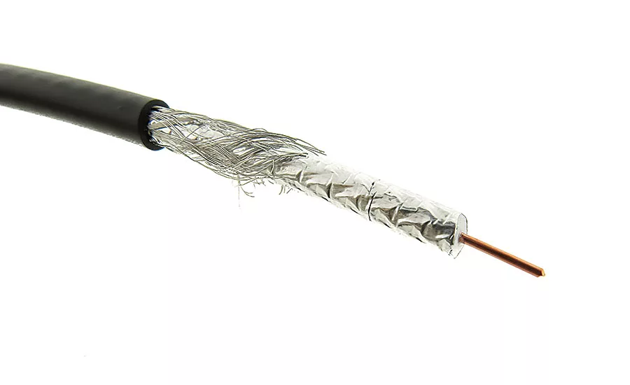

This cable has both foil and braided shields to control electromagnetic and radio frequency interference. Photo courtesy Epec Engineered Technologies

The conductors can consist of a single solid strand of conductive material, or they can be constructed of many thin strands. Stranded conductors were developed as a means of overcoming the rigidity of solid wires and come in many variations. For any given size conductor, the higher the number and the smaller the diameter of the strands, the more flexible the conductor.

To further control both electromagnetic and radio frequency interference, shields can be applied once the conductors are cabled together. There are several options for shields. Each has its advantages and disadvantages. One of the most popular shields is a metalized foil adhered to a polyester backing, known as a foil shield. The foil shield is the least expensive. It has fairly good flexibility, but not good flex life. It is good at higher frequencies, but it’s less effective at low frequencies.
Another option for a shield would be a braided shield. This type of shield is composed of many small-diameter wires that are braided onto the cable core using specialized equipment known as braiders. This type of shield is more expensive than a foil shield, but is more difficult to terminate. It offers better shielding at lower frequencies and provides for better flex life.
A different type of shield is a spiral shield, in which small diameter wires are wrapped around the cable core. This type of shield provides excellent flexibility with long flex life, but is poor at protecting at high frequencies and is difficult to terminate.
The best protection against interference comes from a combination of foil and braid shields. This combination provides excellent protection at all frequencies and is easy to terminate. However, it’s usually the most expensive option.
